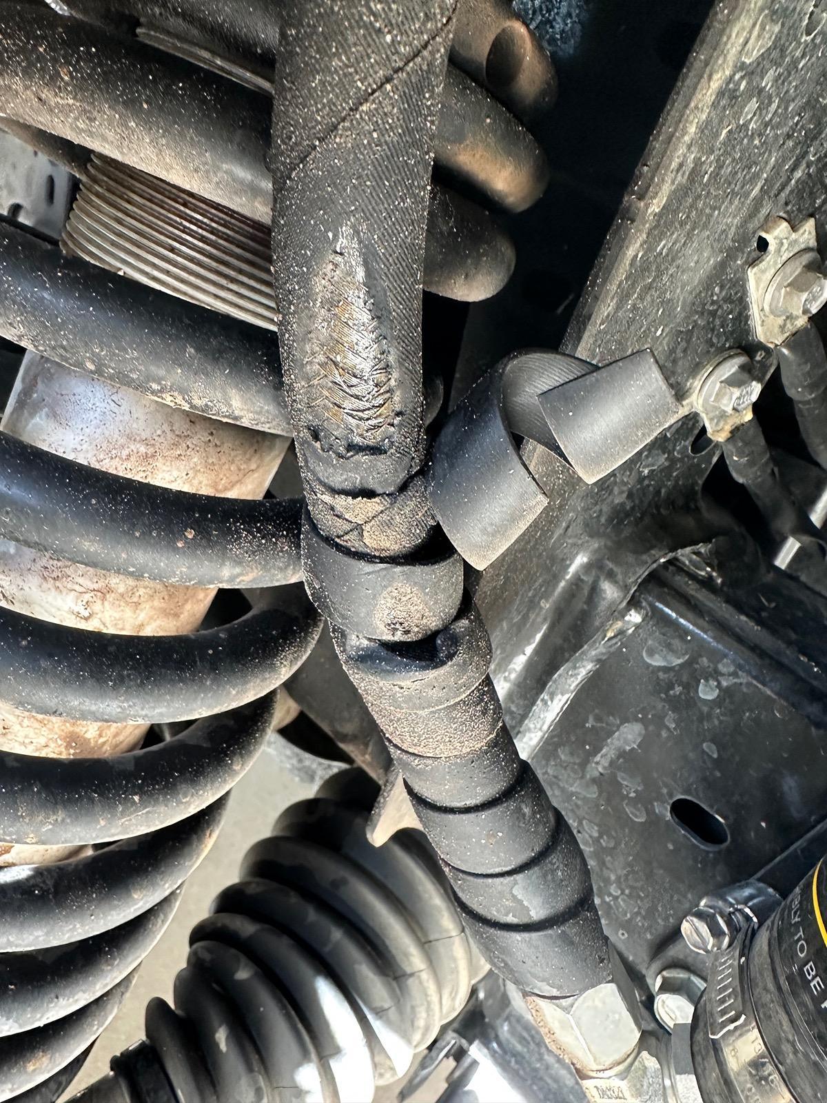

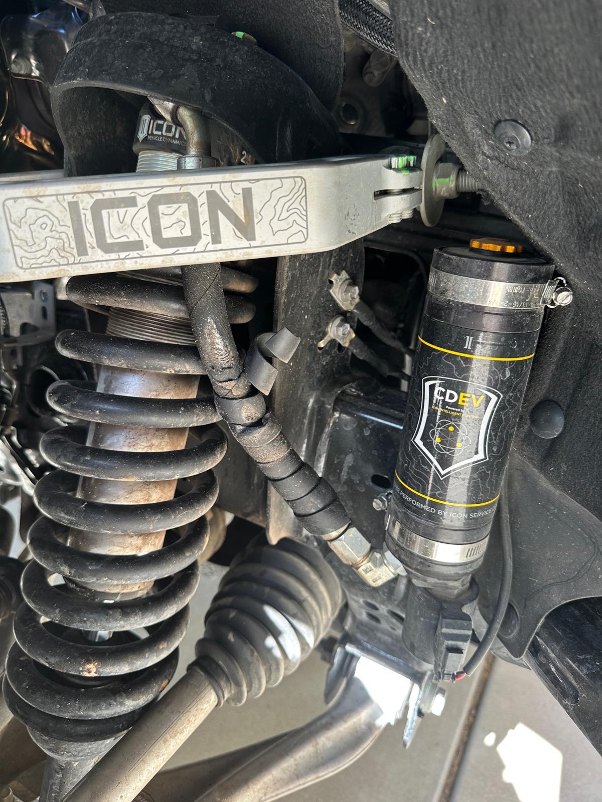

You got some great pics Scott. You may want to check the reservoir hoses on your Icons. I was checking through all of my painted torque markings the other day, and saw that my reservoir hose was rubbing on my upper control arm. It's worn all the way down to the braid. You've done enough of these already, that that issue probably would have come up if it was going to be an issue, but might be worth a look.
Hey Matt! Been there, done that. Not sure if you have an older kit, or newer. I had an older kit and the UCA cut through my resi lines, basically disabling my rondo on the first run last year. Luckily it was the last day. I called ICON, and they covered everything. I sent them back my fronts (on their dime), they replaced with longer hoses, refilled the oil and nitrogen, and sent them back in a week. You might get away with turning the reservoir a little, get some hose relief.
Hopefully Iā€™ll see you on another EXO run. The June run only has 10 Broncos, never went with so little, should be interesting.

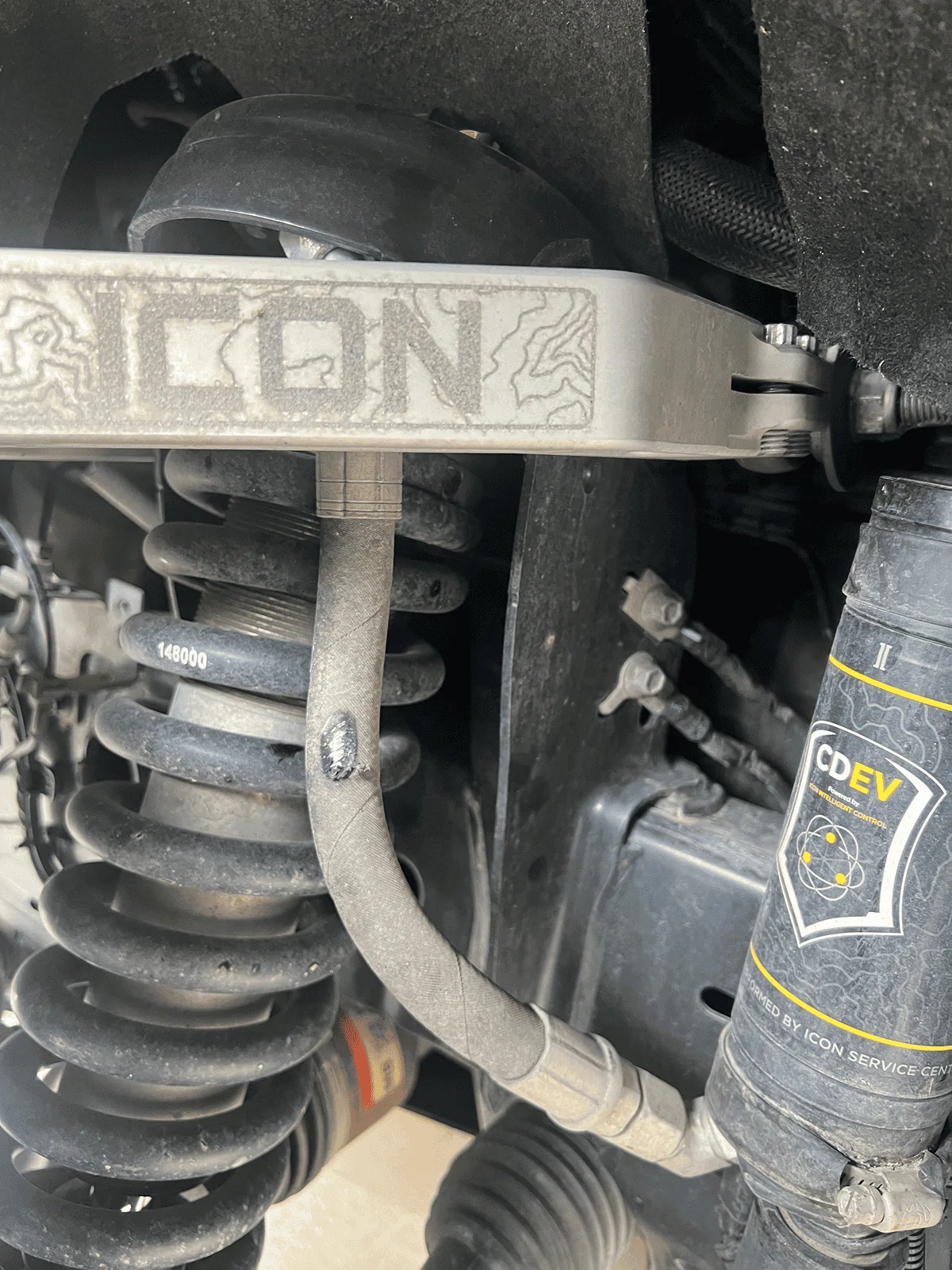

Found some old pics, fun times in BajašŸ˜‚ At least I was able to drive it home, it was riding on springs only with all the oil gone, but it made it!

Yikes! I have the newest kit, and they were supposed to have worked all of that stuff out. I got lucky, that it didn't bust all the way through. Looks like on mine it was installer error, they didn't clock the shock correctly, to where the hose fitting is closest to the body of the vehicle. Looks like my shop is going to take care of me, and handle everything.
