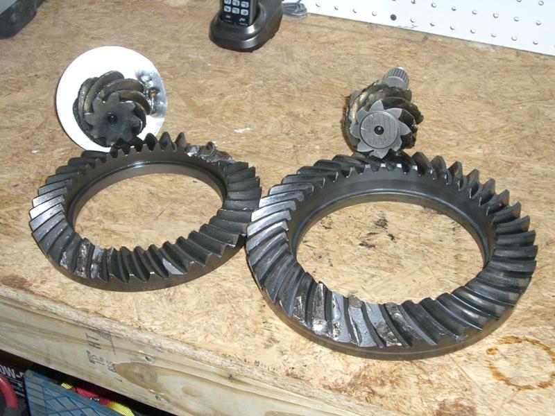

Yep, I'm going with ring and pinion....know that sound all too well.....
These are from my last truck (non Bronco), front and rear in one trip.
37's W/ D44 & D60. The rear was a reverse cut Dynatrac ProRock 60, so that didn't help matters any.
Fixed it with a shaved 14-bolt rear, D60 front and 40's :LOL:.
Heavy vehicle + 37's + D44 + rock crawling has never proven to be a great combo in my experiences.

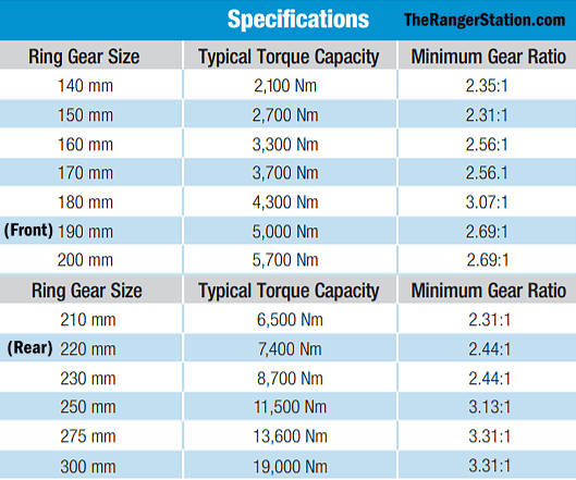

Dana publishes the data on torque load limits etc.
Ford Bronco Blown M190 on Hells Gate <-Video proof RFKNMY0
There are lots of loading scenarios for the front axles. Too many to possibly dissect, however one we are familiar with is a spinning front wheel (heavy skinny pedal) that suddenly grabs traction. This sends a torsional shock load down the axle and into the FDU.
The fdu is rated to various torque limits (see table). Regardless of the failure mode let’s assume this is an absolute value. The M210 can handle 6500/5000=1.3 times the torque of the M190 or 30% more.
a spinning wheel has rotational inertia as a function of the mass wrt the distance squared from the axis of rotation. Distance squared is a stronger variable than mass. So a 37” tire has approximately (37/33)^2=1.26 times the inertia of a 33” tire. Ignoring nuances in weight.
a spinning wheel that instantaneously grabs friction results in a torque on the axle that is proportional to the rotational inertia and angular deceleration required to stop the spinning wheel. Therefore a spinning 37” wheel requires roughly 26% more torque to stop than a 33” wheel given the same angular deceleration.
it is not known if the angular deceleration will be identical between the two wheels (37 or 33). Of course the faster the spinning the greater the deceleration when the tire grabs friction. All this is a function of the skinny pedal.
Nonetheless, focusing on what is a function of the tire. it is clear that for torsional loading from a spinning wheel that grabs friction, the tire diameter has a second power detrimental effect.
Inertial resistance is an inherent property of the tire size we choose, and diameter is more detrimental than mass wrt rotational inertia. Light 37 will likely be more detrimental than a heavy 35. But light 37 is still better than heavy 37.
