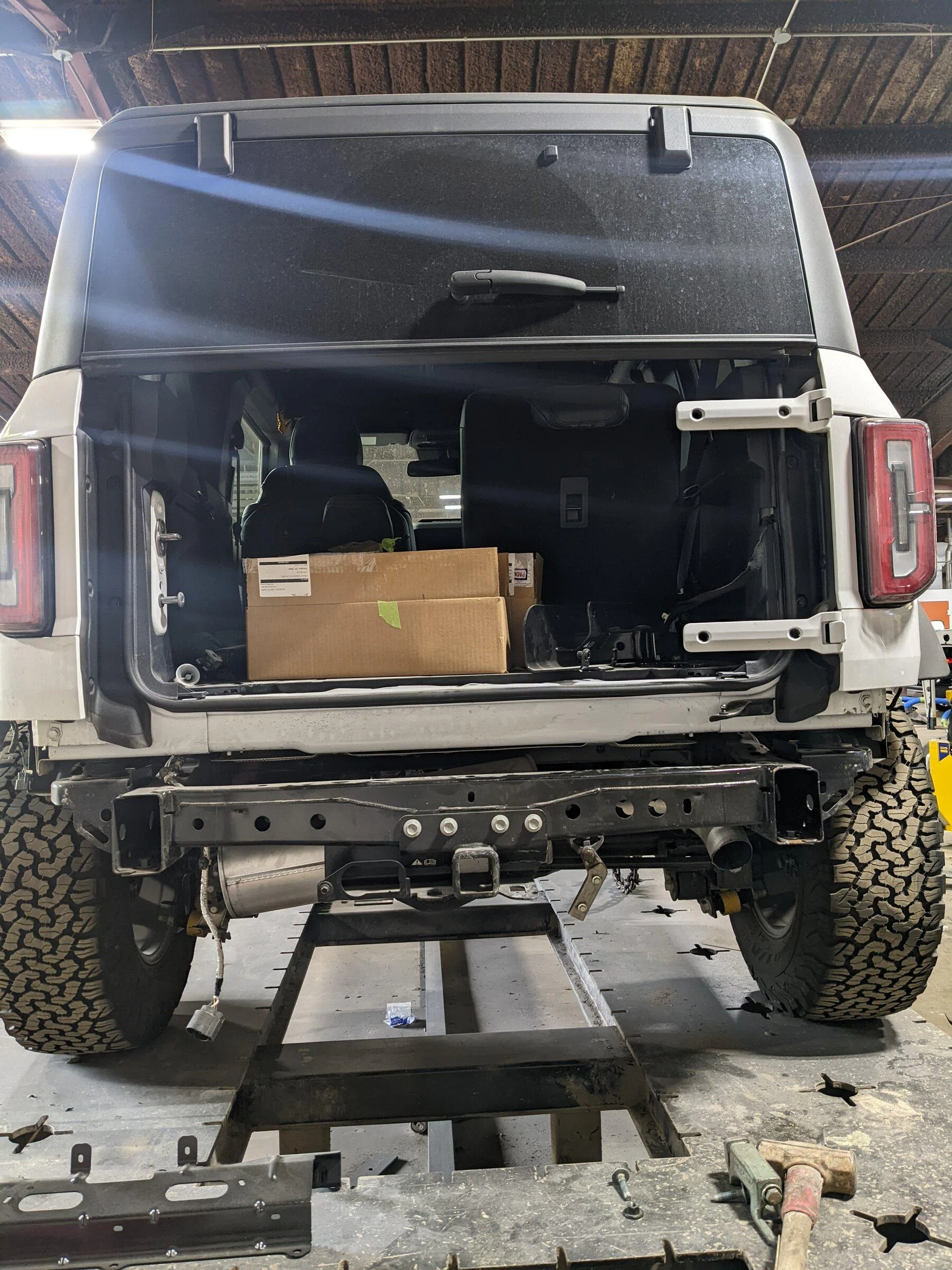

Is the last frame crossmember, where the trailer hitch bolts on welded or bolted to the frame rails? My new Bronco had a U Haul 5’x9’ Utility Trailer w/gate hooked to factory hitch hit hard by tailgater, moved hitch 5” forward and twisted it. I don’t want a cut and weld repair that KILLS resale value. A repair like that must be disclosed. How best to handle???

In this picture it's on the frame rack. They use hydraulics to pull the frame back into place. Take it to a quality body shop. Yes, that cross member is where the hitch receiver is bolted on.
I took it to a quality body man with a frame machine. He verified that the rear frame is distorted from the
stresses transferred through the factory trailer receiver, and informed me that his information relative to the new Bronco is that the frame material has increased levels of boron and conventional frame straightening is NOT RECOMMENDED, frame replacement is recommended. I dont want a frame replacement, it will take forever and kill the value of my Bronco. Any ideas??
