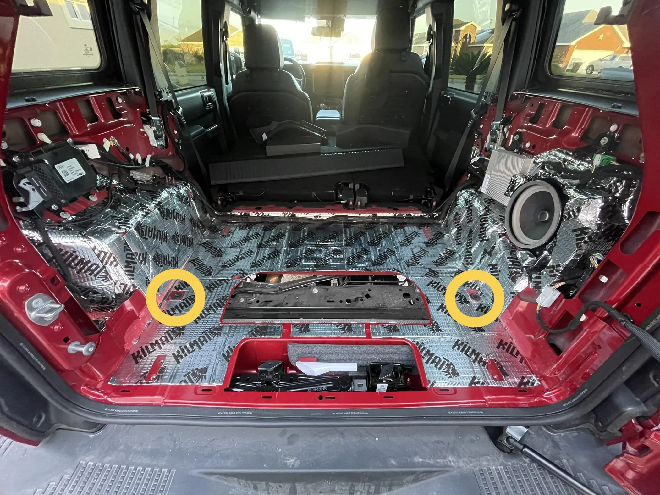

Grommets through the cargo floor are here.
I would run it like an amp. Down the wire channel under the door sills and out the grommet through the drivers firewall.
Those grommets end up being under the rear cargo area floor mat/cover and not the side panels. They don’t make sense for this install. You wouldn’t be able to efficiently run wires through that badly placed and tiny grommet without having issues when reinstalling the cargo floor. Would be a big bump… lopsided.
I’m looking to install amps in the little cargo space using the DV8 replacement for more room. Looks like I will have to make a new hole somewhere near the underside of the back seats. Not sure yet, still exploring ideas. I can add the new hole and grommet or I can buy the trail deck system and probably just run the wires on the cargo floor from the trim behind the back seats to the cargo tray where 2 amps will be.

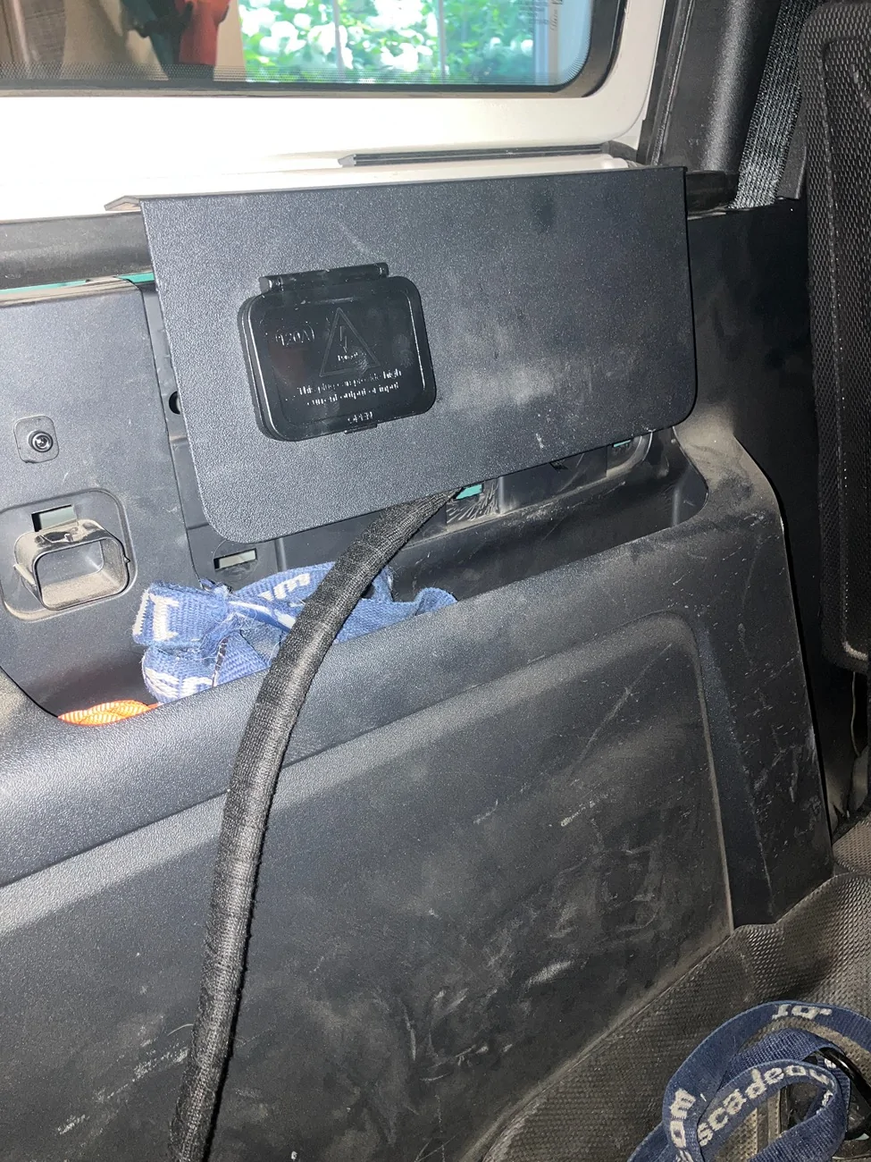

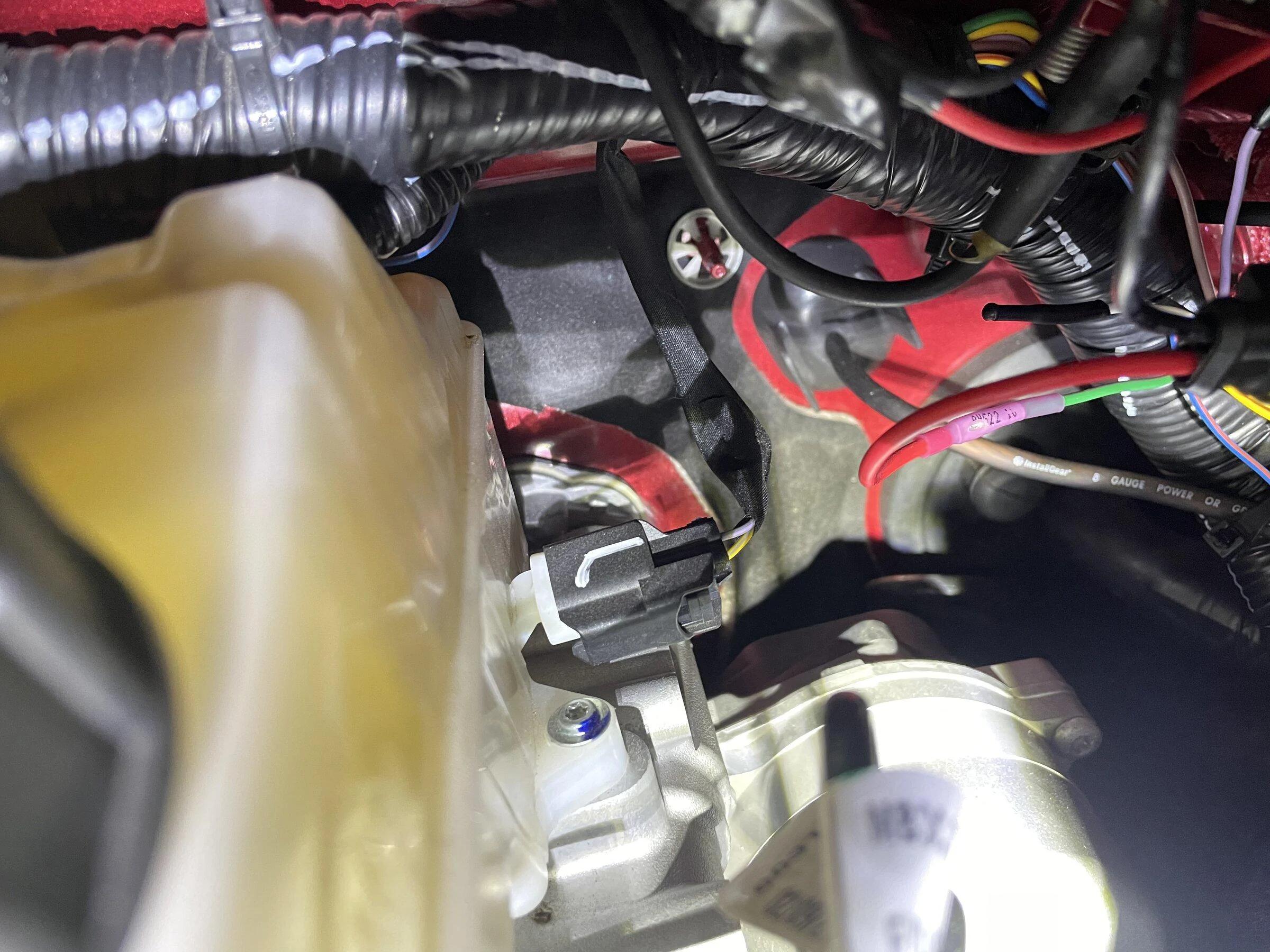

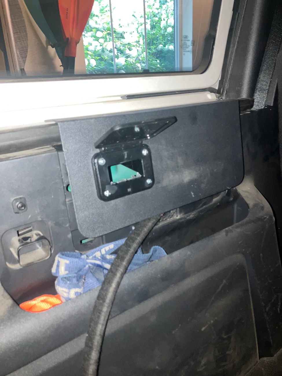

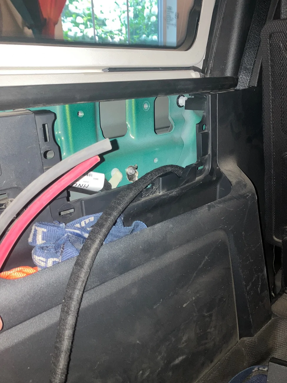

This weekend I finally got started on a similar project.
1. I am running 4ga wire from the grommet in the engine firewall on the driver side down the driver side in the channel at the doorsill. Both the positive and negative lines fit there.
2. I will attach a link for the connectors i am using to plug my All Top compressor into
3. I will mount it to a shelf in the back on the driver’s side window
4. I will be able to plug and unplug the compressor for when i dont want it in the bronco
5. I am going to use a circuit breaker from the battery to a solenoid. (I cut all power to the solenoid when I am not offroading.)
6. I am undecided if i want to put the switch to engage the solenoid up by the driver or have it next to the compressor.
I’ve attached a few pictures of what I’ve got done so far and will send more when complete in another week or two.
Malictele Anderson... https://www.amazon.com/dp/B0DX67MWZR?ref=ppx_pop_mob_ap_share
