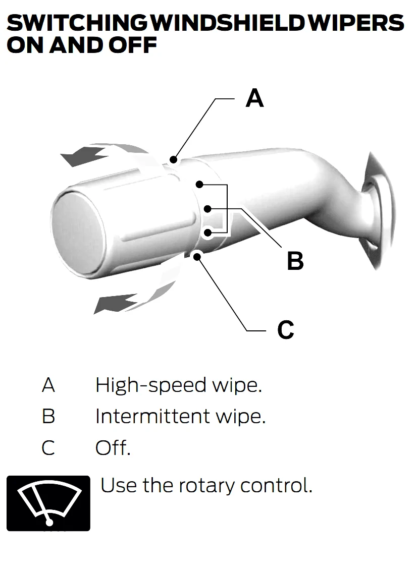

Only one high setting -
Ford Bronco Wiper control speed issues URGENT SAFETY 1645402544199
WCS67
Bill
Jul 29, 2020
129
171
MO
Escape
That diagram is not exact to the vehicle. There are 2 high speed settings. The first is the normal, continuous sweep(fast). The second is the super fast setting. Every vehicle has these same 2 ”fast” settings. Those of us that are having issues are having them with the first “fast” setting. Go play with your wipers to see what I’m talking about.
This is not the Bronco wiper control.
There are two continuous settings and three intermittent settings. The wipers are switching to intermittent all by themselves when the switch is set to continuous. Read the fucking posts.

So at least according to an info request to Ford, the wipers are speed dependent in the auto positions.
The first four settings are the auto modes and are variable speeds dictated by the actual speed of the vehicle. You have four levels of wiper “aggression” so to speak. 1 being the mildest and 4 being the most aggressive.
The constant speeds are low and high and are the last two modes. If this issue is occurring in the low or high mode then there is a severe issue.
I’m guessing they’re in the auto (intermittent) modes but what I am unsure of is if the issue is irregardless of the speed changing which would be opposite of designed intent. Any additional info you can pass along will be great.
