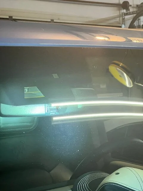

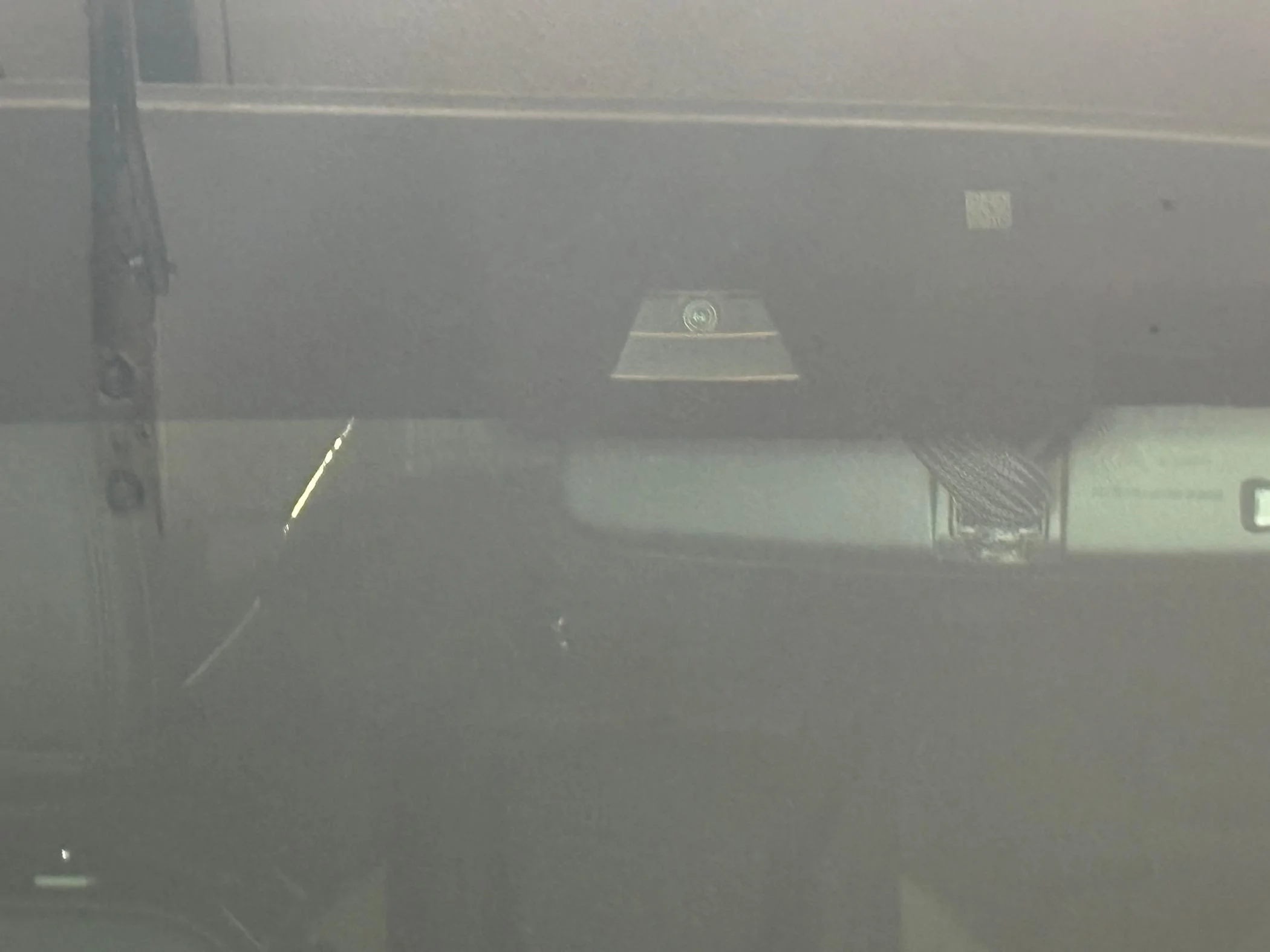

I'm parking my Bronco in the garage today, and I get a warning. (The front sensor is blocked. See owner manual)
Questions:
1) Can you calibrate all the gismos in the windshield without the ignition key?

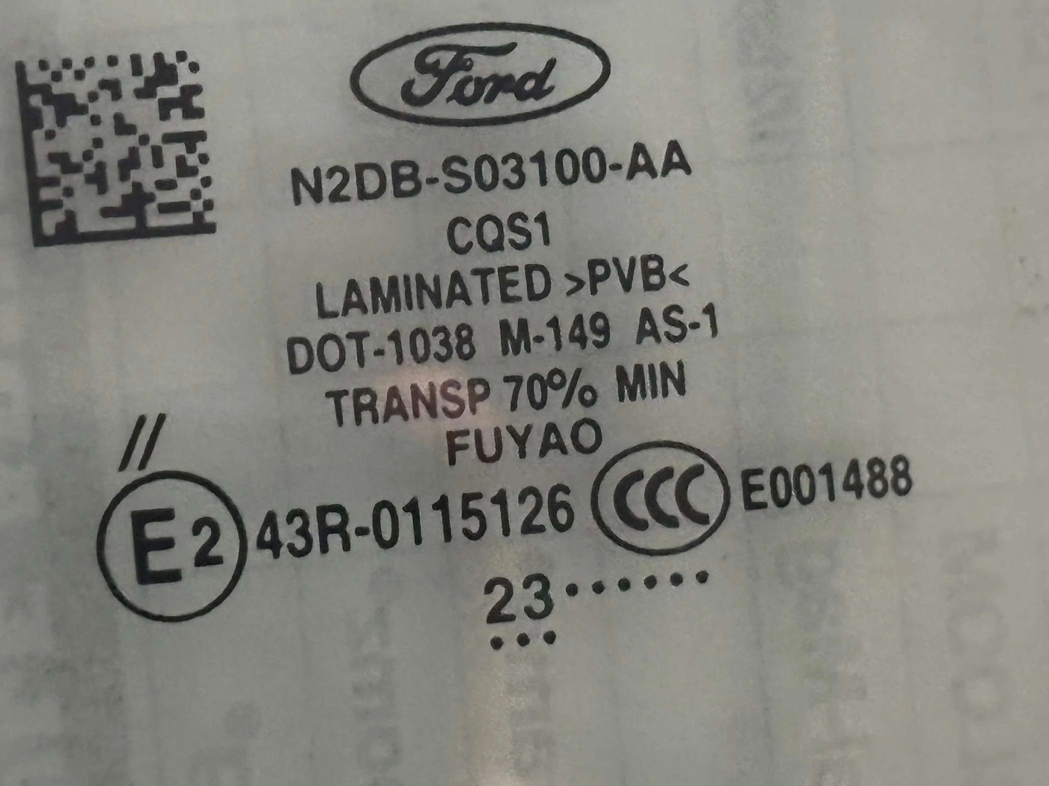

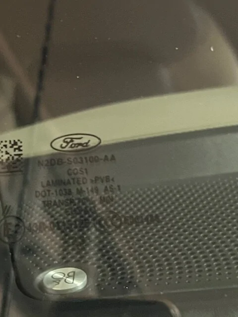

2) Is there a part number on the new windshield I can check to see if this is indeed the correct one?

My non-Factory glass is still made by Fuyao - it just doesn't say Accessory Ready on it. That and the word Bronco are really the only difference I can tell.
All the Broncos use the same windshield and have the camera in the same spot, from Base through Lux through Raptor - so apart from getting a defective windshield (where they didn't keep the area over the camera clear), I can't imagine a way to get the "wrong" windshield installed.

If it fits doesn’t mean it will work with the forward facing camera mounted on the top center of the windshield. Some aftermarket (cheap) glass doesn’t have that correct contours and will cause the camera to look upward, downward, or to one side. The camera can’t be calibrated in that case. I’ve seen that several times working in a Ford dealership service department.

Interesting on the glass branding. My 2021 OBX came with Carlite branded glass (a. Company formerly owned by Ford but court ordered to divest 15 yrs ago). The 1st windshield replacement was an OEM Carlite branded windshield and the 2nd replacement was non OEM that is branded by FUYAO, but lacks the Bronco and Accessory Ready branding on the glass. I’ve taken a couple of good rock hits with the FUYAO glass without so much as a mark and it seems to have held up better than the Carlite glass. The FUYAO glass was $100 cheaper than Carlite as well. Ford is also not branded in the right corner that identifies the mfg.
