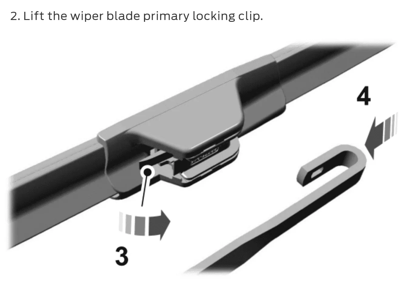

Another thing I just noticed in the Owners manual for the wipers... The wiper instructions are wrong, the manual says the Bronco has J hooks, I have the pinch clip style. Did they change it or just make a mistake:

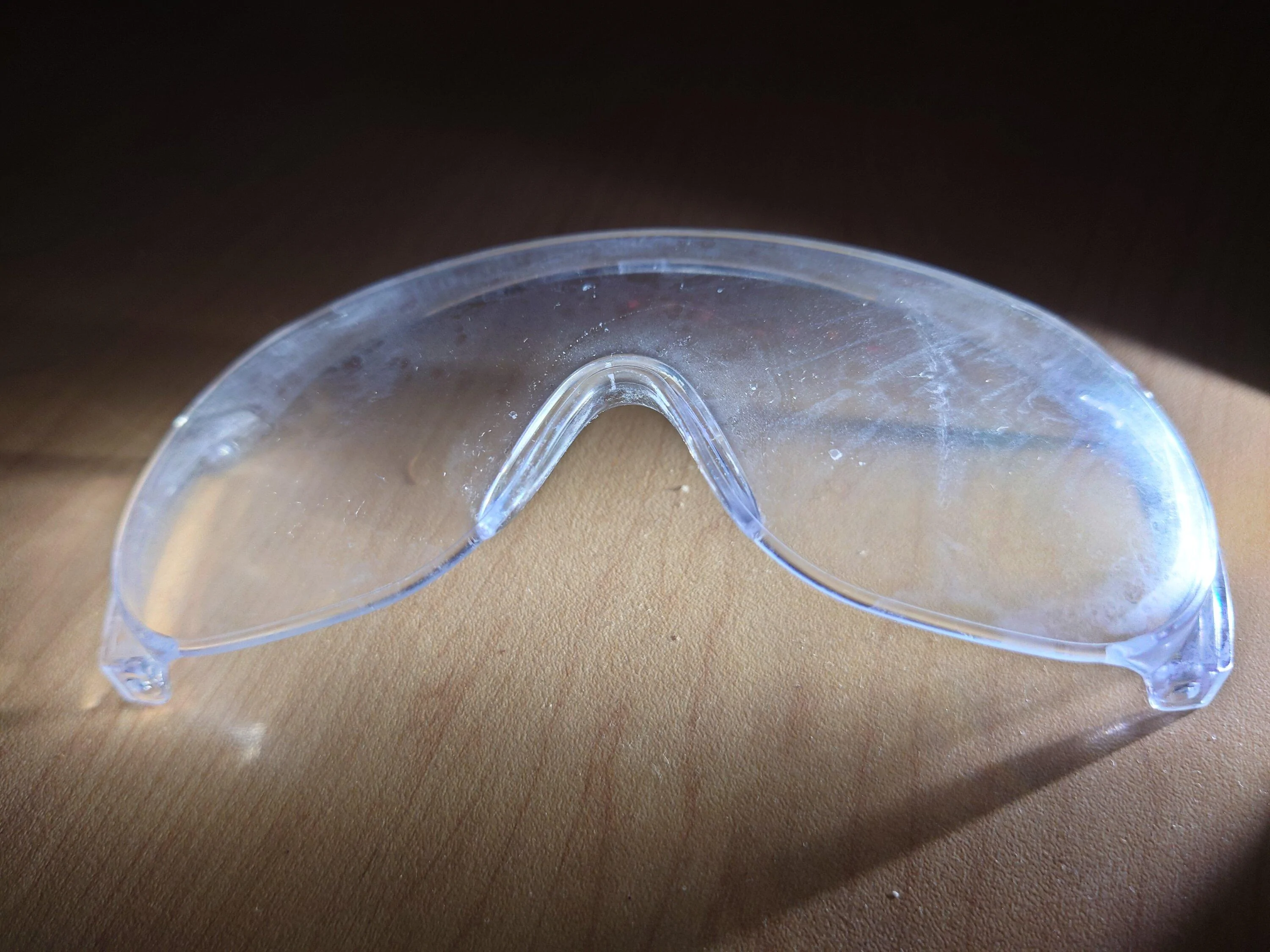

So I got this Dupont spray (Pictured Below) and I do not advise using it on the Headlights, I tested it on some safety glasses (The same Polycarbonate that headlights are made of now) and I am glad I did. It definitely clouds up the clear plastic more than desirable. I may still use it on the radar but I am not decided. See below for the residue on the safety glasses after I tried removing the coating with many cleaning products. Better a $3 pair of glasses than $XXX headlights. I'd suggest the same for others looking to coat their headlights, test on Polycarbonate plastic, safety glasses or something similar first.

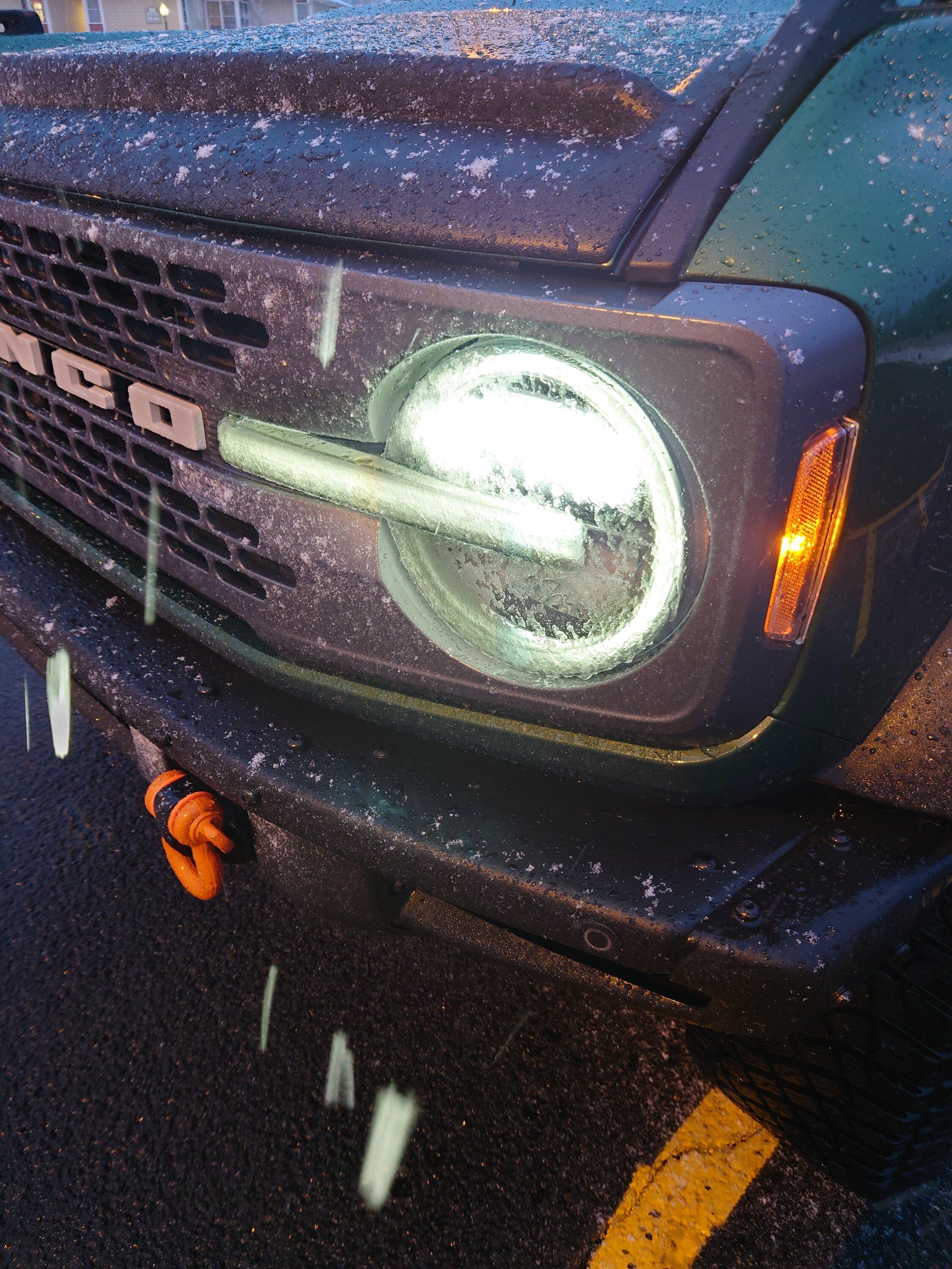

Also, see below. I took a picture of my lights starting to ice up when it was flurrying. This little amount of ice reduced the output more than you'd think. ~20ish%. I'm going to try rain-x on the headlights and see what that does.

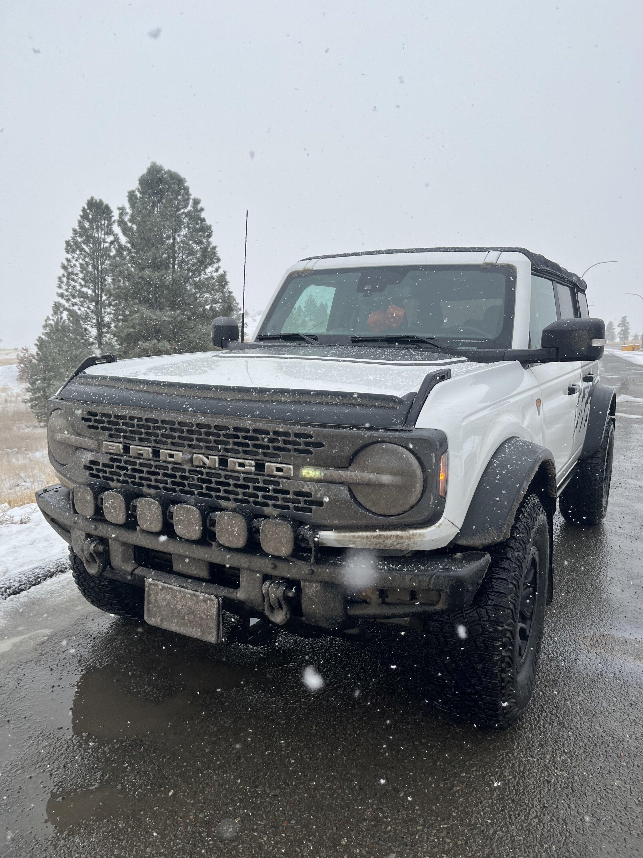

We don’t get a ton of snow where I am, but driving through the mountain passes late last year my headlights iced over really bad. You can see from my picture below - light bar, license plate, etc. Couldn’t even wipe them clean, as they were frozen solid with a thick layer of ice.
I love LED headlights but I wish automotive manufacturers would solve this issue. Whether it be similar to a mirror defroster or just directing warm engine air into them - There must be a way.
