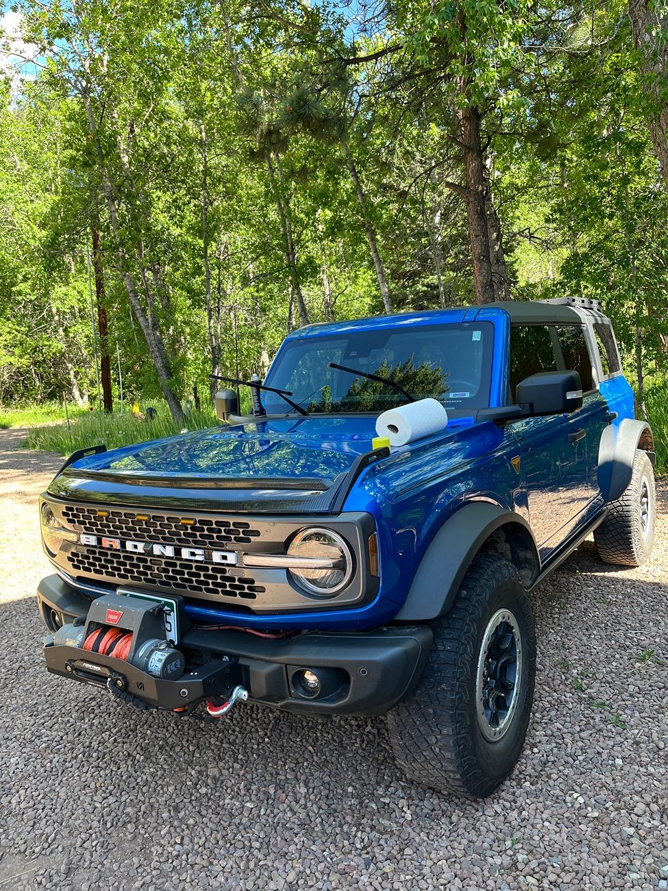

I have the Turn Offroad winch plate on my capable bumper. Install is pretty straight forward. (I also installed one on a friends Bronco.) I does not block the letters and I did not relocate the camera. It blocks the camera just a small amount but not enough that I want to relocate the camera. It does (as do most plates and bumpers) require the relocation of the ACC sensor and extending 2 parking sensor wires. You should be able to mount a bull bar on the mod bumper.
Overall I'm very happy with it.

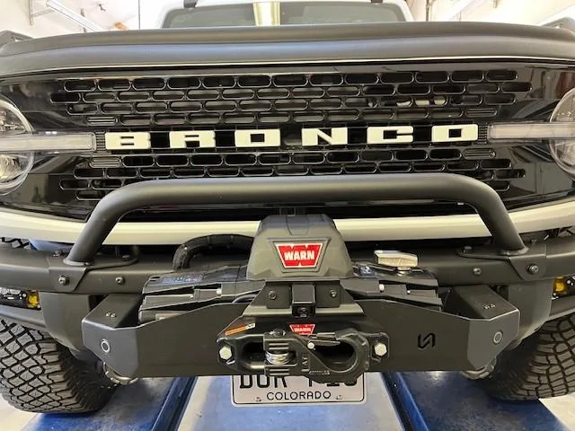

I used the Turn bracket because it is in line with the frame horns like the Ford (not raised up which presumably is an increased bending moment upon severe use. Used their ACC and camera relocation kits and Addictive Desert Design frame horn reinforcements with a well-priced E-bay 12K Warn EVO-S.
Primary reason I went this way was price relative to Ford/Warn--total package was quite a bit less. Second reason is it seemed Ford ONLY wants their package to be dealer installed with reprogramming--I could not find any installation instructions. Third reason was the Ford warning about ACC and collision avoidance systems which the Turn ACC relocation and some other packages overcome. A raised bracket like the JCR overcomes the ACC issue and some kits such as Buttercup have extensions for sensor relocation.
Without going into a lot of detail about the quality and related issues of the Turn bracket and their customer support, along with the poor fitment of the ADD reinforcements--I STRONGLY wish I would have ponied up to the Ford/Warn package and either lived with the warning about ACC and sensors or researched other aftermarket ACC/camera relocations. One price adder on the Ford/Warn package is it includes a "Made in USA premier" 8K Warn winch vs. the EVO which I believe is Chinese. And I believe Ford has now reduced their package list price.
The Turn instructions have the installer butcher the ACC and sensor wiring harnesses. I had to re-machine the sensor mounting area on the Turn bracket due to a design oversight, repaint the area and fab a bezel for the sensors. I am sure if I have any ACC or sensor issues Ford will say "that's too bad" with both my standard or extended warranties.
I now question my logic to become price conscious for a collection of sub-standard bits that are so important for a safe recovery--especially when considering the price paid for a Wildtrak Lux which I intend to keep for my remaining years. What was I thinking?

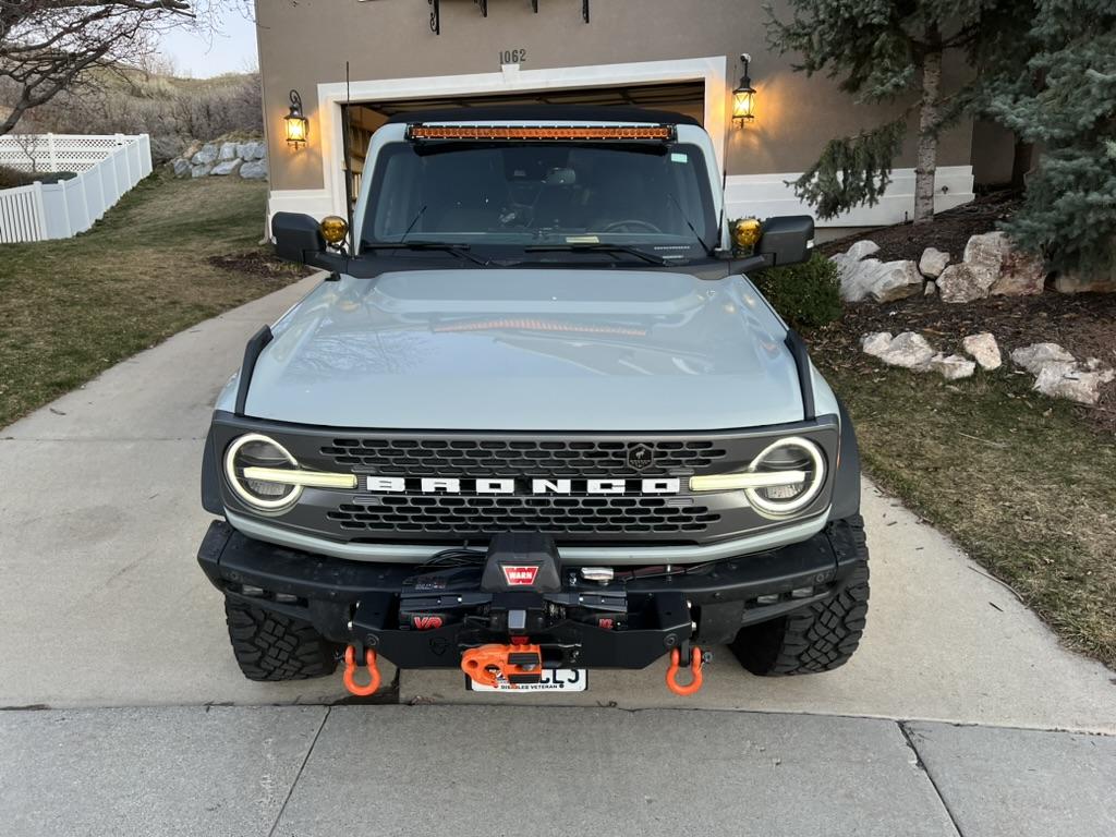

I have the RC mount with a Warn EVO 10S winch on factory Mod bumper, with factory bull-bar (it doesn't protect the winch, just there to protect the grille if a deer is hit). I've used this setup a number of times without issues on Level 7/8 wheeling trips and similar circumstances. Pros - so far holding up, strength-wise; excellent approach angle; retains factory ACC and proximity sensor operation; does not block Bronco lettering (addition of a winch control box extension kit from Warn); compatible with factory bull-bar. Cons - requirement of a JCR (or similar) camera relocation kit, installed on the winch fairlead.
Photos below with/without bull-bar. Yankum farilead. RCI skid plate beneath Mod bumper.

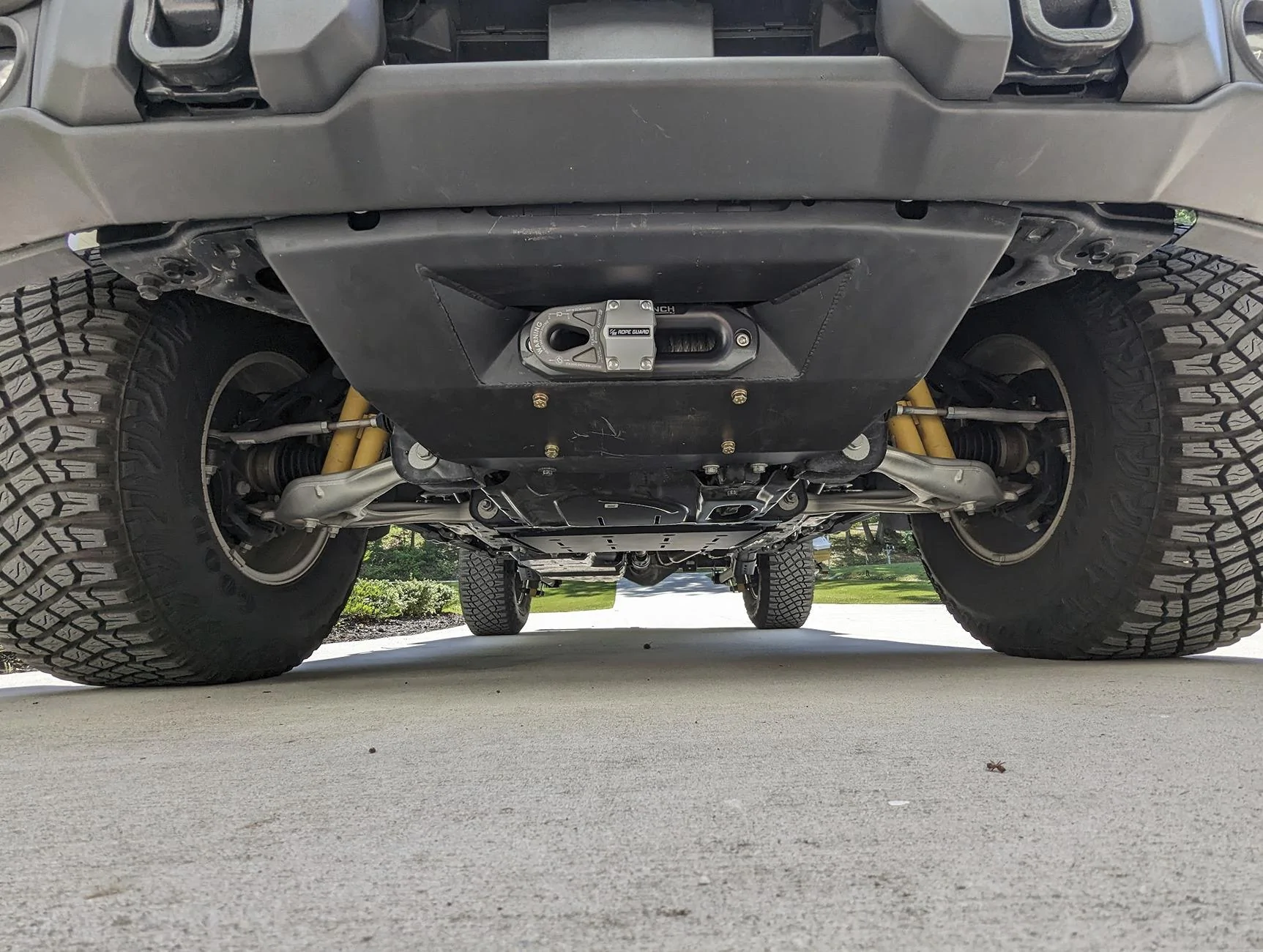

Another option to keep in mind would be the Lobo Offroad (or Rough Country version) HNT hidden winch skid. Keeps everything tucked nicely out of the way.
https://lobooffroad.com/product/lobo-hnt-hidden-winch-skid-plate-bronco/
Ford Bronco Winch mount recommendations for mod bumper with LUX package 1719759986662-n
I considered that approach as well and then figured that in situations where I'm in need of a winch for myself, it's highly likely that location is submerged. I also reminded myself that after a number of trail rides, the amount of mud I've cleaned from the backside of my bumper would also be caked in that housing compartment - which is less than ideal for the longevity of the winch.
It's definitely a clean looking setup though.
