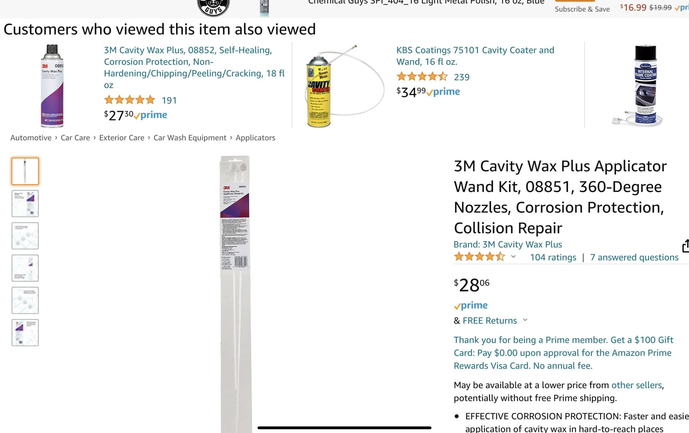

I’ll be doing some extra corrosion protection on my Bronco but it won’t involve line x. I also wash it a few times a week and make sure that includes the undercarriage during the winter Luckily I only have one more winter in MN as we will soon be empty nesters and spending 7 months each year in Florida. I’lll be taking my Bronco with me. :)
My extra protection will involve some undercoating and this 3M Cavity Wax Plus inside many other panels, frame rails, and other hard to reach areas.
