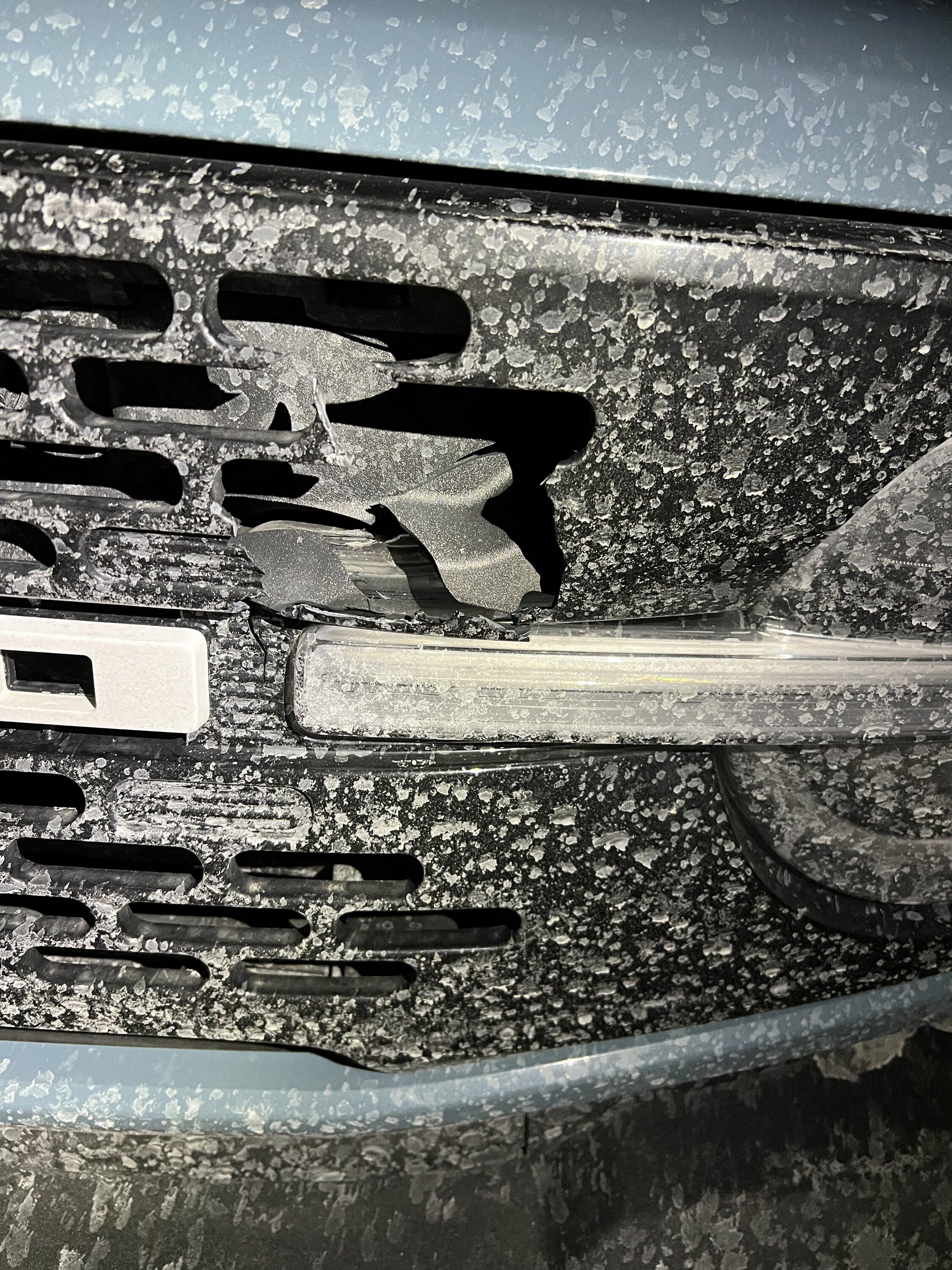

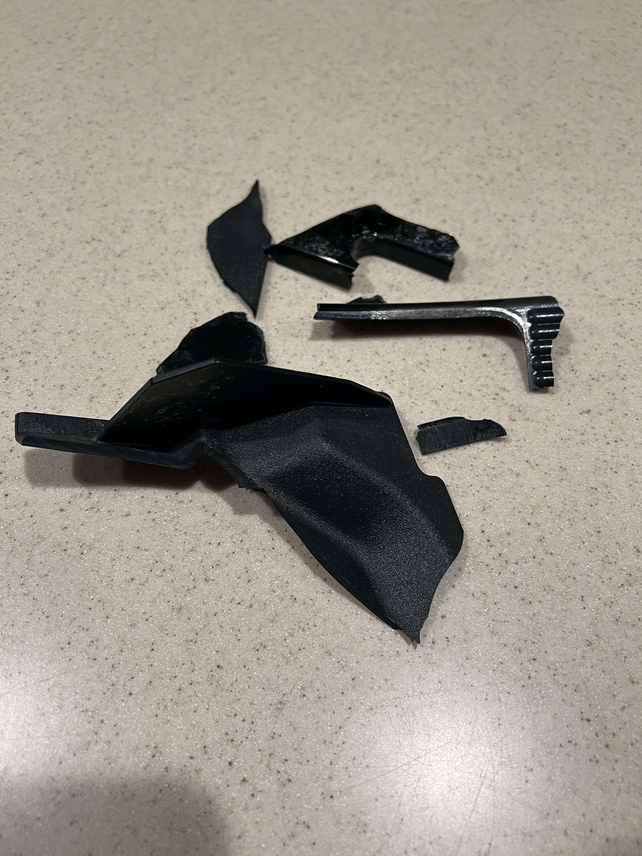

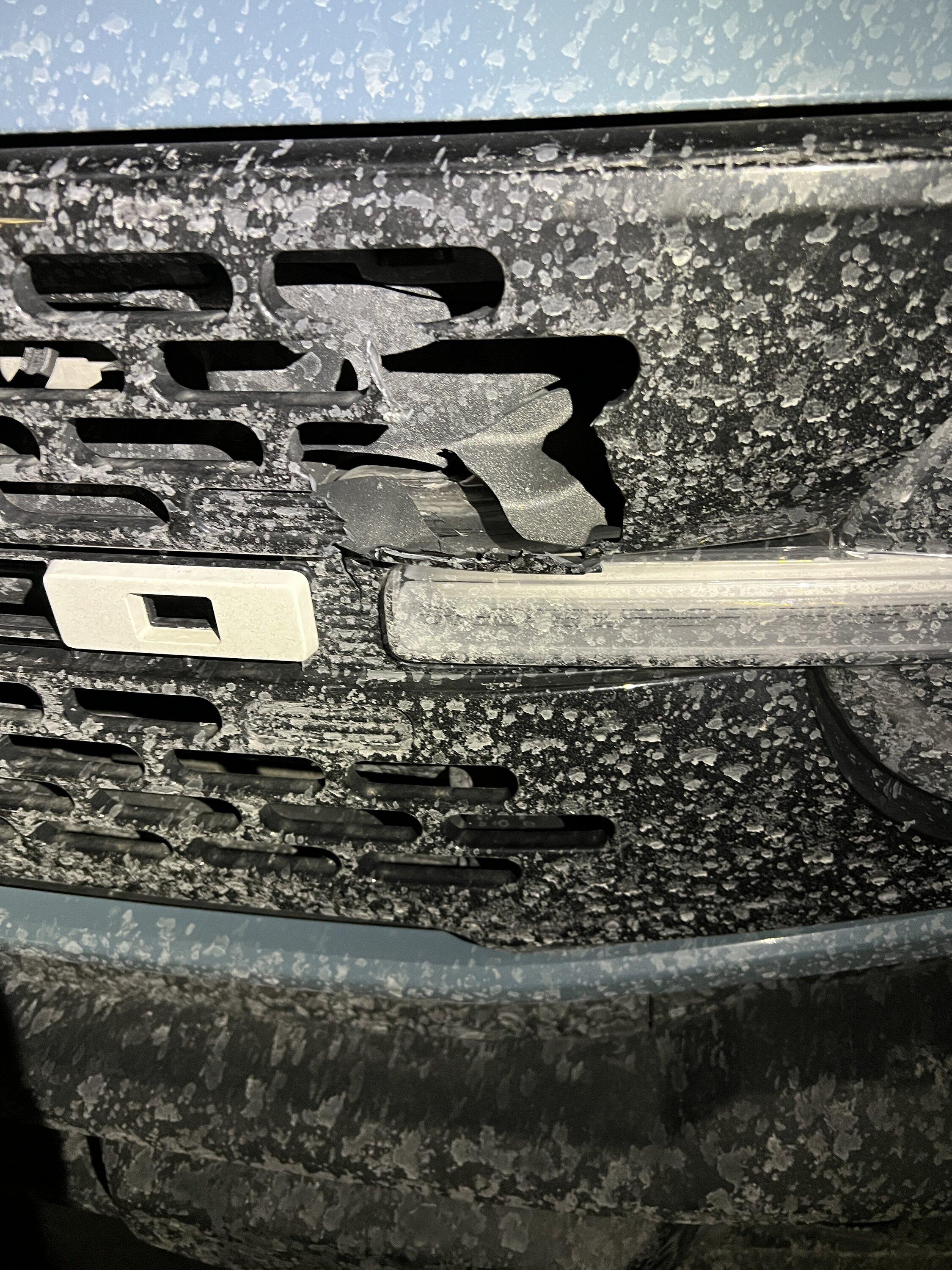

Well tonight sucked. Took a baseball size rock through the grille and the backing trim on the highway tonight.
has anyone replaced a Wildtrak grille and the trim behind it yet?
Any ideas on the cost for the parts and how easy it is to DIY?
