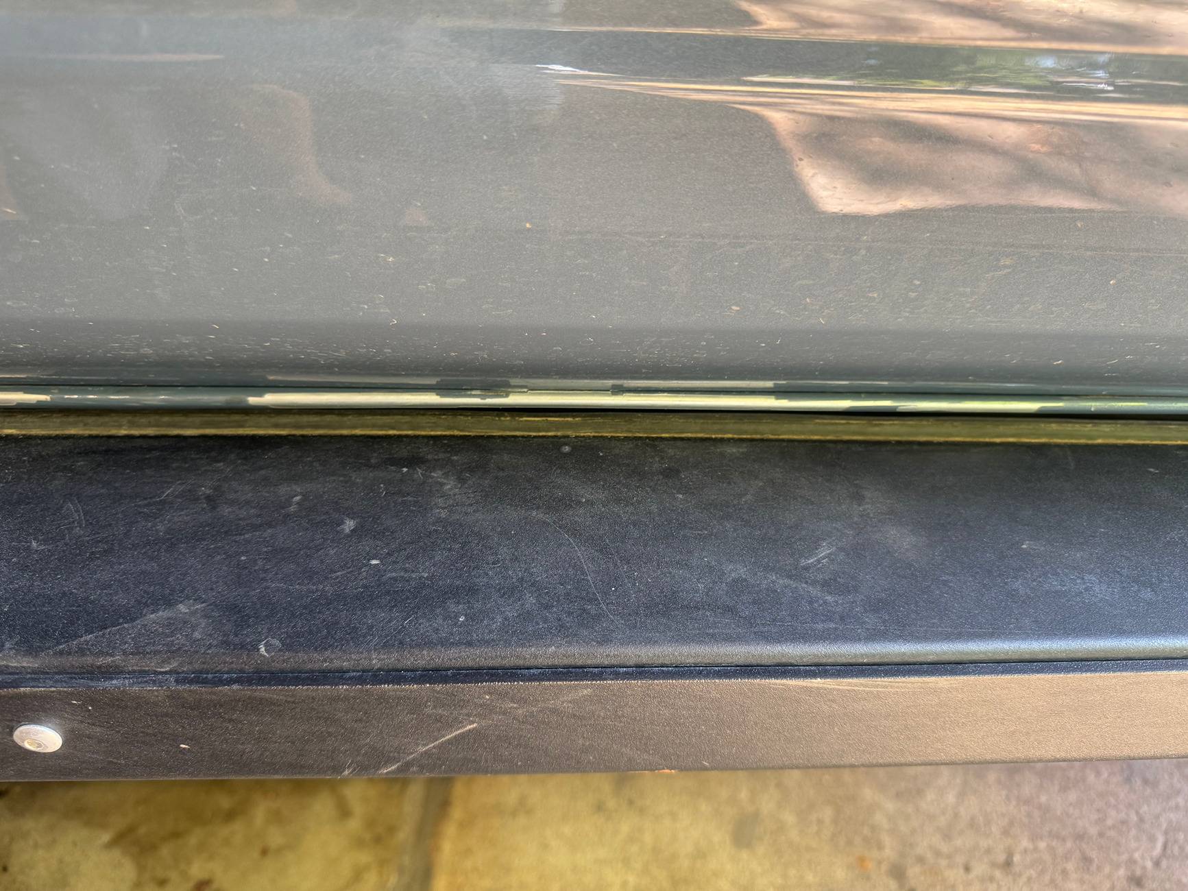

If you smack your RSE steps hard enough they will push the body up into the door.
The metal below the door was pushed up and you can see where the paint is being chipped off by the door.
They are NOT going to protect your rig like frame mounted rock sliders.
I drive like an asshole though so your results may vary.
