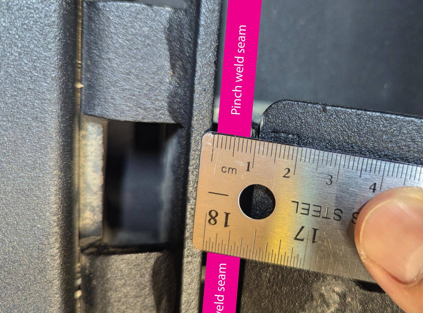

@KillerPenz and @2door seems like both of you are right people to ask. Do you think that the DV8 pinch weld covers are compatible with Go Rhinos? They will share the same mounting locations and since they are only a 3.5mm Steel Plate, I was wondering what you thought. Will the hardware provide with the Go Rhinos be long enough to hold both?

The GoRhino mounting brackets hug the pinch weld seam. The opening in the bracket is about 10 mm wide. I can't measure the thickness of the pinch weld seams because on my Bronco they are covered by the rock sliders, so you're going to need to do the math yourself.
This image shows the GoRhino bracket in reference to the pinch weld seam. Hope this helps.

Thank you for taking the time. Seems doable so I’m going to give it a go. I have my Go Rhinos on the way. Will report back
