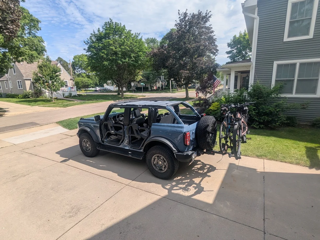

We use a 1UP RACK for,2 electric bikes. Love the rack, super solid and well-engineered, but also can’t open the tailgate with it on.

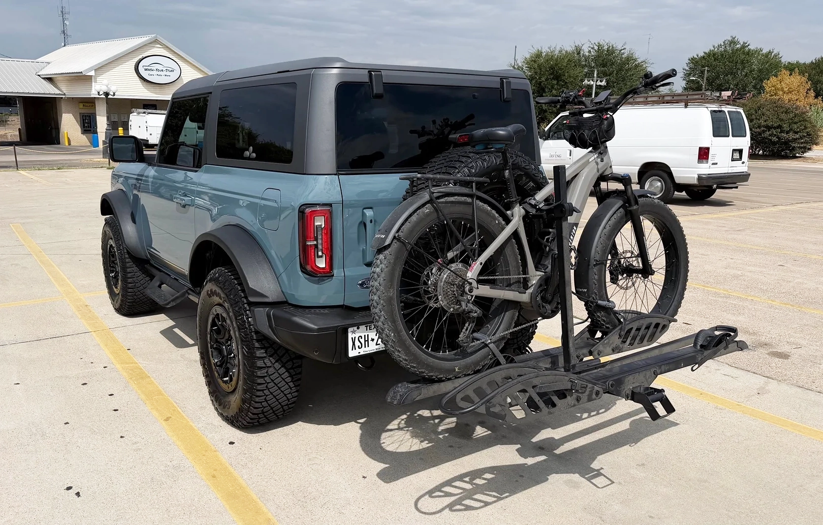

+1 for the Kuat, and their swing away hitch mount. I have two full powered electric mountain bikes on mine and they’re rock solid

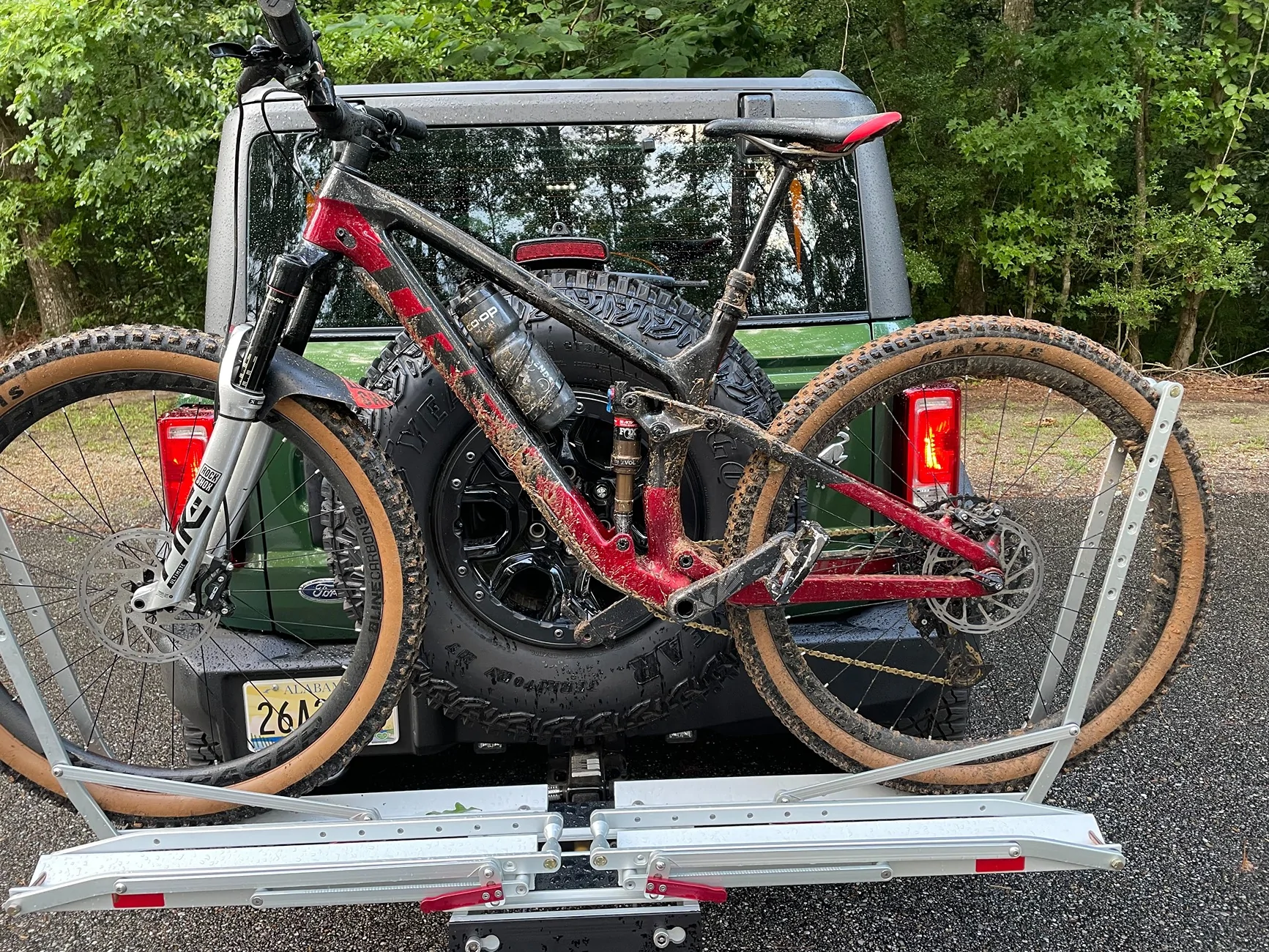

I use a 1-Up with extended hitch. I can tilt the bike rack down (with no bikes on) and open the tailgate. It's close but it works.
