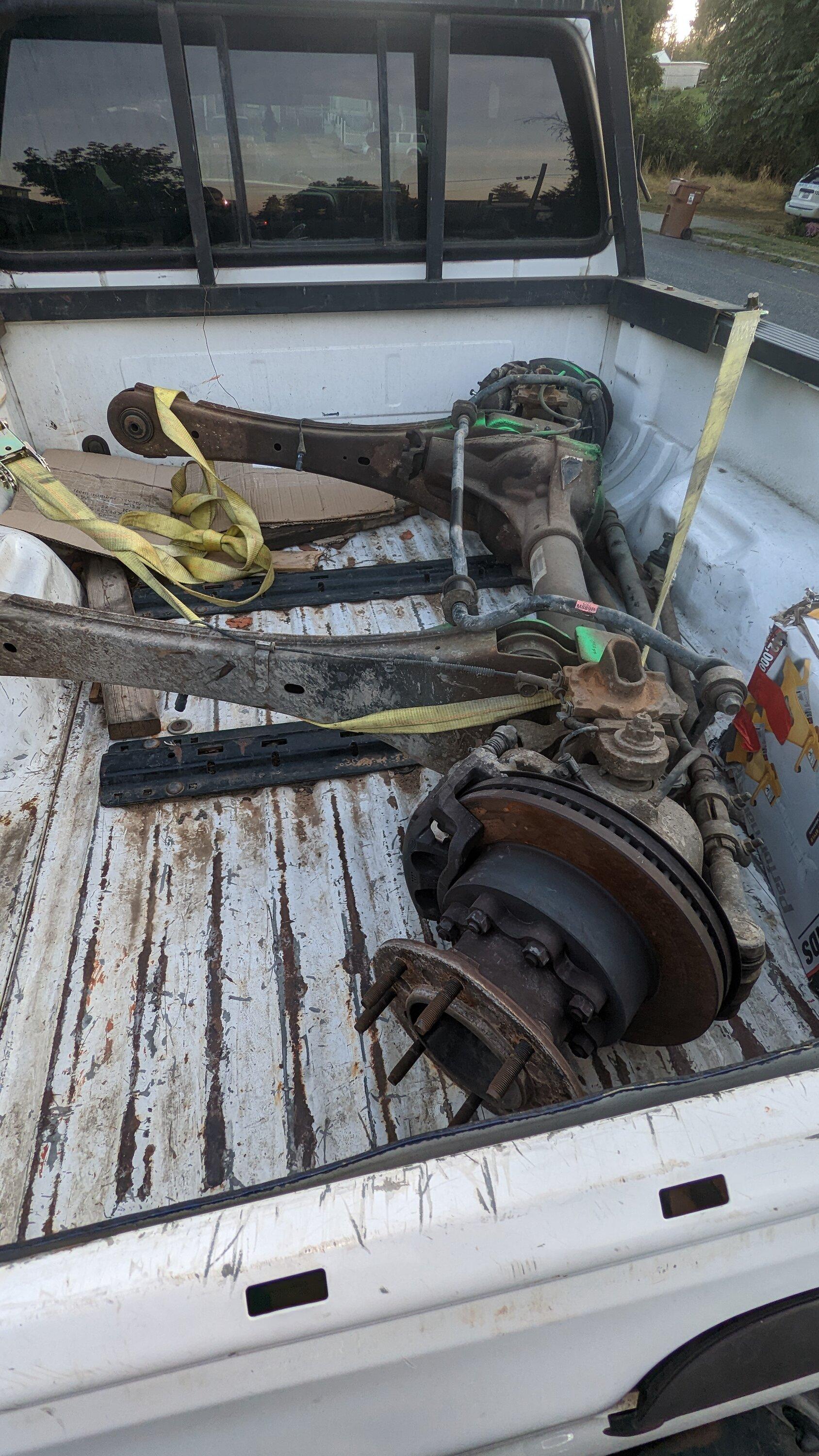

I think I want to do a 14 bolt in the rear. I thought about just keeping it a matching 10.5 but my front is a 4.10 and it doesn't appear the 4.10 rear was available with an e-locker so that takes some shine off. I'm not looking to regear because with the doubler I think I'll have enough. I'll need to shave it though.

While that would be cool, I need tons to keep me moving past where my 6G stops. And I kind of bought my front 60 already.

I think you need to weld the spider gears, don't waste money at this stage on a locker if you are not going to regear. I would go with what ever rear pops up with disc brakes (you want big brakes for the doubler).
You are going to be fighting the width issue on trail, so I would blow money on steering. Full Hydro!

I'll put a lunchbox in front to help with steering but welding the rear sounds fine. The dually adapters are coming off so it won't be any wider than anyone else on tons. I was only planning on hydro assist.
