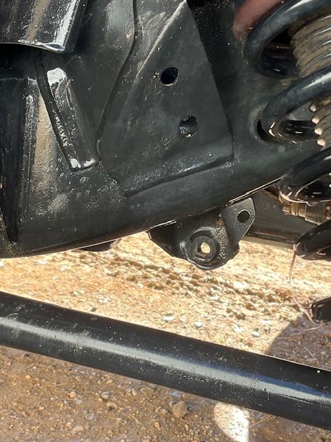

While doing my least favorite Bronco chore, removing wheels to clean out mud from wheels and suspension. I noticed these empty brackets just inboard and above the rear trailing arms. I’m assuming they are for a component my non sas BD does not have so just curious if anyone knows what would be attached to them.

Rear sway bar end links. You’ll find similarly unused brackets on the rear axle which mount the rear sway bar bushings.
That’s what I was thinking but wasn’t sure. At least I’m not missing anything I would want lol

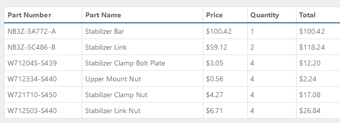

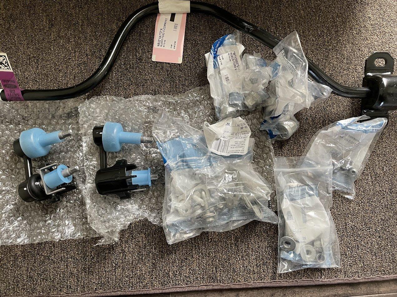

I added RSB on my Badlands and it made some noticeable difference.

Do you have a parts list?
