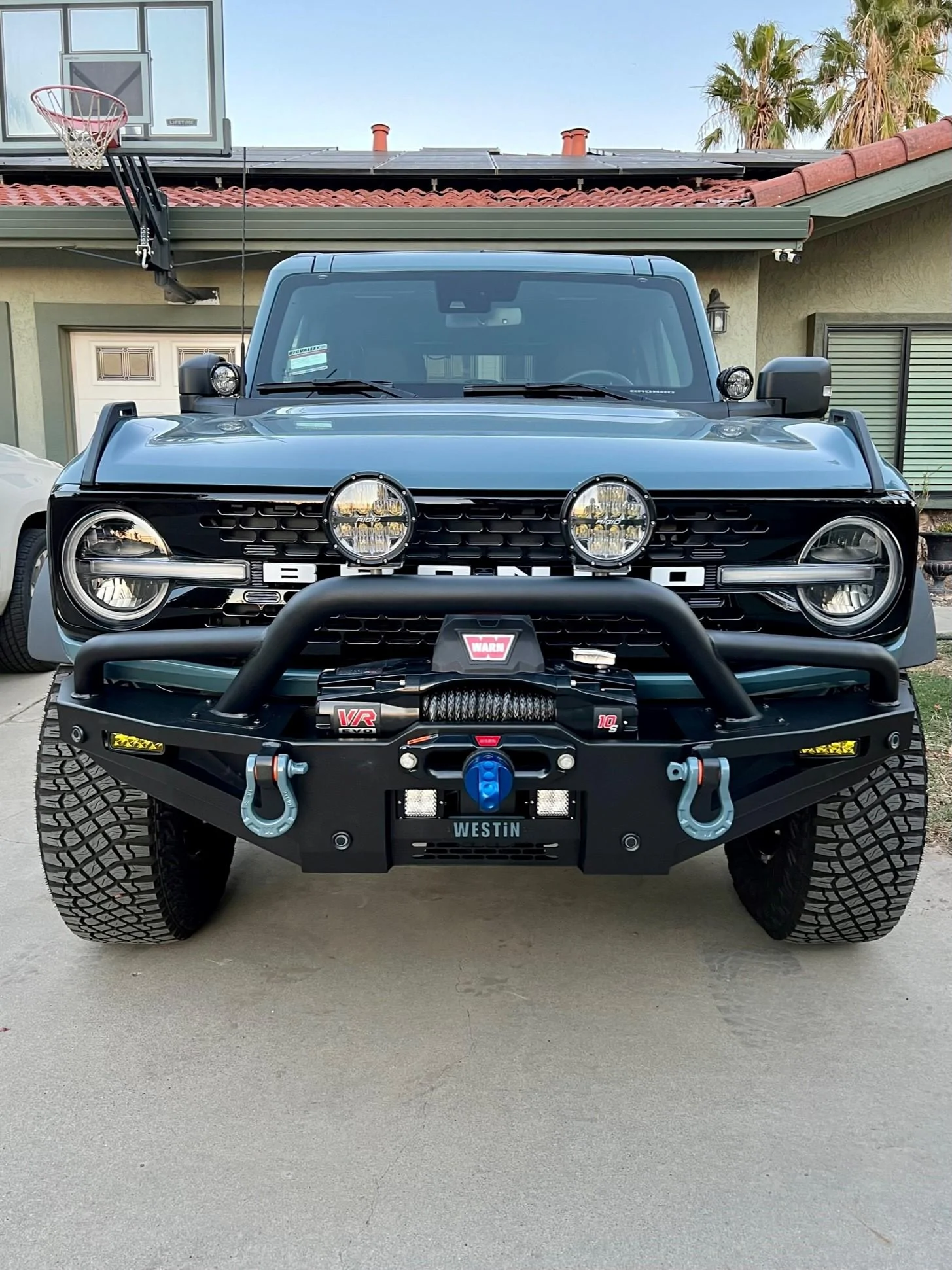

Installed the Westin XTS winch bumper on my Wildtrak yesterday, and a few lights... Front camera relocation kit is on its way. (Would have liked to have done that first, but it has been on backorder for a while now).

ACC and parking sensors are working perfectly after install. The only problem I encountered, was that the (relocated) ACC sensor is now about 5-6" further forward than the stock location, so, the OEM wiring harness and plug would not reach it. I had to cut the harness and extend it by about 6" (four wires to cut / solder / heat shrink). Not really anything terrible, but it is something that Westin failed to address. I sent an email to them to document the issue and tell them that they need to include an extension harness in their kit, in the future.

The only issue I had was with the ACC wiring harness being too short to reach the relocated sensor - See my other reply. Ordered through Bumper Superstore. They had the lowest pricing on it, by quite a bit. It shipped direct from Westin, and took about 3 weeks for both pieces (bumper and the bull-bar) to arrive.

I expected that mine would drop a bit, but It didn't drop at all. I do have an RPG perch collar lift, on mine.
