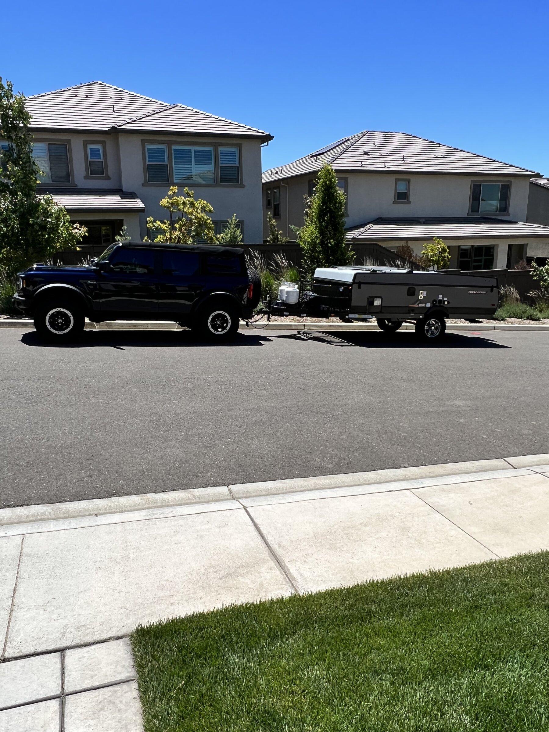

Ordered a weight distribution hitch. Curious if anyone is using one and if it made much of a difference. I have the SAS. Has to go beyond the 35"spare.

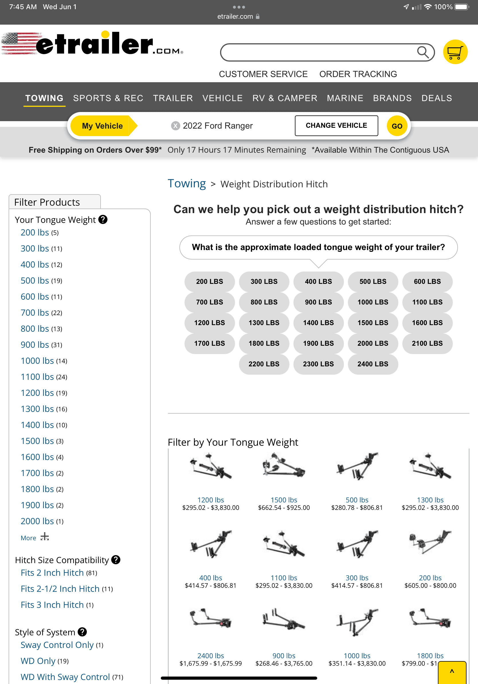

My definition of a WDH is one that bolts to the frame rails like this one for a 2022 Ford Ranger: https://www.etrailer.com/hitch-2022_Ford_Ranger.htm?&Redirect=8
What you're describing is more for "sway control": https://www.etrailer.com/Weight-Distribution-Hitch/Blue-Ox/BLU36FR.html
per etrailer: " Minimize trailer sway and ensure a level, stable ride with this weight distribution system. Positive caster angle works to keep your trailer centered and steel-on-steel friction corrects sway. "
and
  • "Weight distribution system ensures a level and stable ride when towing
    • Evenly distributes weight over axles of tow vehicle and trailer
    • Helps you maintain better control of your vehicle and avoid trailer sag and excessive tire wear
  • Built-in sway control limits side-to-side movement of trailer
    • L-brackets rigidly hold spring bars in place - unlike chain-style brackets - to keep your trailer in line
    • Positive caster angle in the hitch head keeps trailer centered and helps prevent sway before it begins
    • Steel-on-steel friction corrects sway caused by winds or sudden maneuvers"
Yes... etrailer calls it a WDH, but it's only distributing the trailers weight to stabilize the trailer to the ball and not to the vehicle like I perceive a WDH should do.
So it boils down to semantics..... ;)

Not to be argumentative, but your definition is incorrect. Sway control and weight distribution can be accomplished in the same accessory. Weight distribution has nothing to do with what is installed on the truck side, it’s about adding leverage to the connection to push the front tires down. It’s a clear cut definition, not semantics.
Here is etrailer’s page for WDH:
https://www.etrailer.com/dept-pg-Weight_Distribution_Hitch.aspx

Thank you for the replies. I am installing the Curt WDH on Tuesday. No extension just a longer shank. Probably a little overkill but better safe than sorry.
