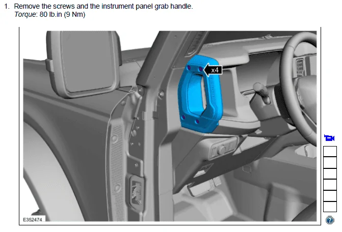

The OP doesn't mention which particular "bronco bolt" was stripped, but I just did some audio work on mine and noticed the torque spec listed for the grab handle by the driver's door hinge is a very low 80 inch pounds (less than 7 ft lbs) so if you're applying much torque to them it'd be no wonder if they stripped.
I have to wonder what those are actually threaded into. With such a low number I wouldn't be surprised if it was just plastic. They seemed to have a ton of flex when I grabbed it at the dealer event.
To me that's just asking for breakage trouble.
