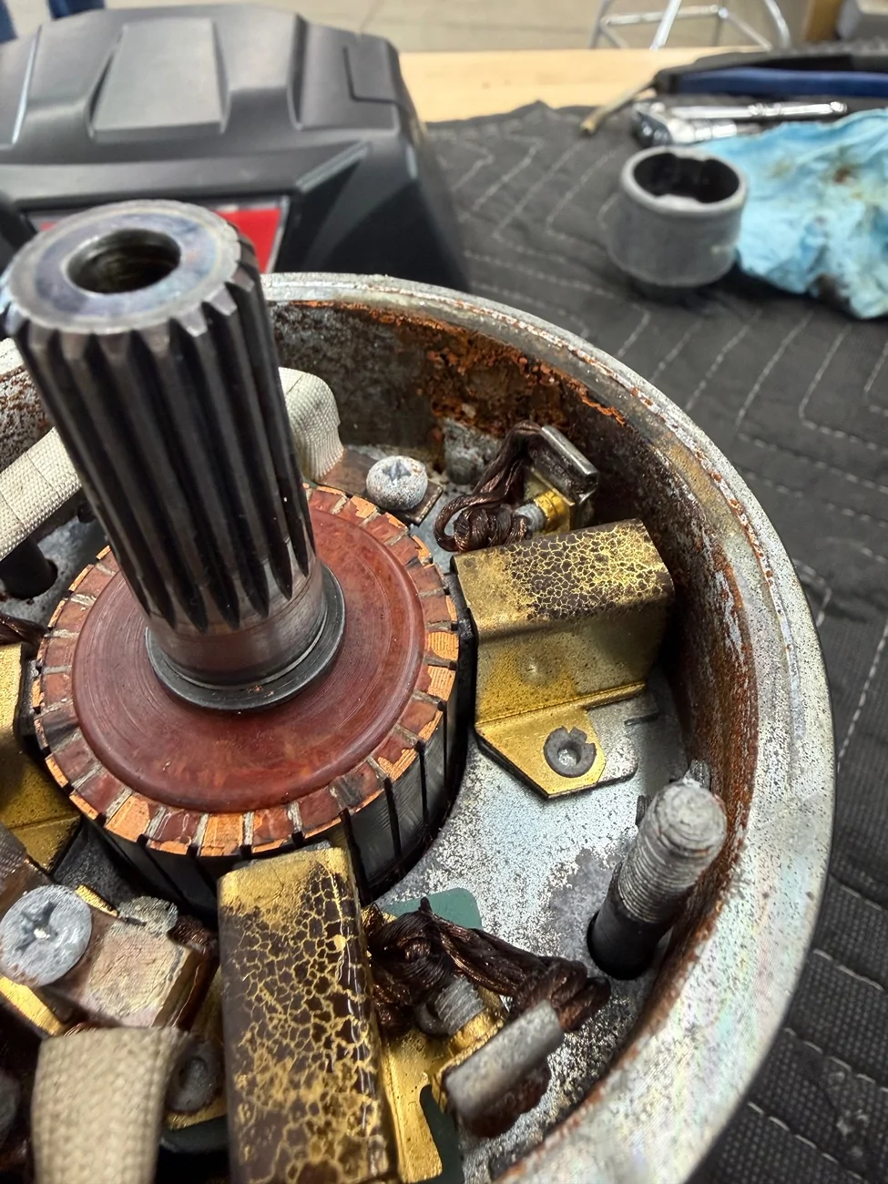

This is the exposed end of the motor.

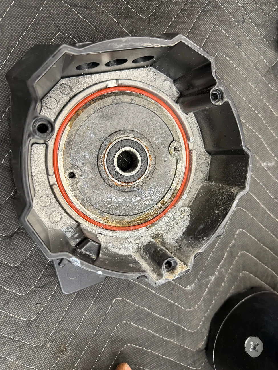

This is the plate section the open end of the motor sits against. That o-ring is supposed to keep any water that gets into the housing from getting into the motor. Yes, there is moisture on the interior side of that o-ring where the motor faces. Yes, there is corrosion and sediment in the area where the o-ring sits.
Ford Bronco Warn Zeon XD 12s Issues - IMG_0230
Water had penetrated the motor housing, pentrated around the o-ring to the motor and the motor was rusted and there was still moisture on the cap the motor seeds against.
Swapping the new motor without additional service would most likely just give the issue another victim.

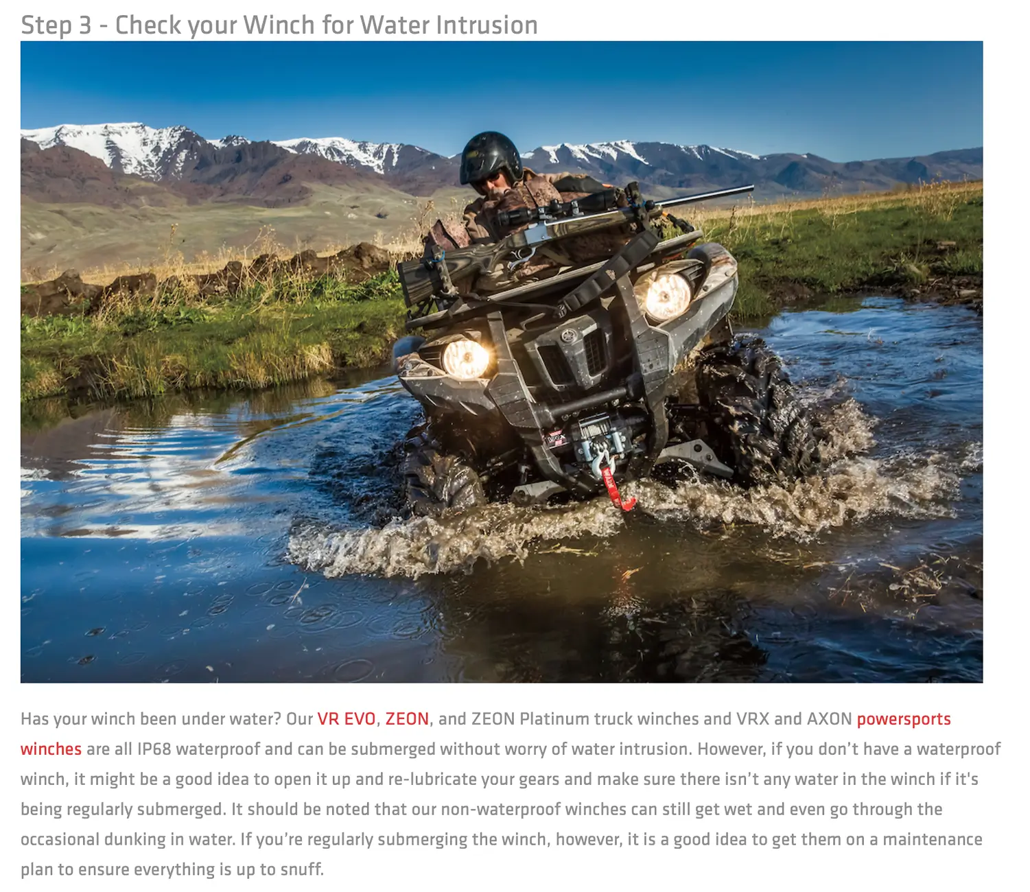

A Warn Technical Service Representative responded to one of my emails, couldn't speak to the cause of the water penetration, but did mention it could have been a bad seal (which was not replaced or serviced as part of the warranty) and she included the following in the email -
"To clear up any confusion: our winches are water-resistant, but not fully waterproof. They are designed to be submerged for up to 30 minutes in emergency situations, but they are not intended for prolonged or frequent submersion."
The rep's email then also included a link for the maintenance of a winch. That page describes my winch as being IP68 waterproof.
...Shake head here....
