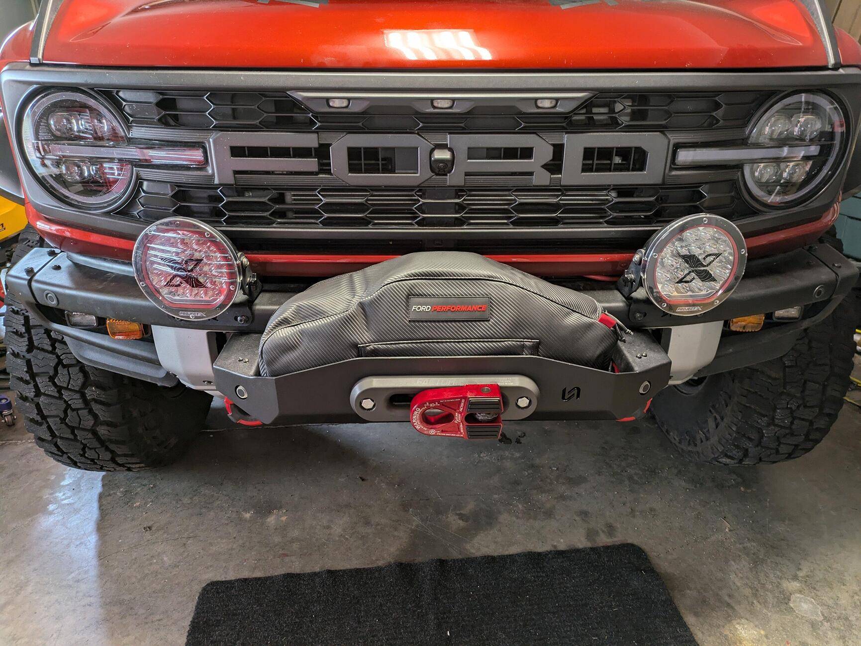

8/11/2024.
Added winch with the following components:
Warn VR EVO 10S
Turn Offroad winch plate
Frame horn reinforcement brackets - TD's / Mike's

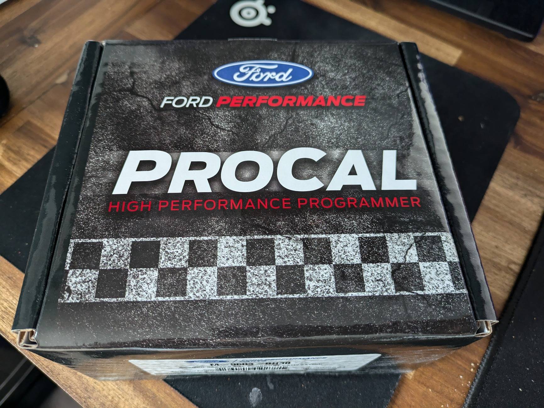

9/11/2024.
Added Ford Performance Procal Tune what a nice upgrade.

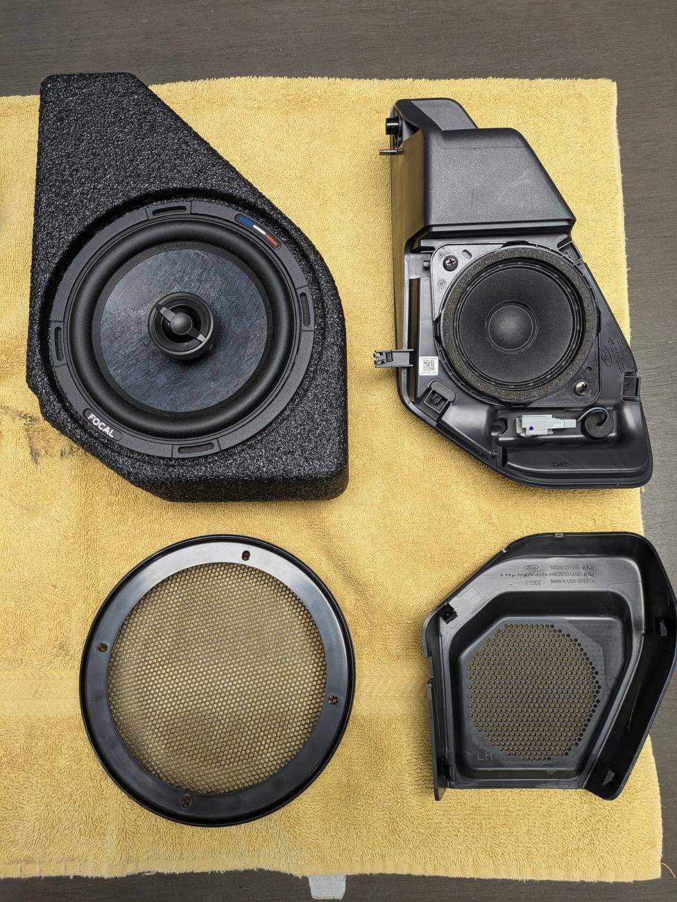

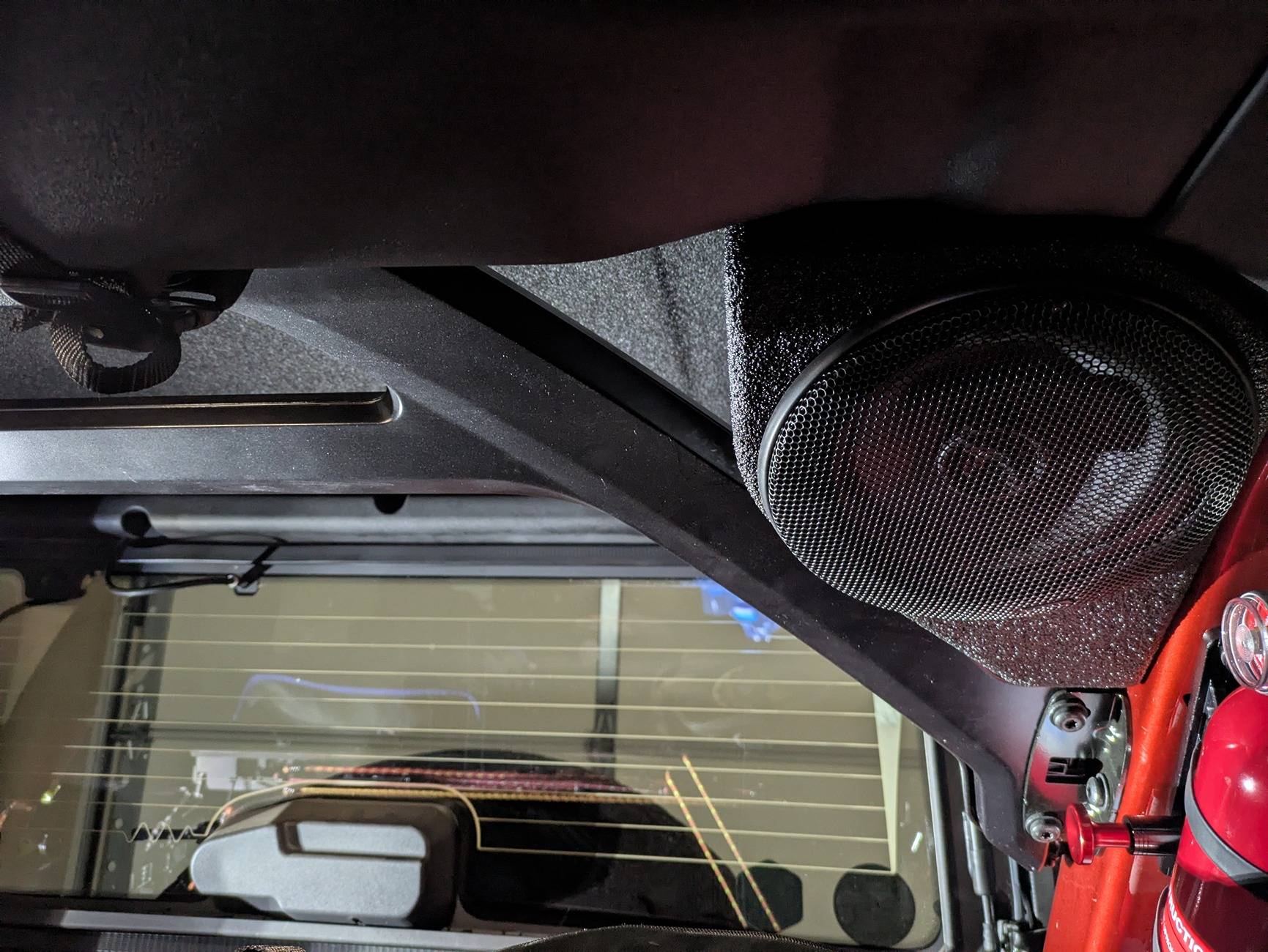

A couple months back I updated my rear pods to MTI Acoustics housings and 6.5 Focals. I also did the Forscan changes for EQ and rear pods settings. This was my last speaker change I replaced all the other speakers already.

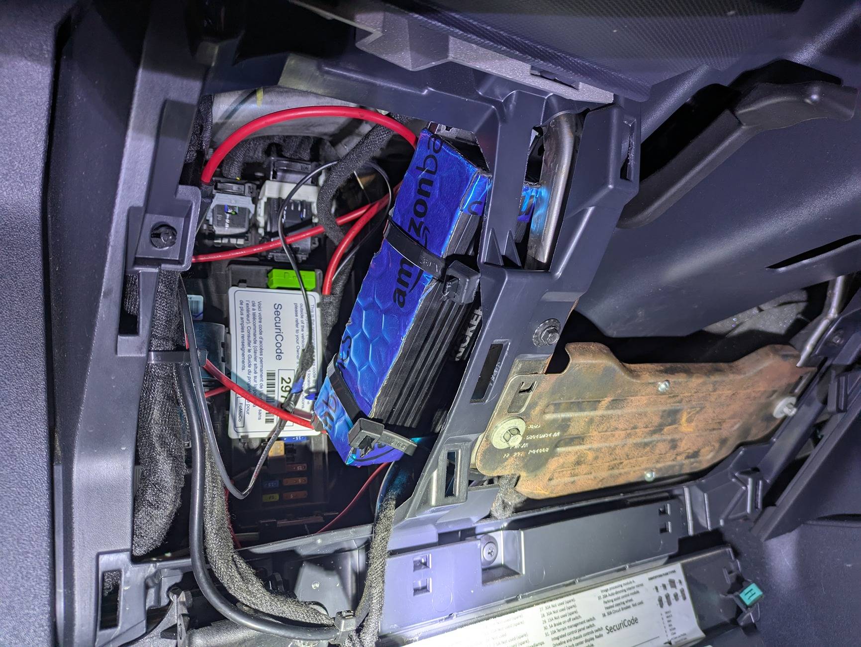

Yesterday I started the install of a Kicker Key 200 and a Plug N Play Kit 11. First I had to find a place to put it because I have a GMRS unit above my glovebox and Fords trailer control module bolted to the metal bracket below the steering column. I found a spot that made it easy to access and it's not blocking anything. Its pretty secure and not going anywhere. I partially wrapped it in dynomat and ran both pos/neg to the battery to avoid any feedback issues.
Ford Bronco vrtical's Bronco Raptor Mod Journal 1000005417
Next I set the DSP up and went through that process with no issues. I put the mic on top of the center console arm rest as that is more center than on a headrest. Soo far I set the front gain only to a 1/4 and left the rear at 0. Looks like I can crank it to about 22 on the volume before seeing any clipping. I will keep fine tuning it but over all its obviously better and pretty clear now.

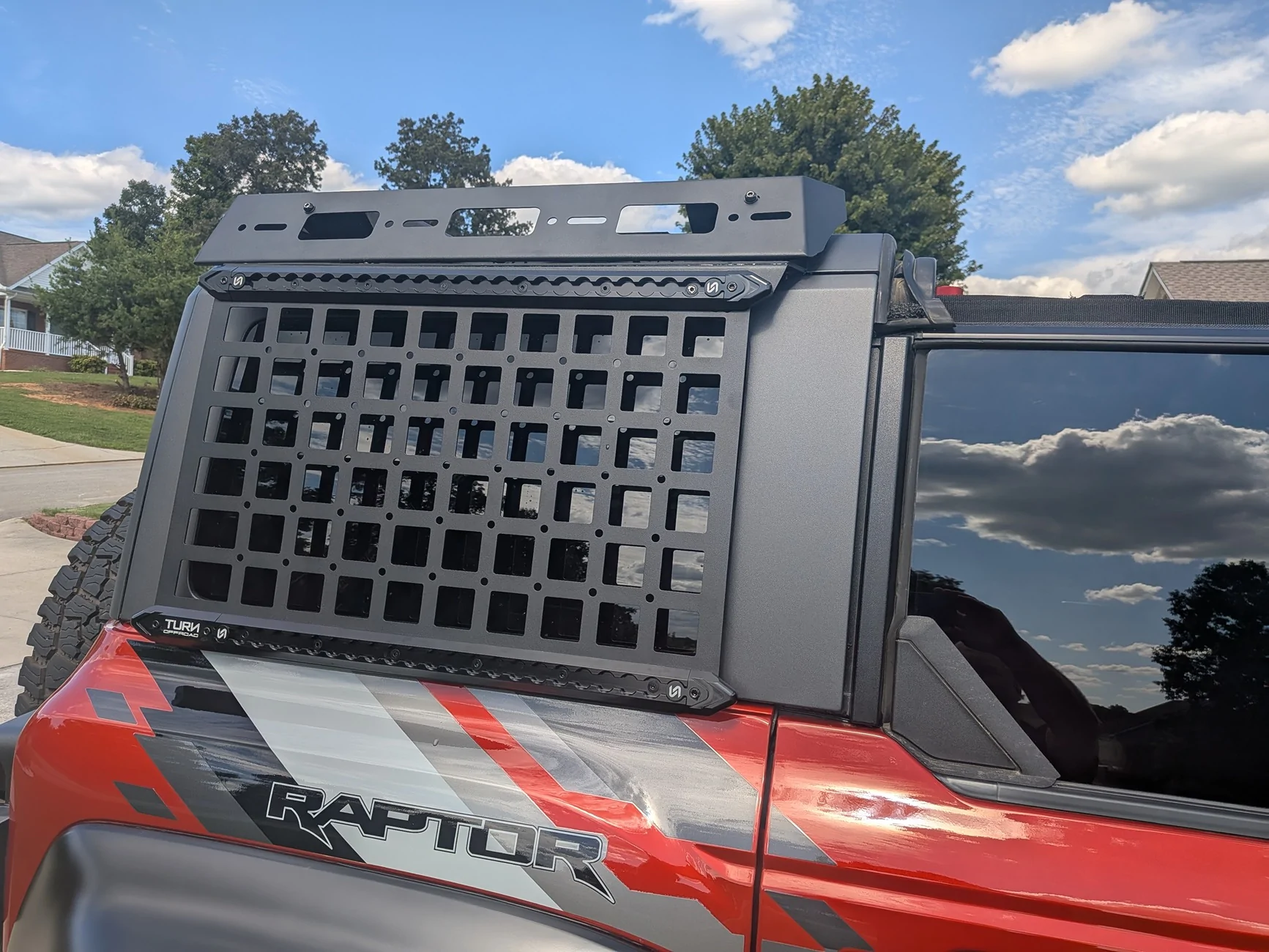

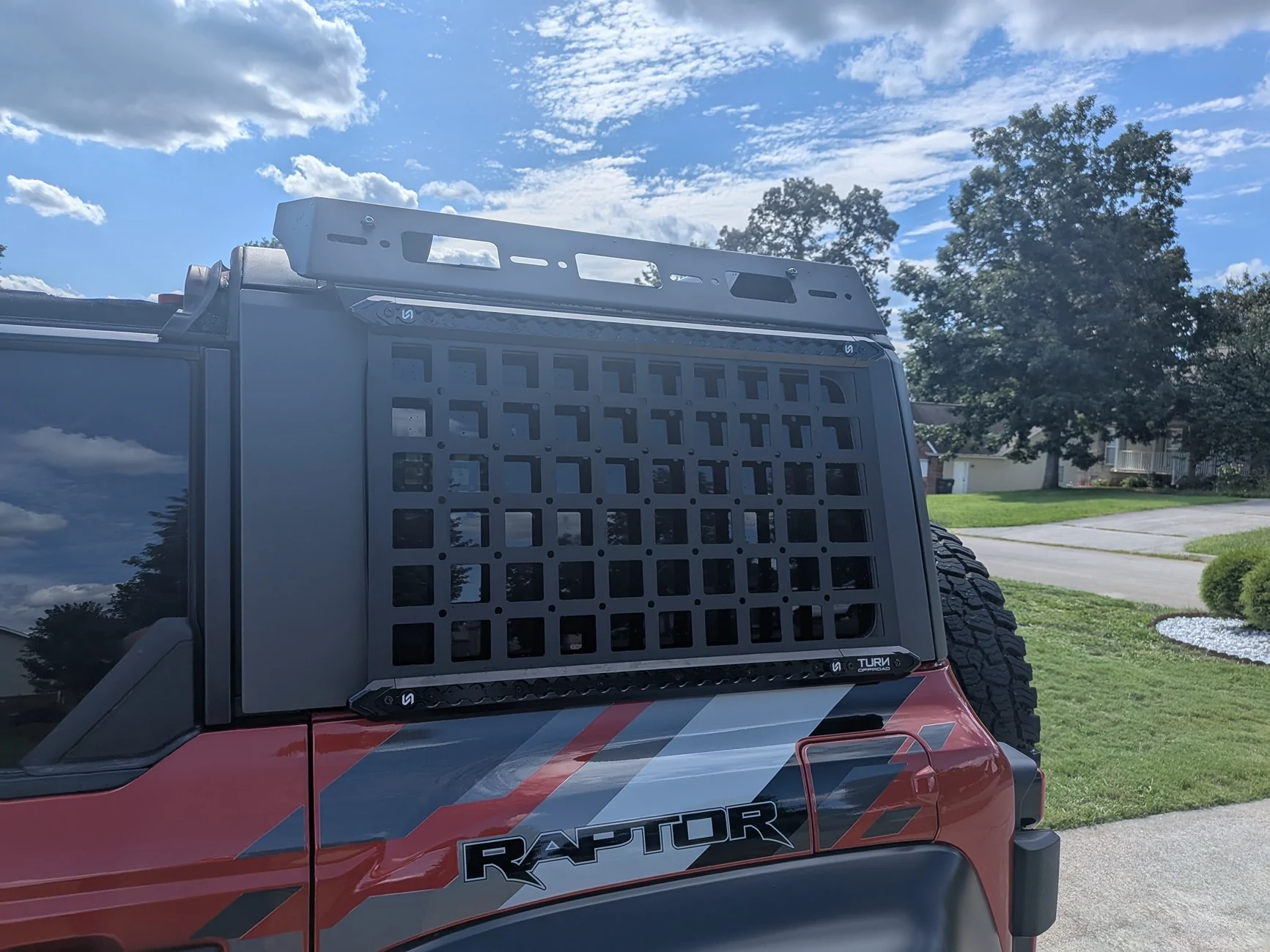

Added Turn Offroad side molle panels for additional overland storage and protection. @Turn Offroad
