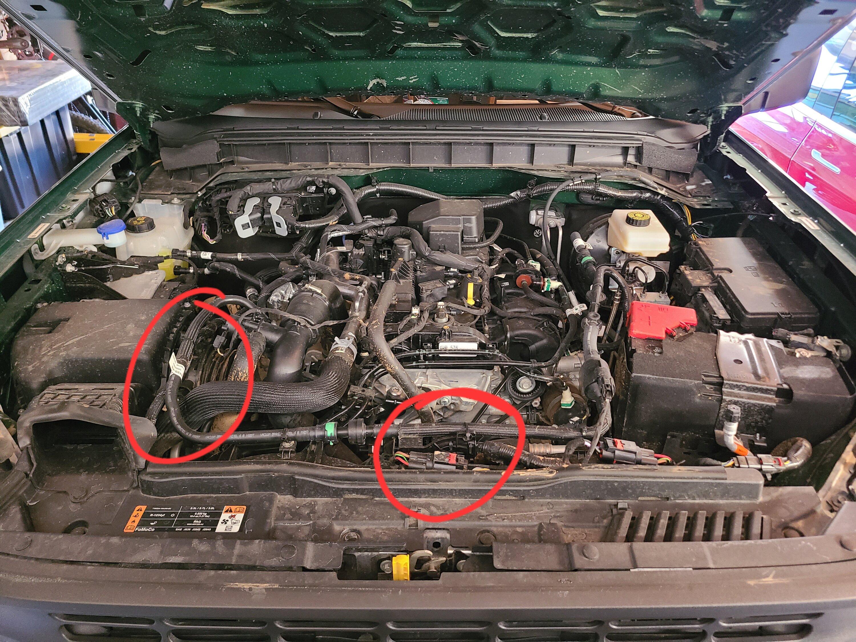

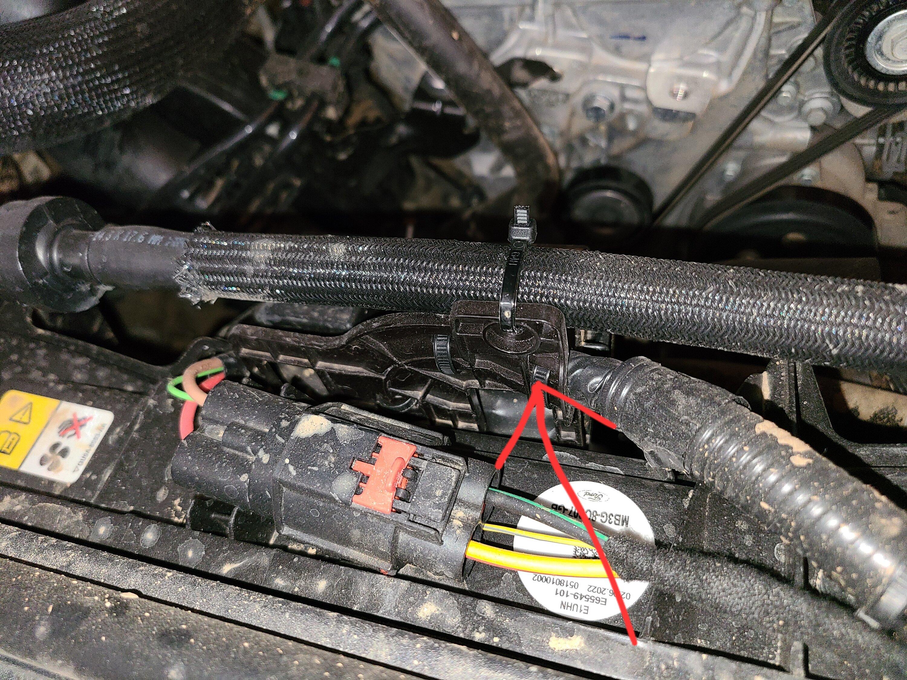

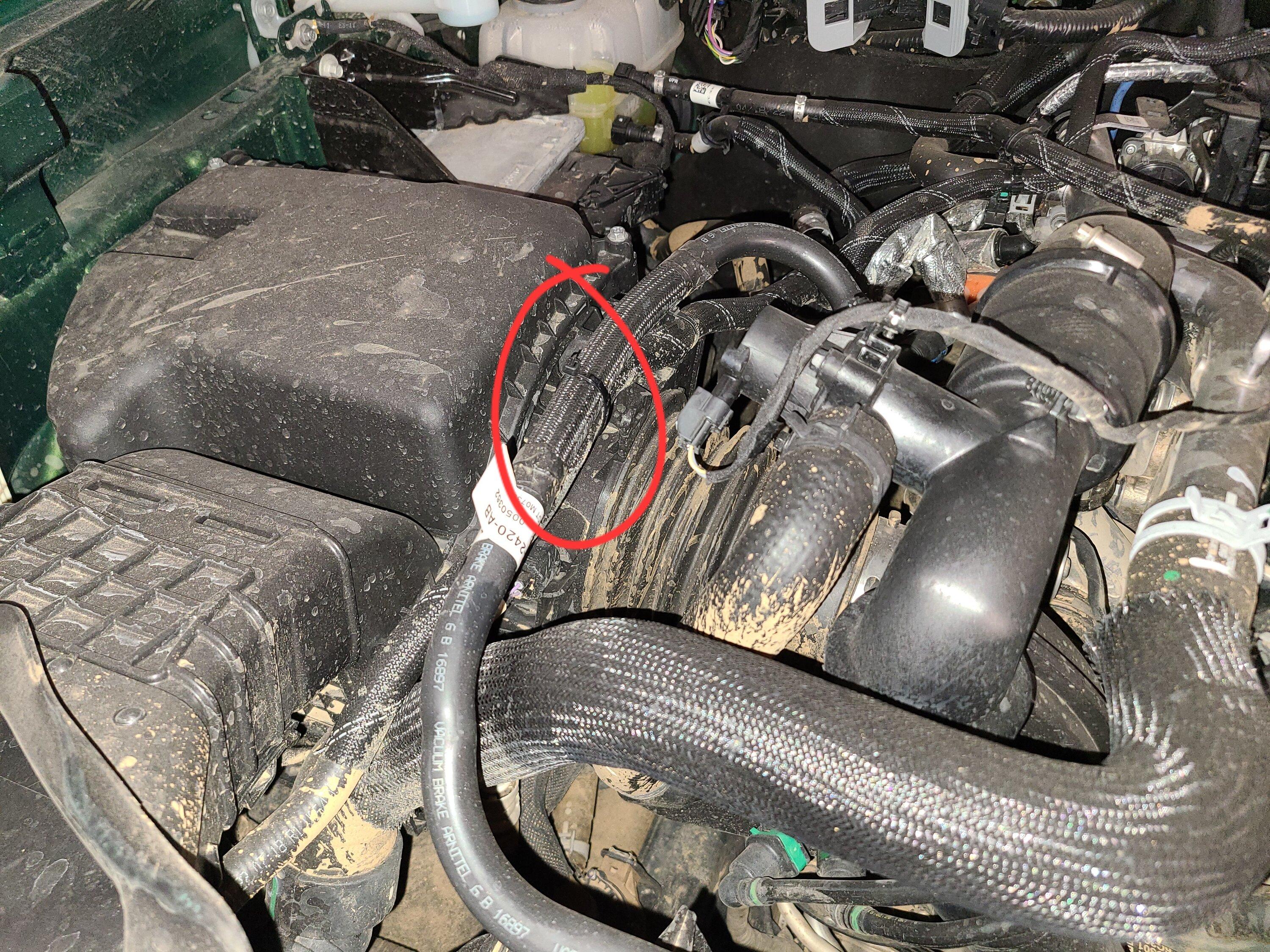

Same thing. Only happens when a/c is running on a hot day. Must be radiator or cooling fan related. I popped the hood when it was happening to me and noticed these hoses and this little plastic bracket vibrating violently. Design of the bracket looks like an afterthought and seems like the hose clip was not installed. So I added some zip ties as a temp fix until i get it on for first maintenance appt. It helps quite a bit.
