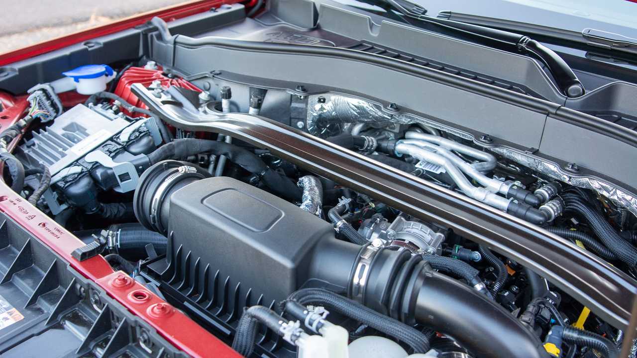

1. F150 was designed from the ground up to handle a v8...Yes. Jeep had to reinforce the frame because their v6 engine has 260 ft lbs of torque. The 2.7 and the 5.0 are very comparable in that aspect. You guys don't get to claim the 2.7 has the same power and that you'd need 10 grand worth of frame reinforcements for the 5.0. lmao.
2. Drop the engine every time you wanted to change spark plugs? Dude, have you ever looked at a coyote? Do you realize these are not 350 chevys with spark plugs on the outside of the cylinder heads? Do you have any fucking clue what you're talking about? Oh my god I'm gonna have to drop the engine to get to this thing right here!:

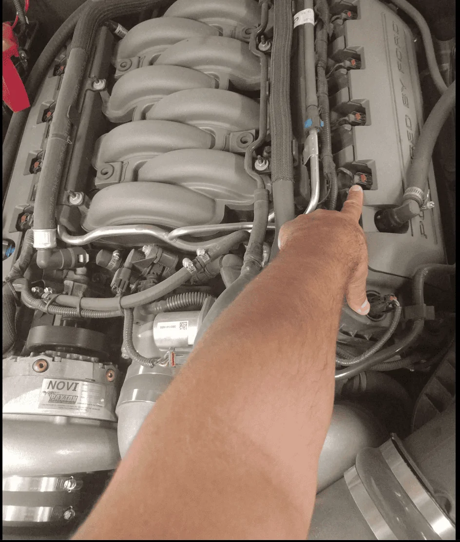

Once again, the 5.0 is a 1000 dollar more option in the F150. Where the hell are you getting 10 grand option in the Bronco?
5.0 is about 3” Longer, 6” wider 8” taller than the 2.7/3.0 ecoboost
Not sure where you get your information on engine dimensions from, I'm guessing from the same place that told you you have to drop your engine to change spark plugs...
Here's a fun fact. The 5.0 comes in a smaller lighter crate than the 2.3.
https://performanceparts.ford.com/part/M-6007-M50C
https://performanceparts.ford.com/part/M-6007-23TA
You're probably thinking just the engine block and not counting the turbos and piping - which are very much required for the 2.7 and can't be hooked up with home depot dryer vent hoses... That or you're just pulling numbers out of your ass. I can guarantee you will add quite a lot of extra width with those turbos on, much more than the extra 0.4 inches in bore diameter between the 2.. Had you had a coyote and a 2.7 you'd know this... I have/had both, I don't have the 2.7 anymore otherwise I'd go measure them both right now.
Ford Bronco V8 Jeep Wrangler production prototype spied testing 1595748429939
What you are saying is the 2.7 is 23" long, 22" wide and 19" tall? If the 2.7 was that short in height, trust me, Subaru would be using it instead of their boxer engines... And at 22 inches width complete with turbos, I'd have 2 of them side by side in some kinda project...

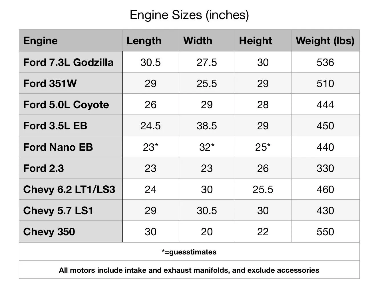

1 Jeep has a diesel with 440lbft. Your telling me jeep need to change the Frame for 10 more lbft?? no they needed to change it because the motor wouldn’t fit properly and it needed to be changed to fit the front axle under it.
2 have you seen what a 3.0 nano (same thing as 2.7 just bored and stroked) in the explorer??? Good luck working on that let alone. V8! And the bronco engine bay isnt going to be any bigger.
Ford Bronco V8 Jeep Wrangler production prototype spied testing 793BEBE4-638E-40B6-8151-0B971761DDD3
3 2.7 vs 5.0 at sea level with the same gearing is MARGINAL. so let’s just drop that.
4. since when do you need more that 600/600 crank in a MIDSIZED vehicle? In a full sized truck sure more is better. but even 600/600 is over kill In a small truck.... and that was achieved with MAYBE $10,000
5. THE 150 IS ONYL A MOTOR SWAP TO FIT THE 5.0 vs 2.7!!
hence why it’s only $1000. To fit the 5.0 in the bronco your going to have to move almost everything In the bay out. Move the frame add mounts Add reinforcement probably change the suspension (all the same shit Jeep had to do with the 392) that’s why it will be a very pricey premium

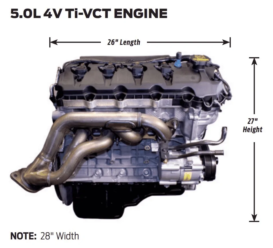

6. including turbos, intake, exhaust, w/o accessories this is the dimensions. (I think I goofed a bit on the width last time...conversions...) but still 3“ longer and 8” TALLER which once again see explorer above. I don’t think you have 3“ in length. And 3” taller? Good luck.
Ford Bronco V8 Jeep Wrangler production prototype spied testing AB082867-899C-4372-8FF9-FD3CBD3F6C13
it’s also worth noting because the 5.0 is a 90 degree block Val everything else 60 degree. It makes it harder to fit between the frame rails. Meaning TYPICALLY you have to mount the 5.0 higher than a say LS or even 351w. So what are you going to do? Cut 3” into the fire wall and then put on a 5“ tall hood bump that will stretch the entire width?
all for what??? The sound?
as I said before. 2.7 Ecoboost bronco with even $20,000 worth of tuning will be 600/600
that will BARELY get you a v8 with a tune to maybe make 450/450. After market is already asking $30,000+ to v8 swap rangers and broncos. And that’s just the 400/400 stock v8. Let alone anything like a blower. Which most shops charge well north of $10,000 to INSTALL a blower.

Lol, this is getting out of hand. You "goofed a bit"... ok. And wow that 2.7 is made of magic compared to the 3.5 - same 60 degree v6 but with a 0.14" smaller stroke it manages to drop 4 inches in height in your "guesstimates". 0.37" smaller bore and it manages to drop 6.5" in width... and it still ends up 10% wider than the 5.0. So I guess they won't have to move that much stuff out of the way in the engine bay...
Not to mention the weight is the same essentially even according to your over-optimistic picture... so why would they have to change suspension and add reinforcements?
Btw, you really should learn to add and subtract. Not sure how 28" is "but still 3“ longer and 8” TALLER" than your guesstimated 25" in height...
I guess that explains why you think it would cost 10 grand for the factory to put in a 5.0... or 10 grand to INSTALL a blower.
