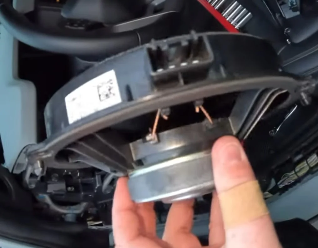

A friend said I can have his factory 6.5" kick panel speakers. Figured I'd pick up a set of Metra pods and replace the OEM 4" speakers on the roll bar. I already turned off factory EQ and set the backs to Speaker when I put in the amp and installed the subwoofer. Assuming the kick panel speakers will fit in the Metra pods. Anyone ever do this?

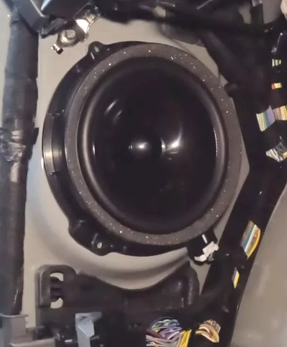

After looking at the factory speakers, the thick mounting ring will cause them to stick about an inch above the mounting surface. The Metra pods may be able to handle this (Mabett speaker grille will interfere with protruding tweeters). The plug is molded into the mounting ring, so it will take a little head scratching to get a clean install.
