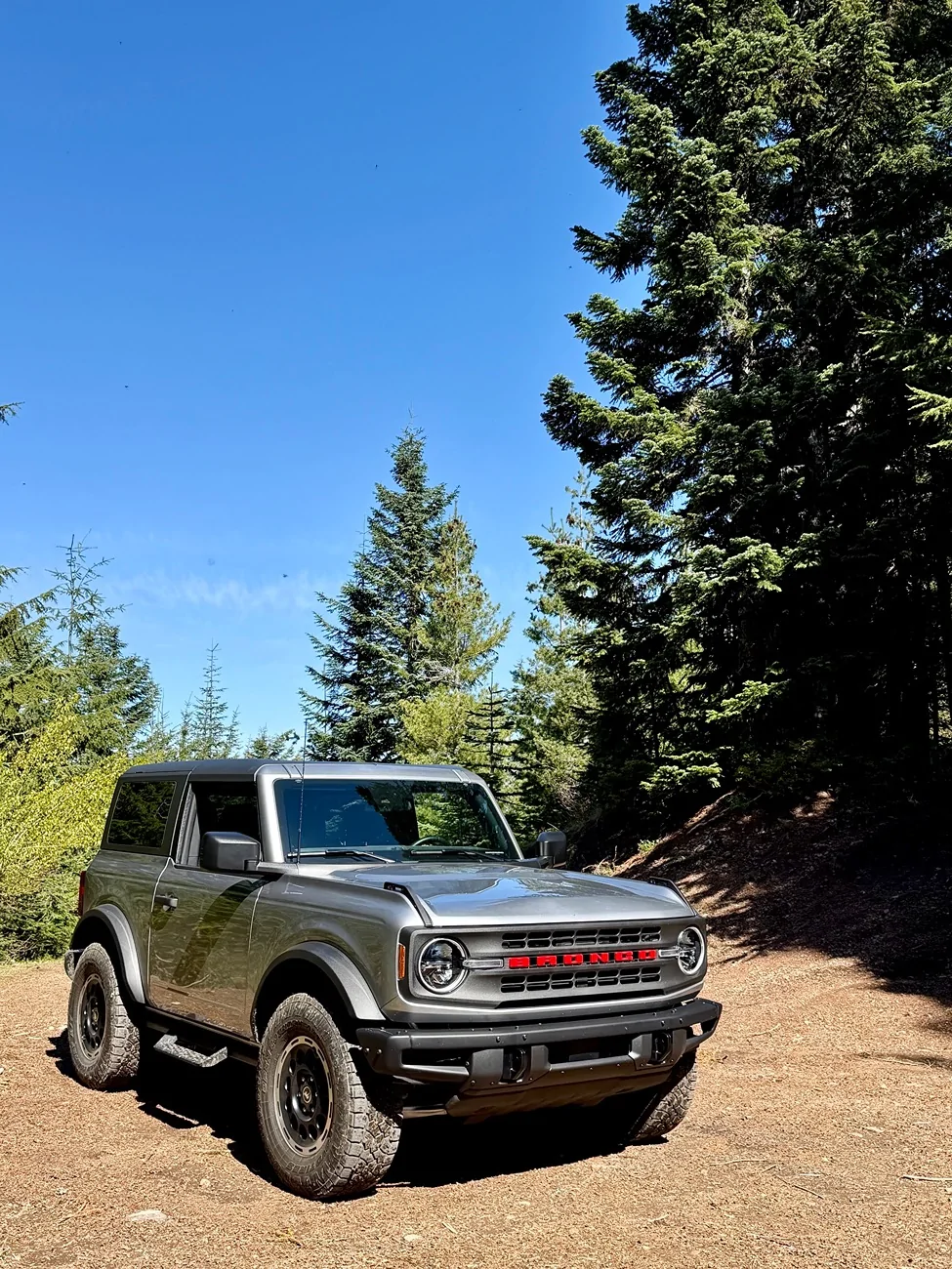

I have 285/70/17 on a 2024 Big Bend with stock suspension and no issues. I do light off-roading, still have the crash bars installed, and have not run into clearance issues.
Ford Bronco Upgrading stock tires on 25'BB IMG_2897
