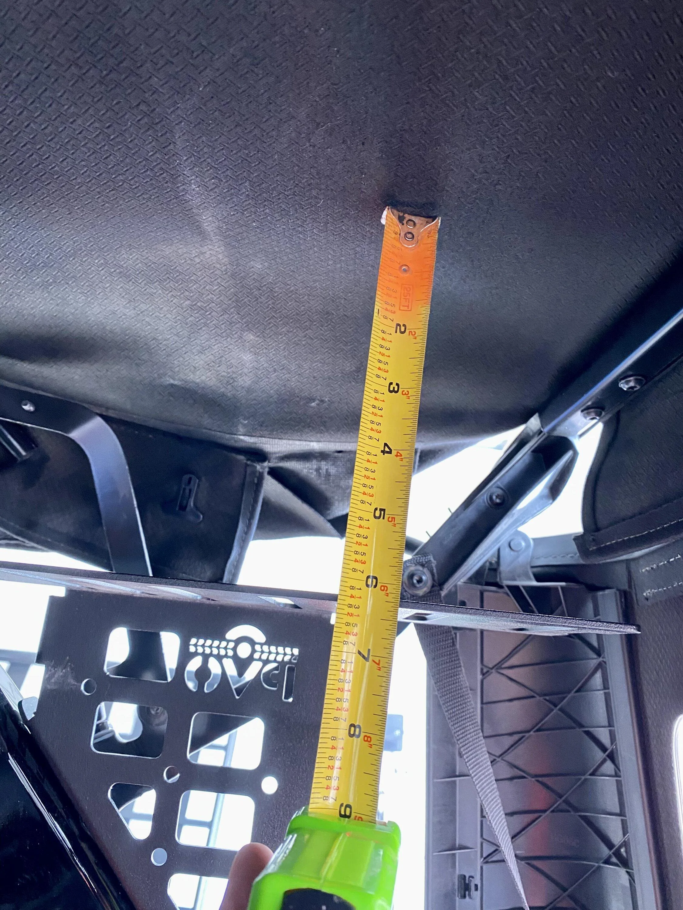

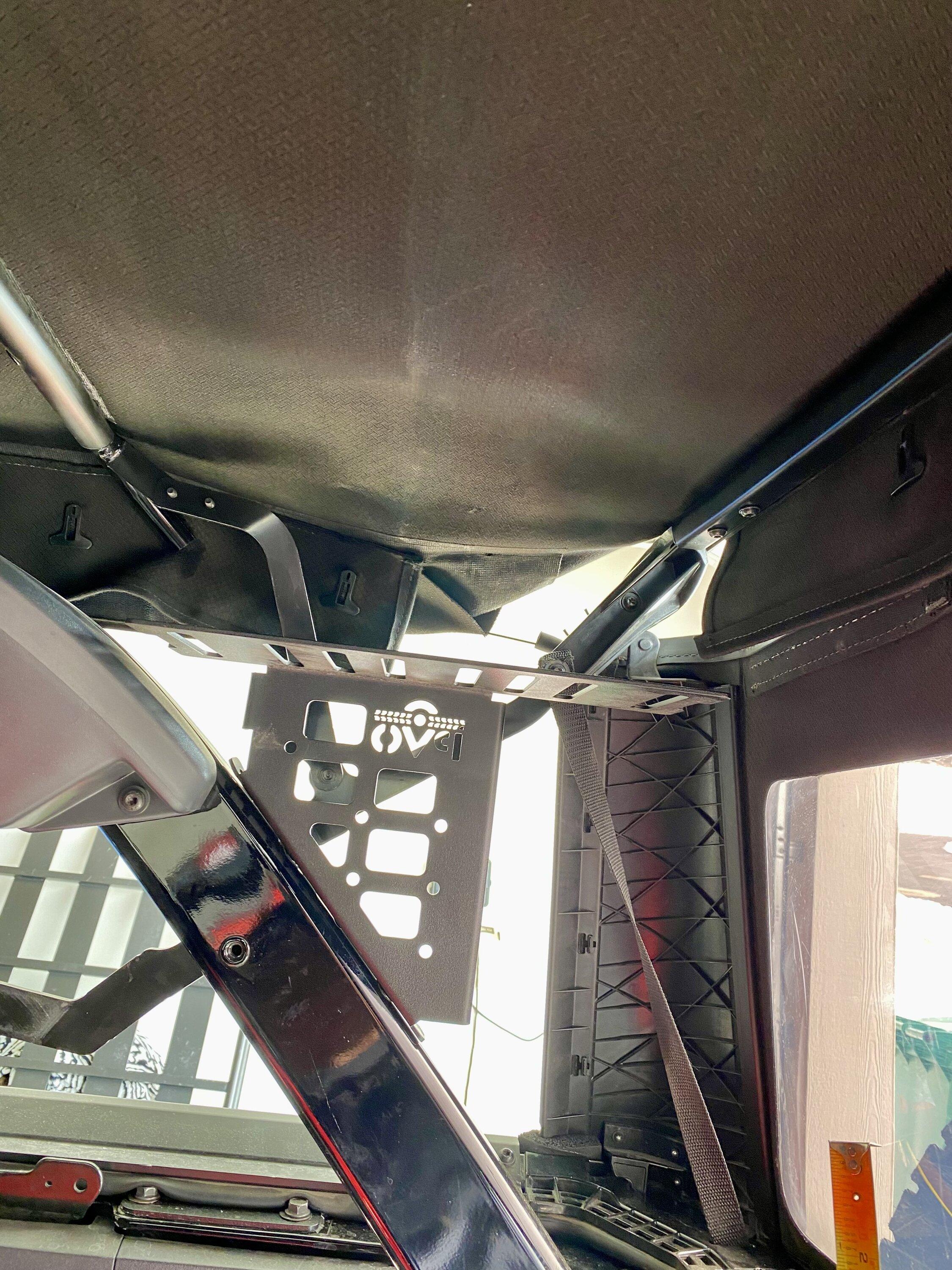

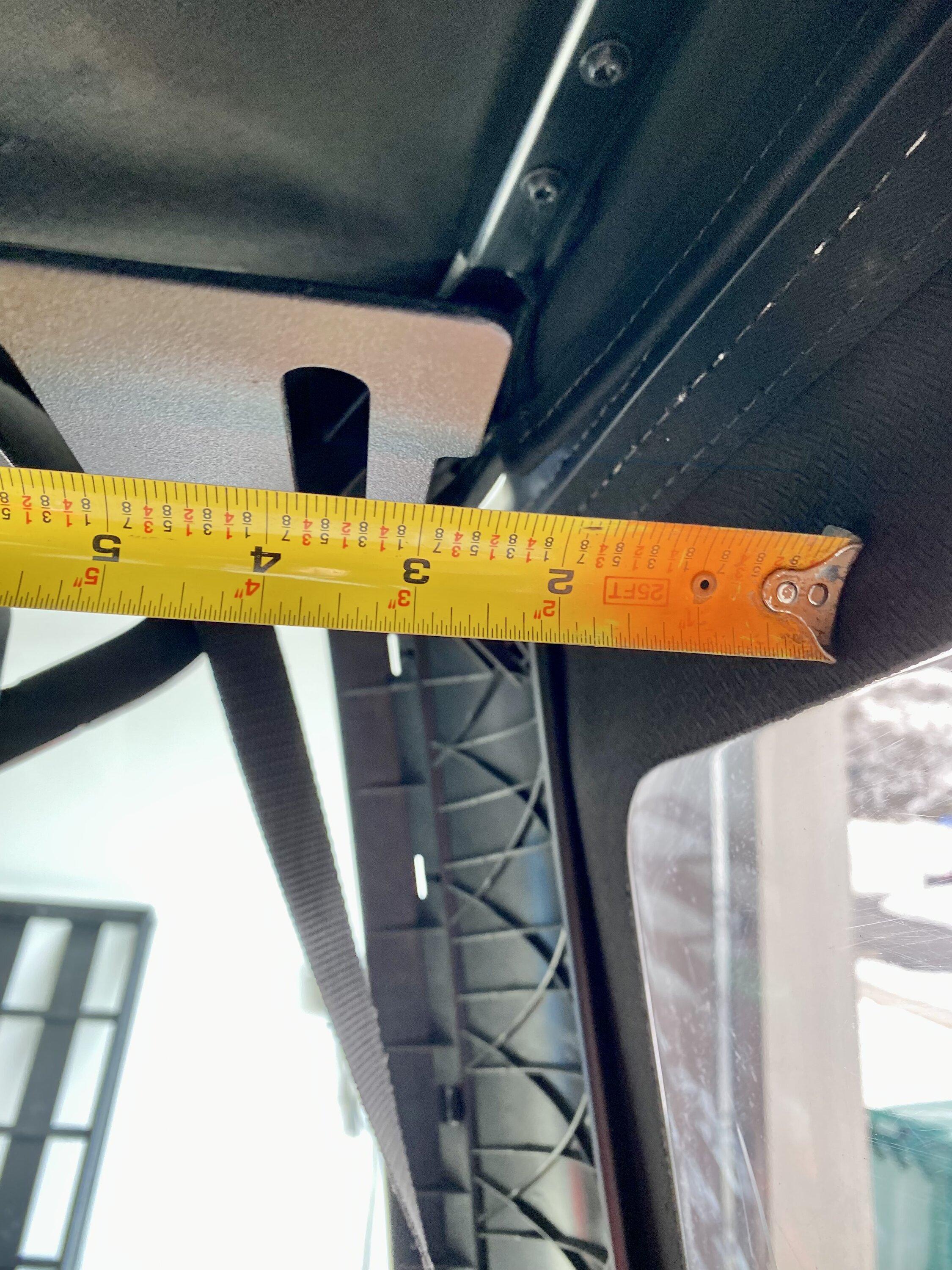

I was able to meet up with @RAKET over the weekend and do some test fitting of both the PVO Traction Board Brackets. I slightly modified the TBB by moving the platform forward by 1 inch, ensuring that there's no risk of it rubbing on the rear of the soft top or the window.
I now have over 2.5 inches of clearance between the bracket and the rear of the soft top so rubbing will definitely not be an issue for you.
Soft tops have more headroom than the MIC top so height was never an issue, and the soft top measures in with 6 inches of clearance between the bracket and the roof.

We tried to find a way to retract the soft top all the way to the fully retracted position2, and there's no way to make it work with the current design. The cross bars of the soft top interfere with the bracket both in the process of retracting as well as when we tried re-installing the TBB after the top was fully retracted. The TBB will still be fully useful when the top is fully closed or when in position 1, but just not in position 2.

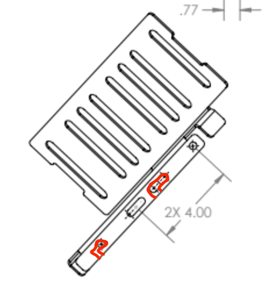

Yep, both are in stock and ready to ship. One of the things we were discussing last weekend was to notch the mounting holes allowing for a quicker removal of the brackets. This would allow you to simply loosen the mounting bolts, then slide the bracket out. There's likely not enough clearance for cam bolts in that area as that would also be nice to easily loosen and remove.
Here's a crappy drawing showing what I mean with the additional cutouts drawn in red. You could just cut those sections out and touch up with paint. I can work it into my next production run, but that might be a couple months out.
