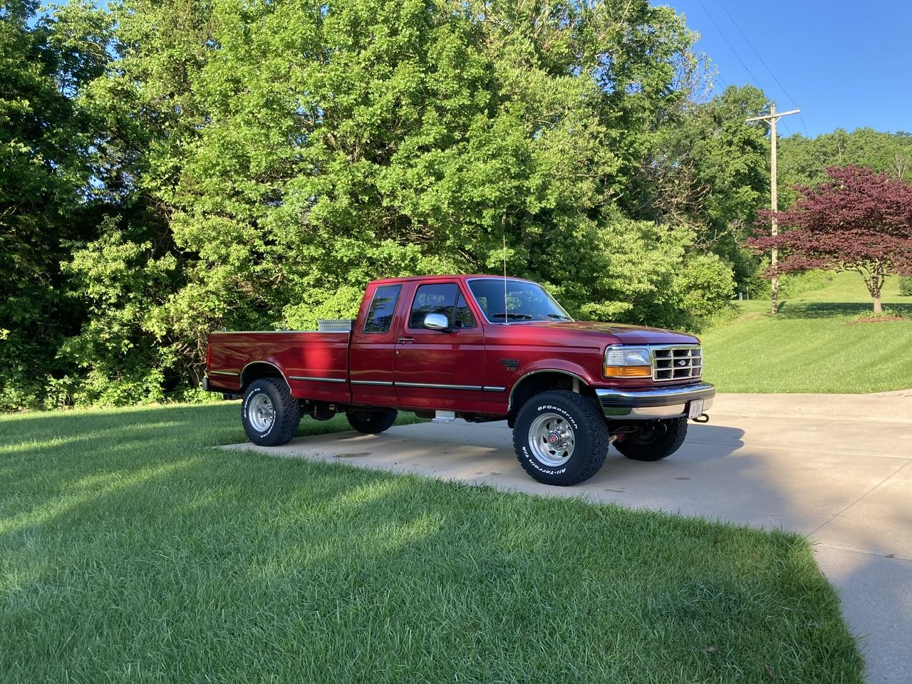

I live in the rust belt and I have a 30 year old F250 that still looks brand new underneath and all I’ve ever done is rinse it with an open garden hose anytime I get in mud or salt. I’m fortunate to have a garage so I can do that any time of year. Sidenote, if you’re going to apply an under coating, it is very important that the undercarriage is completely dry because if it’s not that under coating can trap water when applied and cause rust. Also, anything that is waxy, sticky, or oily will attract dust and dirt that holds moisture, and can cause future corrosion as well.

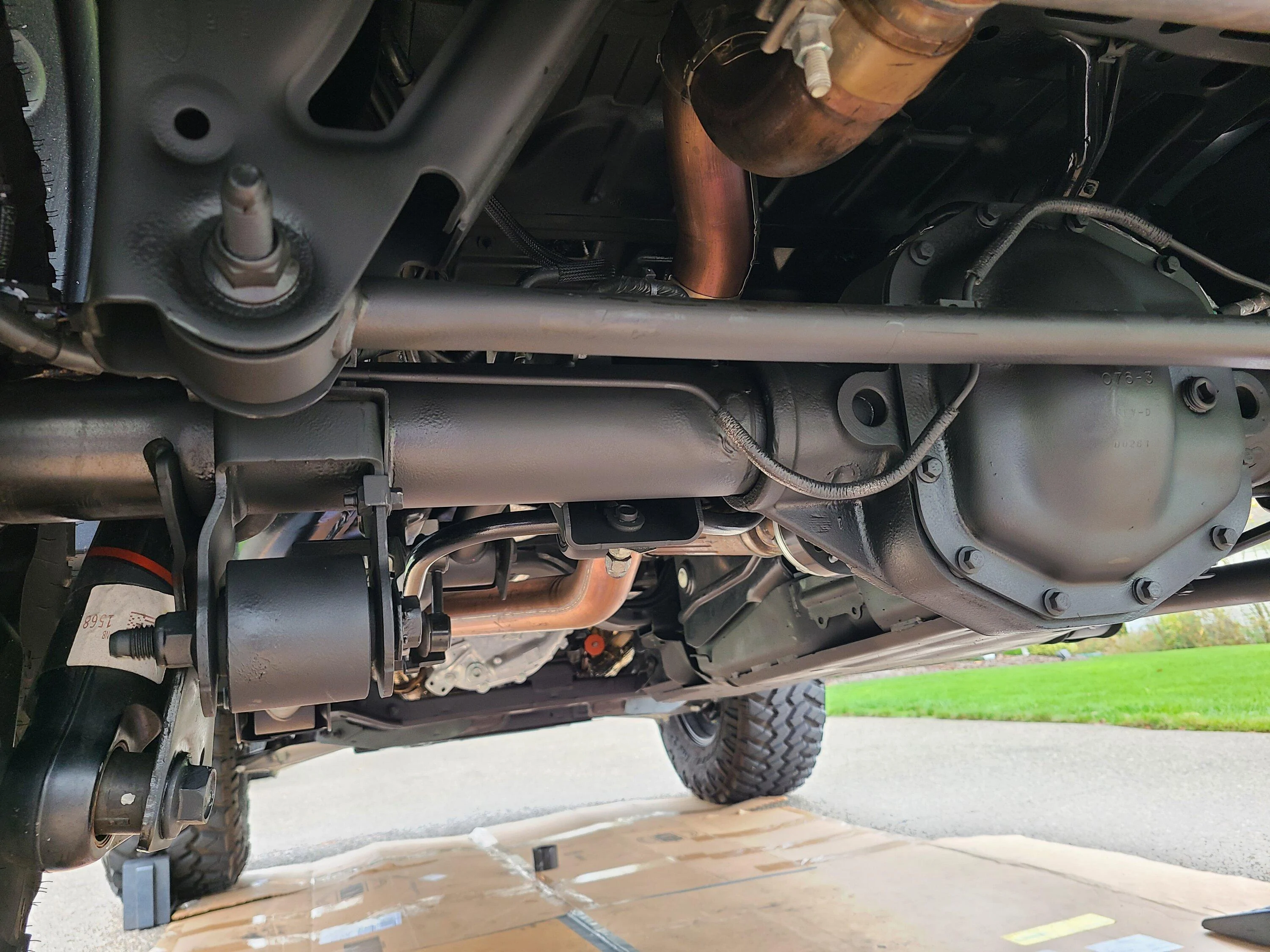

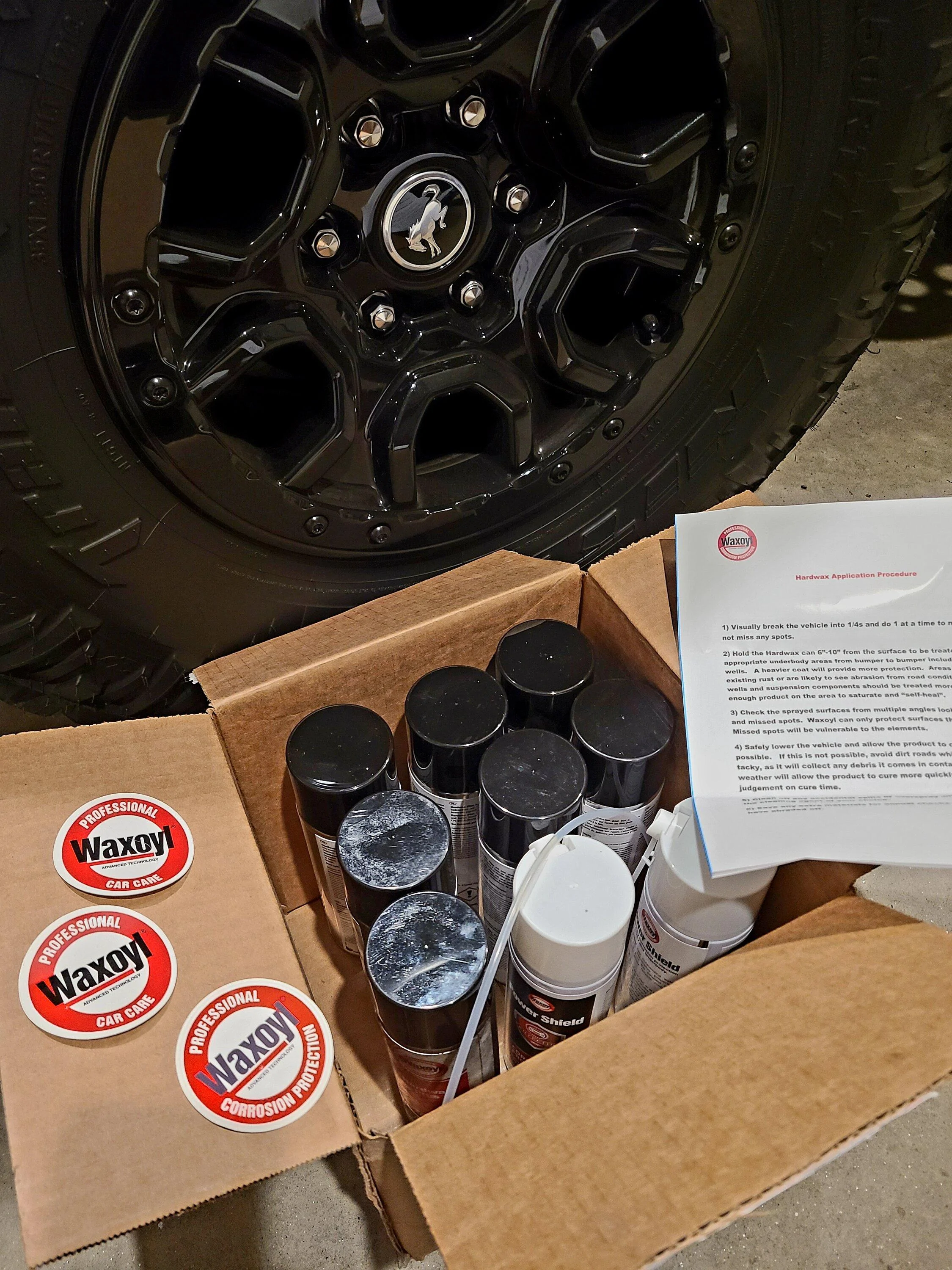

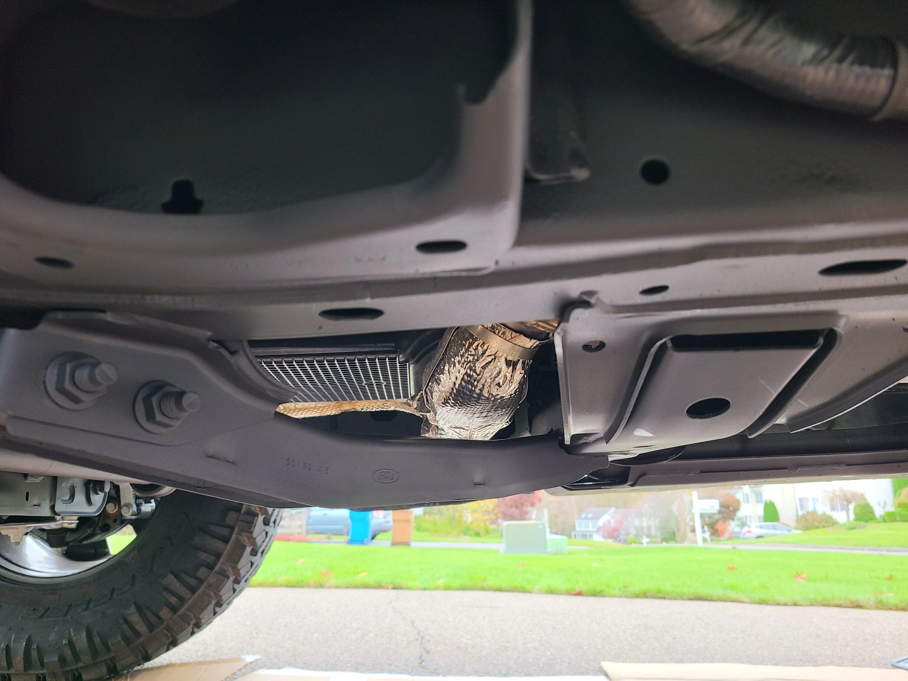

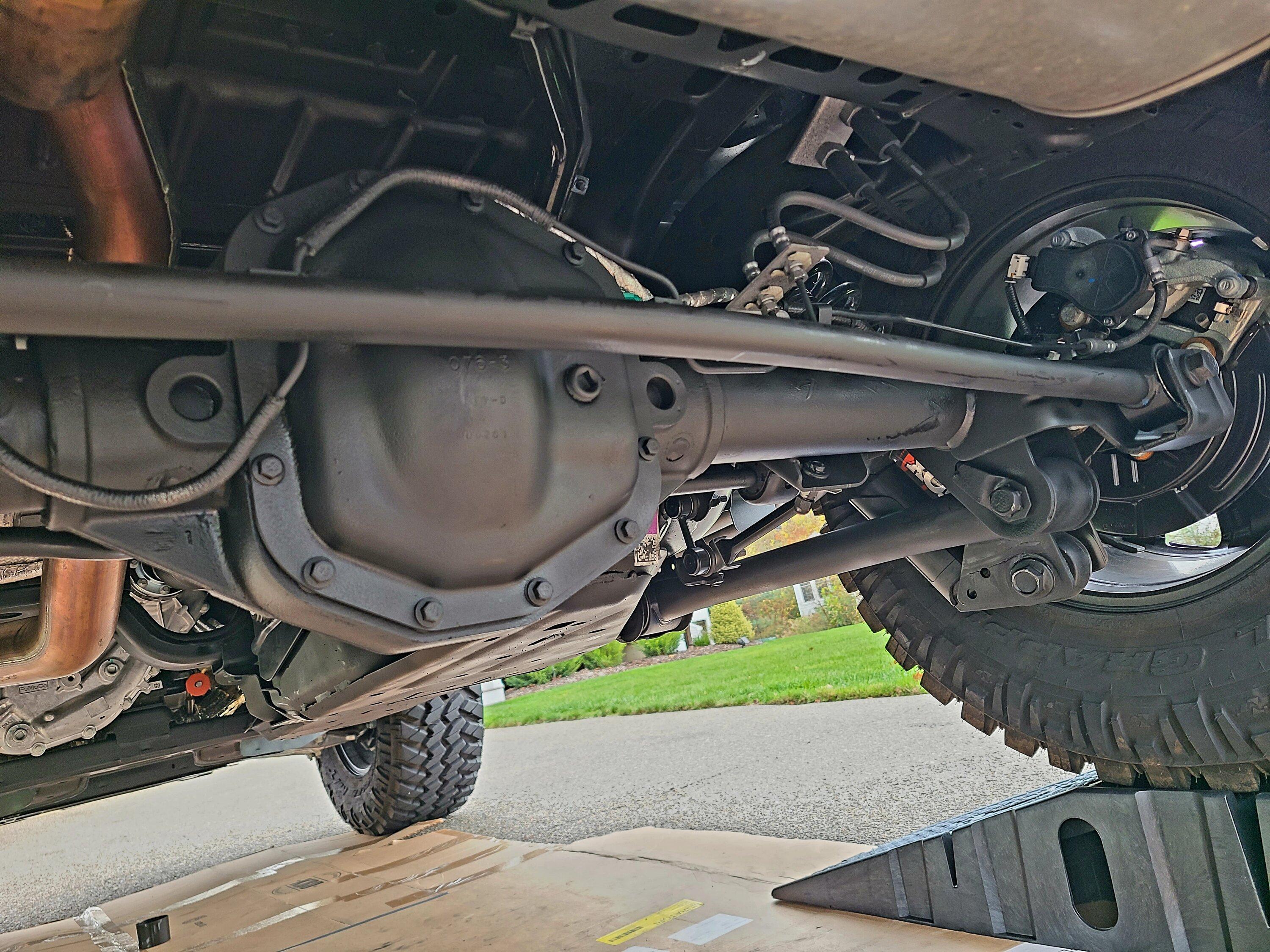

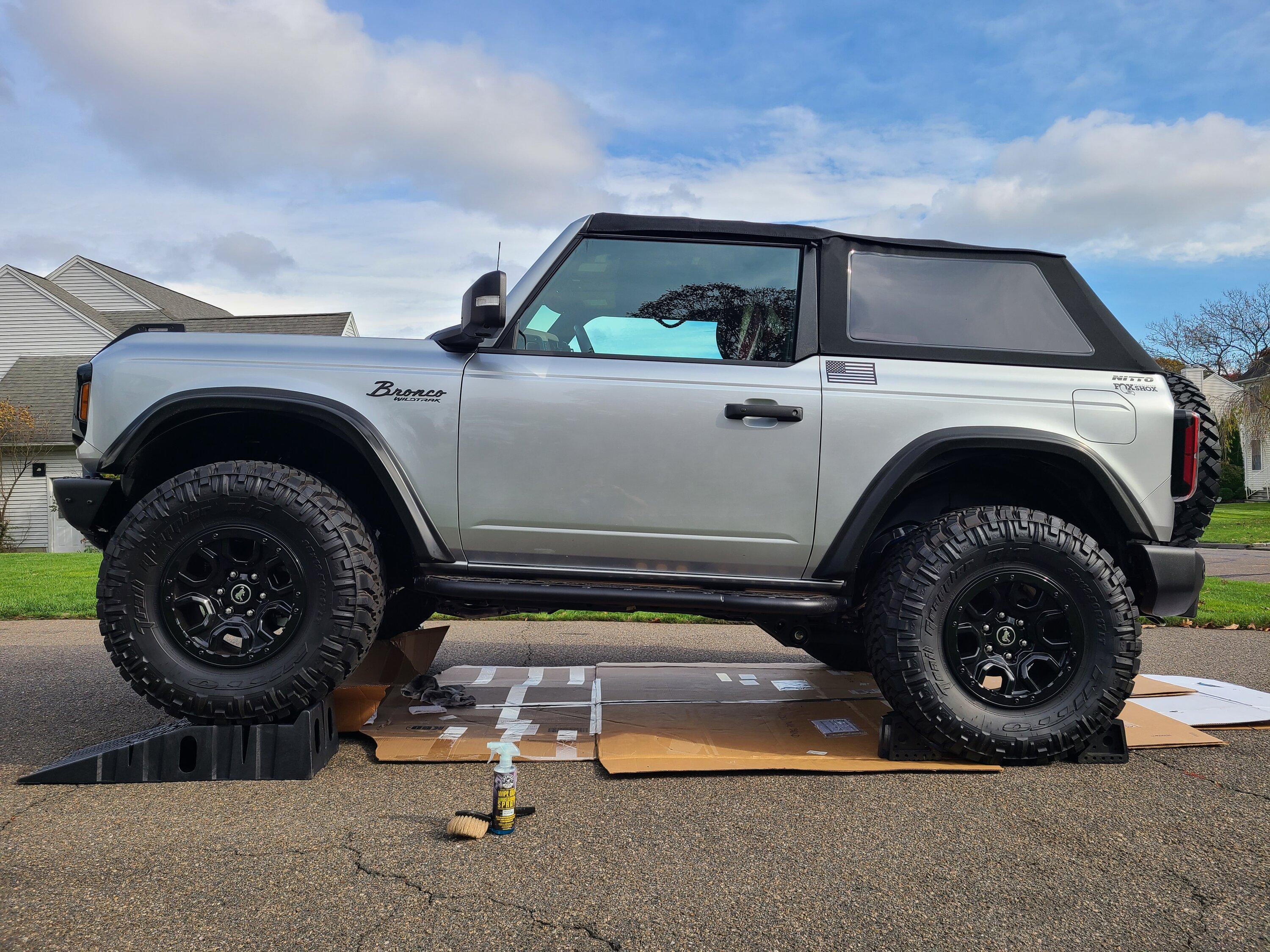

I applied my Waxoyl to the undercarriage yesterday 11/7/23. Went very well. It was only about 50° out and the spray cans worked great. Today I plan on using the wand and spraying inside the cavities. I used ramps on my 2 door Wildtrak and I had full access to everything.

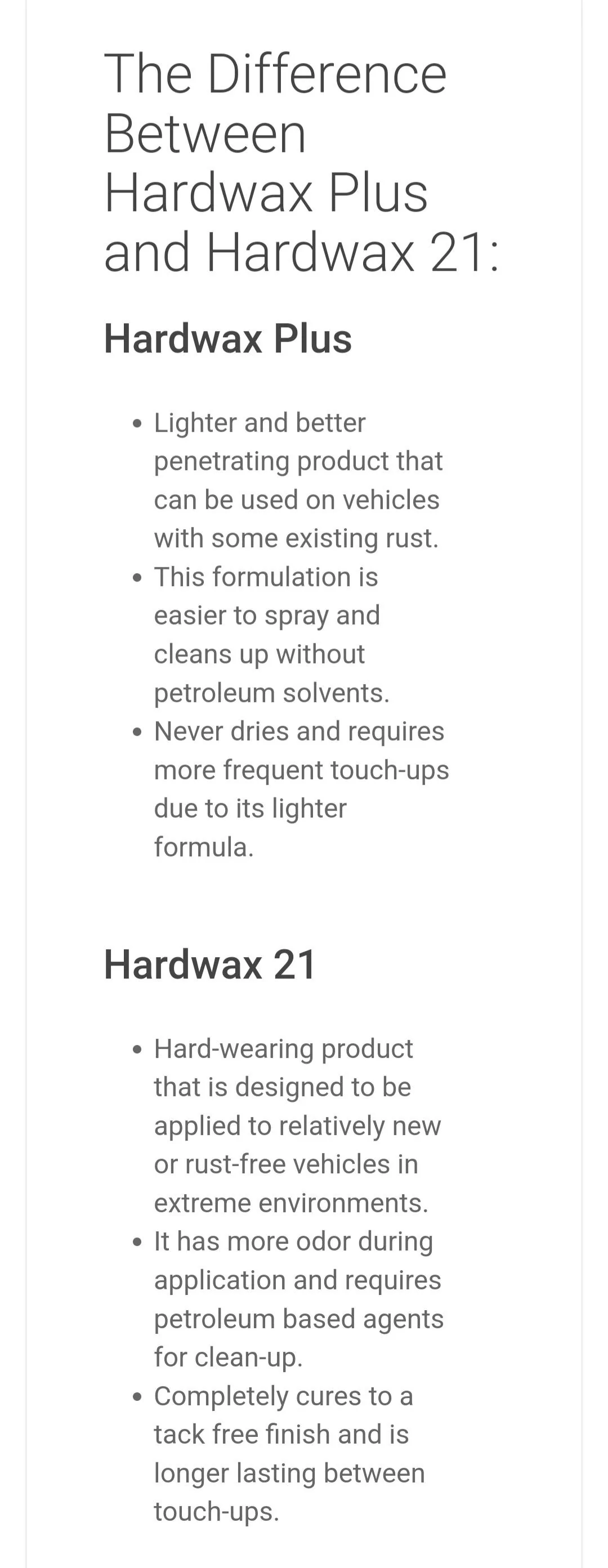

I found this on the Waxoyl site. I guess it will definitely stay tacky. The aerosol cans they send you are the Plus cans.
