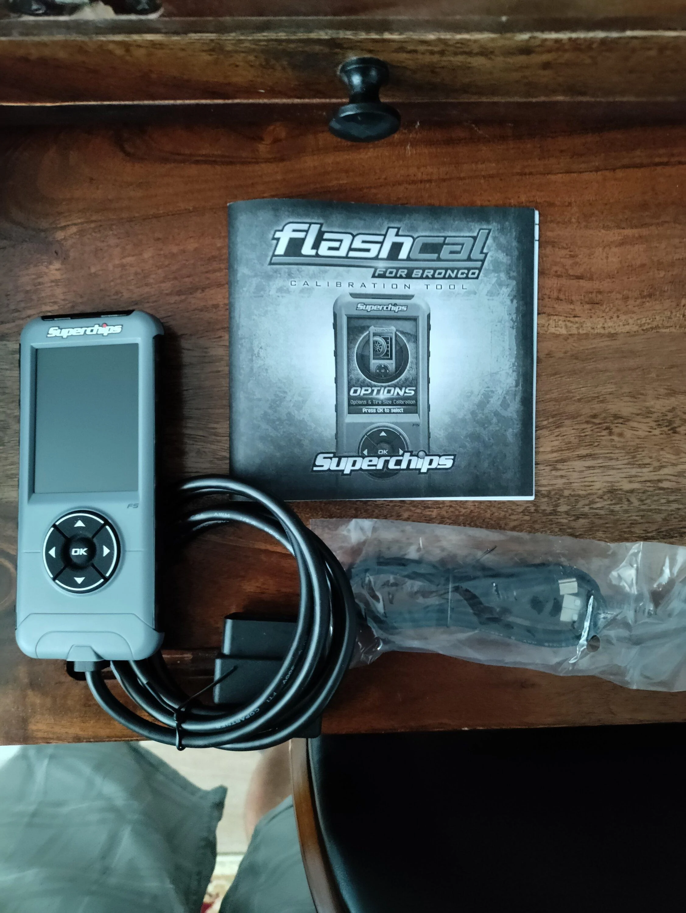

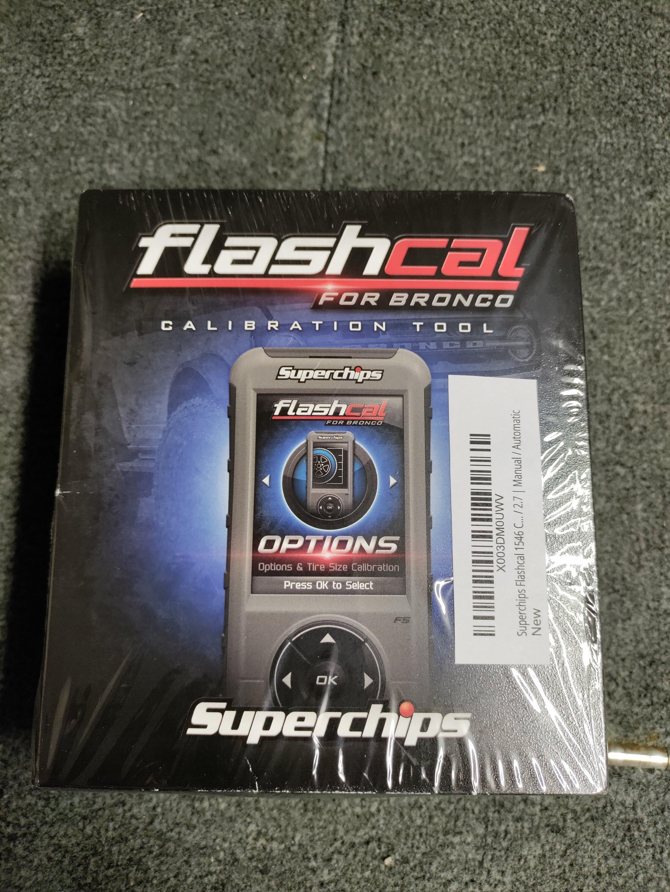

Well I received the SuperChips Flashcal in today. Now I got to go online and perform updates from my laptop to handheld.
Now I can get rid of the double horn beep and change the tire circumference to 37".
