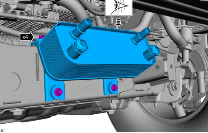

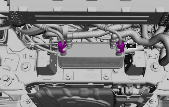

Whats the benifit of installing a cooler ? For daily driving? Does it only benifit when doing towing or long sustained hill climbs?
It looks like its basically replacing the Heat Exchanger? And lowering the temps more than a heat exchanger does? Or is there some baseline temp it maintains?

The advantage of the heat exchanger type cooler is that it will bring you trans temps to operating temp faster. You really need to monitor your temps to decide of you need additional cooling.
