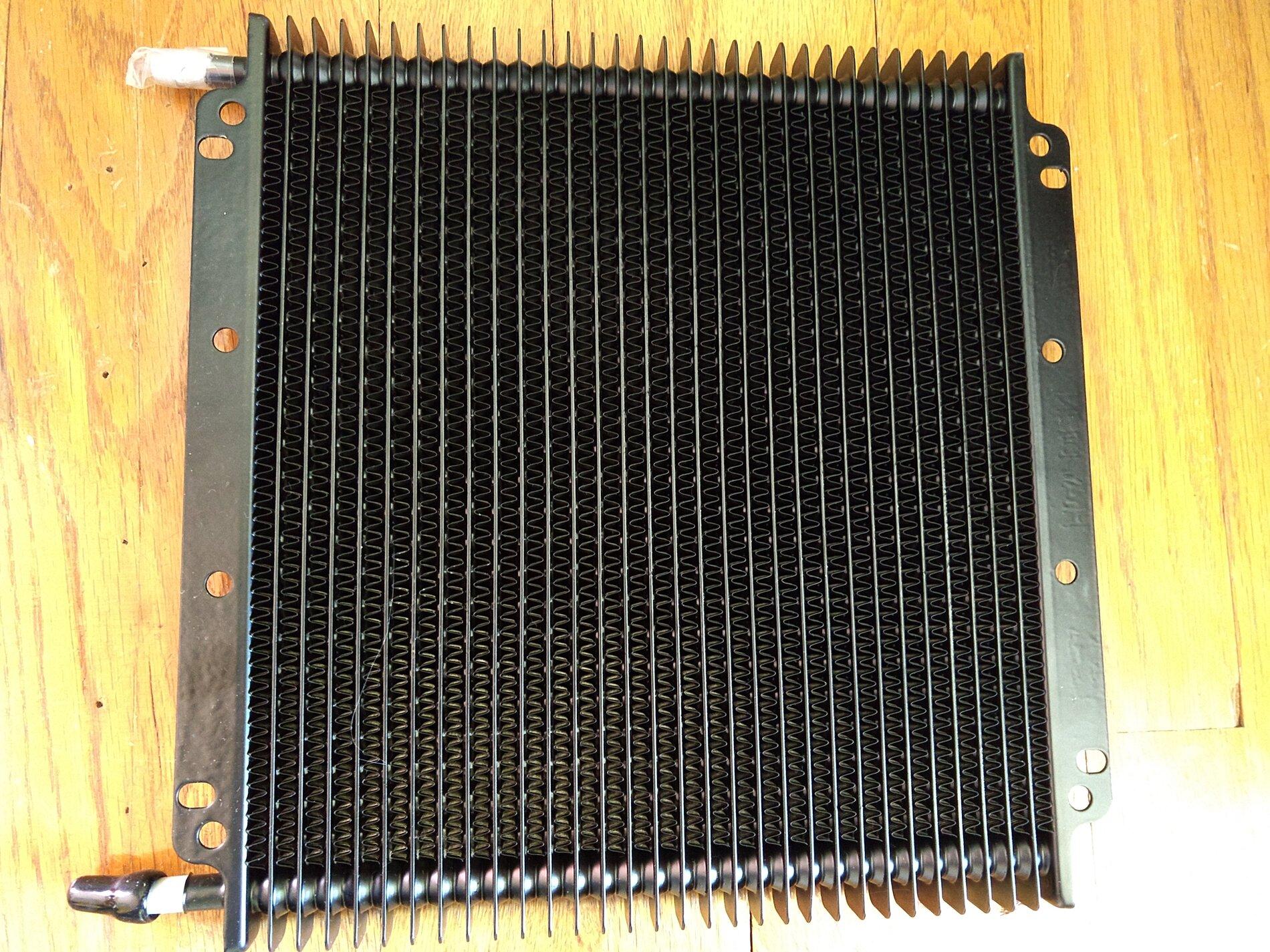

Good question. Unlike some cars, many 4x4s have room in front of the radiator for a cooler. Here is a photo of the cooler I'll be installing in my Jeep TJ, to help protect the recently rebuilt auto trans. I'm a big fan of coolers, every since my CJ auto trans was overheating while off-roading up in the Colorado Rockies..
