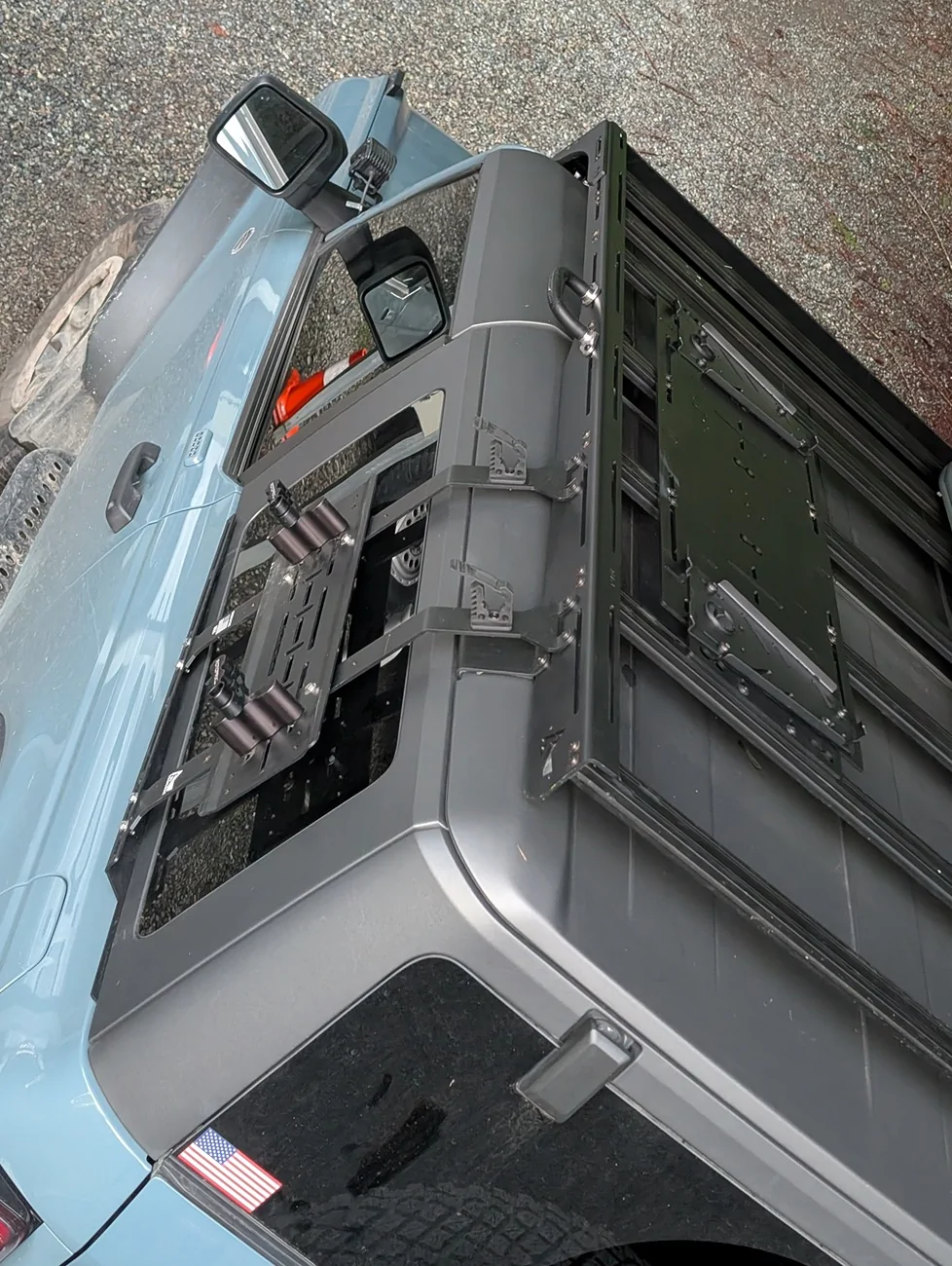

I did a 3 gallon Rotopax on the Pak Rax. With the universal mount plates, you don't need the Rotopax mount plates. I have the large plate on top for mounts to my Leitner box. Sorry for the odd angle on the picture, I took it from my deck.
Edit: I was going to buy some 1/4" aluminum plate and make my own mount plate, but aluminum ain't cheap, I'd still have to locate and drill holes, and then paint it. The powder coated pre-drilled TR plate started looking like a better deal.

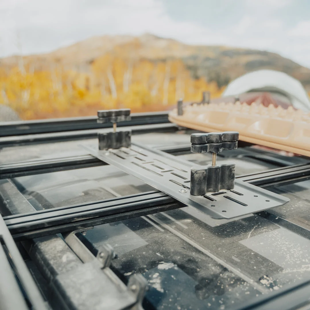

Understand if you are not a fan of our Pak Rax, you can mount 2 RotopaX to the roof using our large mounting deck and the Rotopax DLX mounts, links below. And when you don't need extra gas, you can mount other things to the platform like storage cases, maxtrax, starlink, antennas, and more.
deck: https://trailrax.com/collections/trailrax-accessories/products/mounting-deck?variant=46192848404647
Rotopax dlx mounts: https://trailrax.com/collections/rotopax-accessories/products/rotopax-dlx-mount

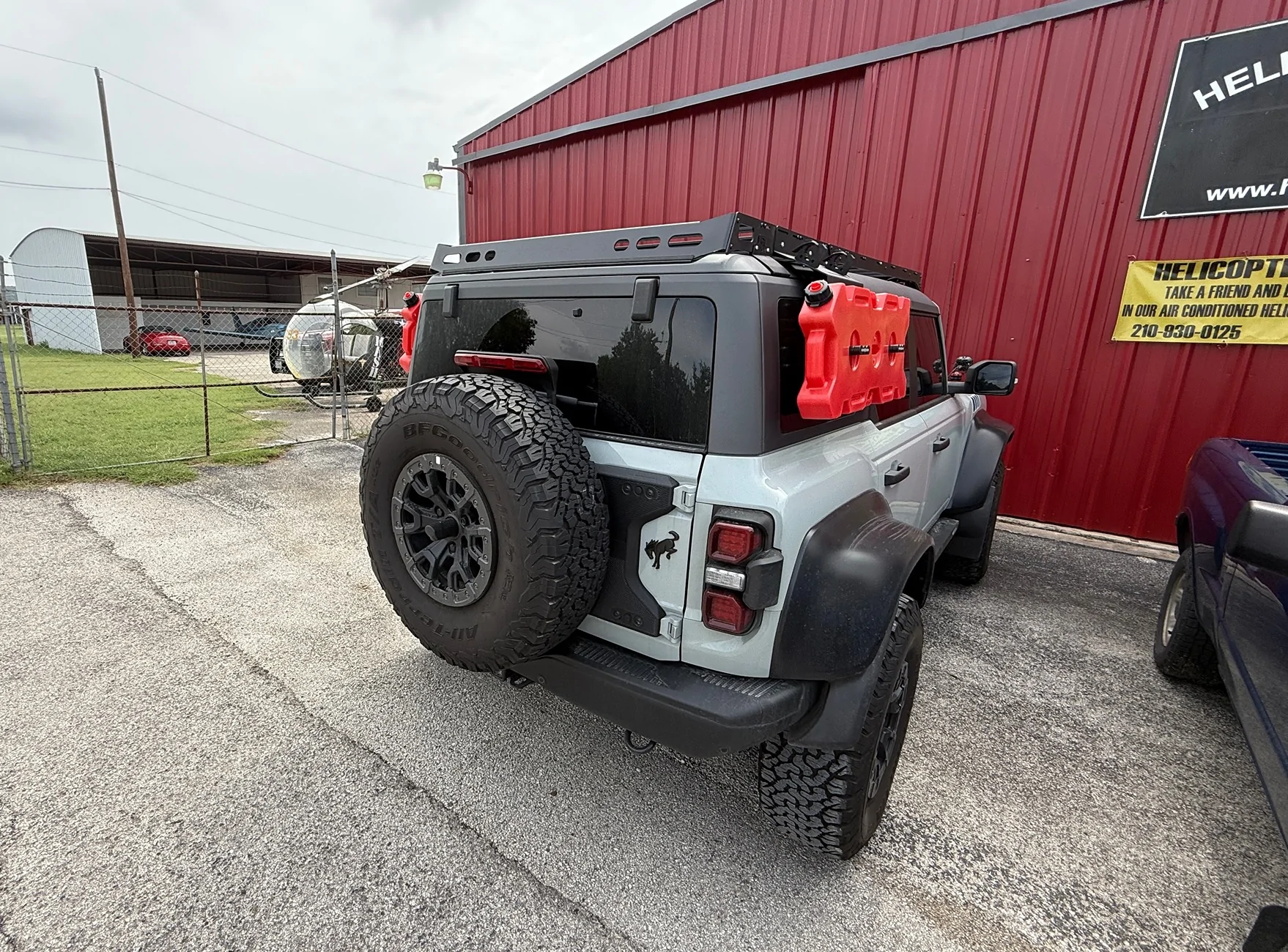

Current Pak Rax Raptor set up

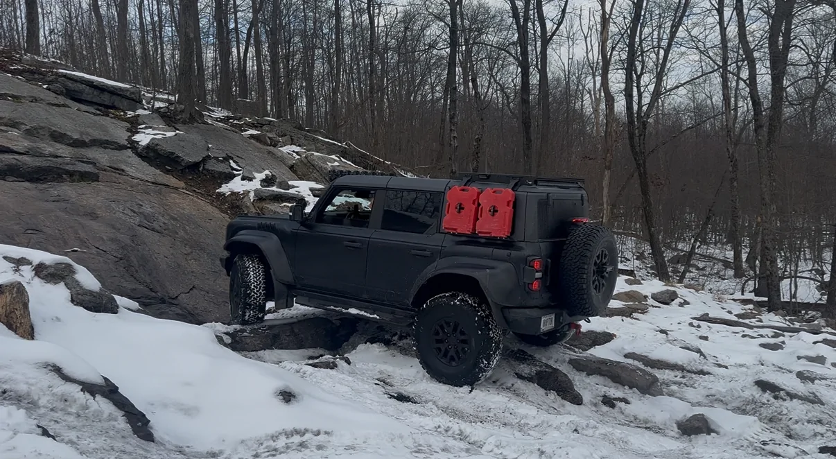

Former RSE Badlands set up

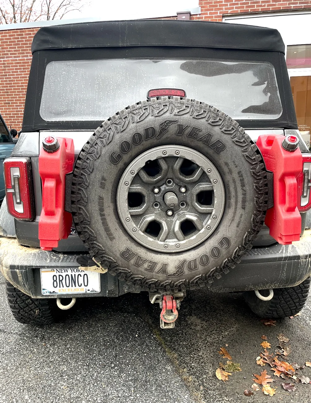

I run the rotopax on the Pack Rax. 4 gallon water on one side, two 2 gallon gas cans on the other side.
