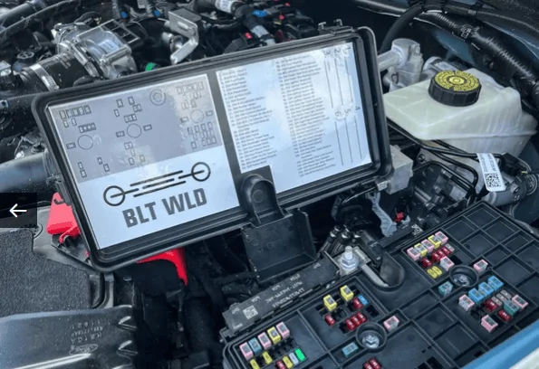

Yeah you can find the fuse box diagrams online.
helifino16
Ron
Aug 12, 2021
2,928
5,072
Mount Sinai, NY (Long Island)
This (from @StickerFab ) has come in handy several times. I've even pulled mine off to refer to other Bronco's.
Ford Bronco Trailer Running Light Issue 1701960072721
They also have one for the Under dash panel.
