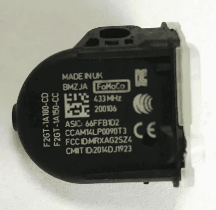

Hello, I bought an extra set of wheels to have one AT and one MT set, but need to solve the tire pressure monitor for the new wheels. I'm from Europe and Bronco is not yet being sold here, and my local Ford dealer is unable to offer me the proper TPMS set... how lame.
Based on this, I see that Bronco TPMS sensors also work with Ranger 2019+. https://accessories.ford.com/products/bronco-5-wheel-tpms-with-activation-tool-kit
Ranger is being sold in Europe and I can buy a set of TPMS sensors for Ranger, but just wanted to be sure if that will work with Bronco Raptor? Here is a picture of what is available here:
Ford Bronco TPMS question 1687433221734
Part numbers: F2GT-1A180-CE, F2GT-1A180-CD, F2GT-1A180-DC, CCAM14LP0090T3, MRXAG2SZ4
Can anyone confirm it will work or provide any kind of guidance? Thank you very much in advance.

Thanks! What you are sharing is running on 315MHz, while what is available here in Europe is 433MHz. Do I understand correctly I need 315MHz sensors?
And if I need them? Well I like to see the tire pressure in the car, and that is the only real reason :)

Experts will weigh in.....but if you purchased a North American Bronco and shipped it to Europe where you admit none are sold it is still set up as NA and the on board module that receives signal from sensors will be on a NA frequency.
But then again the Raptor may use different sensors than my 21 OBX for which those fit.
Yes, you will need the 315MHz sensors for the truck to read.
