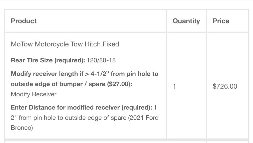

For my new Bronco (with aftermarket Curt hitch) I bought a very unique tow hitch trailer from Mo-Tow. It tows the motorcycle backwards, so no strain on the drive train. It can handle a much bigger bike, since only half the weight is on the tongue.
Ford Bronco Towing a motorcycle? 1647108530308
https://motowus.com/product/fixed-tow/
I bought the fixed version, which exactly matches the trailer hitch height of my 2021 Bronco Black Diamond with 33" tires. I specified a custom distance of 12" from pin hole to outside of spare.
For Hitch Heights 16″ to 17″ – Travels 12″ – Weighs 35 lbs. Rear Wheel Tow Hitch Safe for Drive Shaft 600 lb. capacity – Pivots 150 degrees.

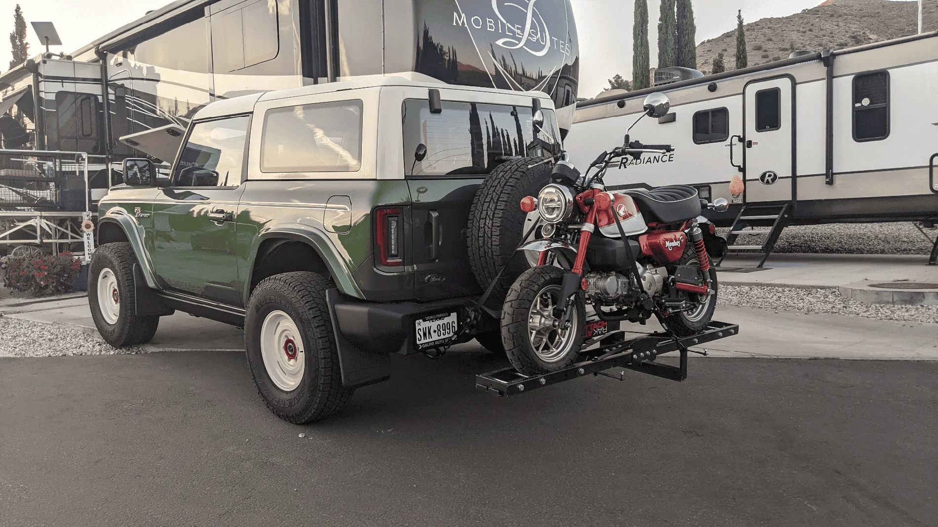

I got this and love it.
Ford Bronco Towing a motorcycle? F1FC4B84-FEEC-47B8-9815-B692147255CB
Ford Bronco Towing a motorcycle? 10FBB98A-3752-46A3-859D-B6E691FBB709

I got the fixed version for my BD with 1" level and 33" tires. I measured first and it is perfect. They have version with more adjustment (for an RV) that can handle more height. Sasquatch probably an inch or two over mine, but might still work with fixed. Adjustable can handle any height!
You also have to measure extension beyond spare tire but they customize.

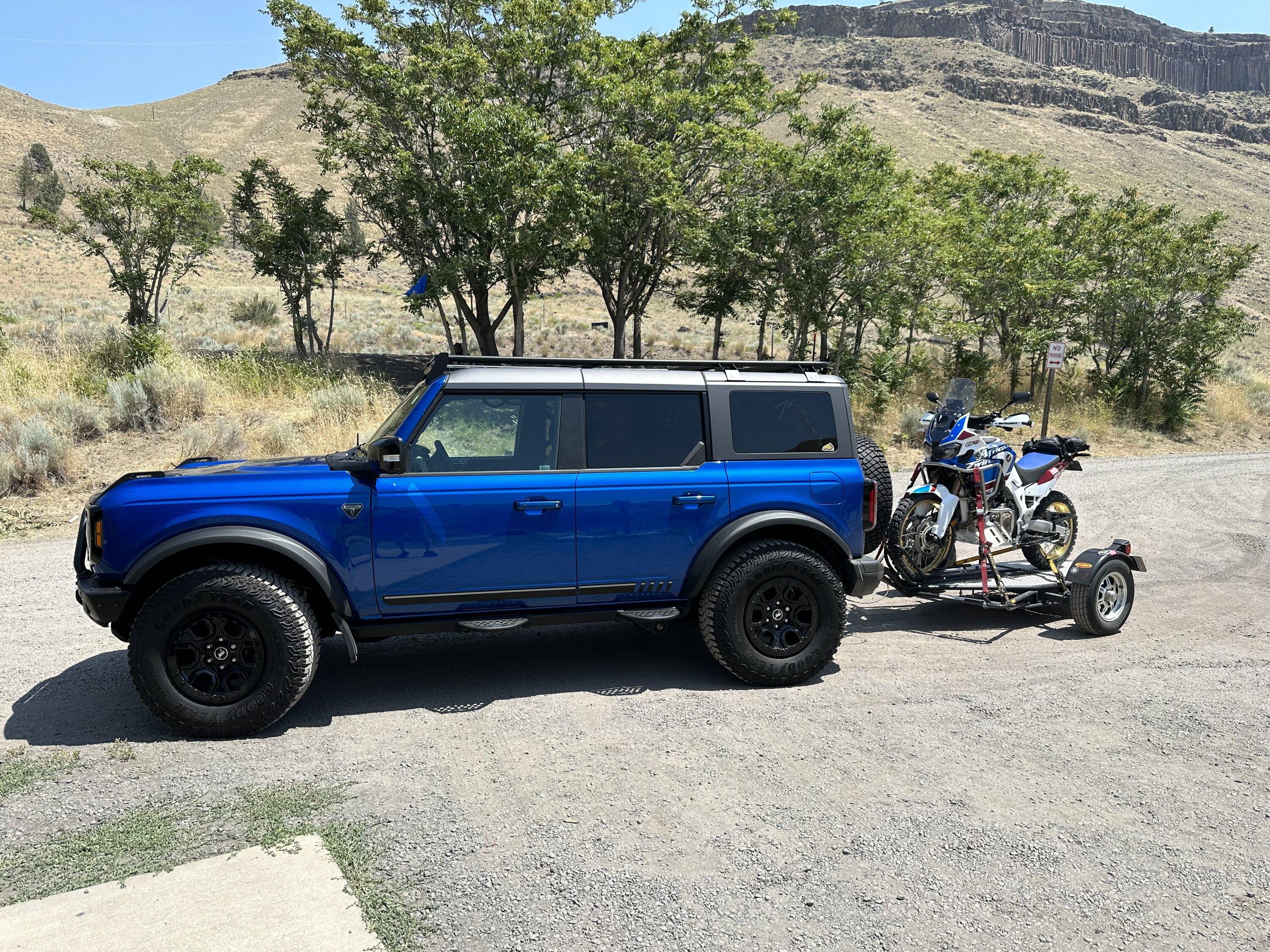

I may not know much........but this is how I'd tow a motorcycle. They make three rail versions of this single rail (folding and stand up) trailer.
Ford Bronco Towing a motorcycle? IMG_5753
Ford Bronco Towing a motorcycle? IMG_0020
Personally, I looking into a hitch trailer and unless you do a rear wheel carrier delete you're going to be at the limit for just about anything (even with a sub 300lbs Moto). Yeah, I'm sure the experts on here will tell you otherwise but I've been witness to several trailer and tongue hitch disasters.
