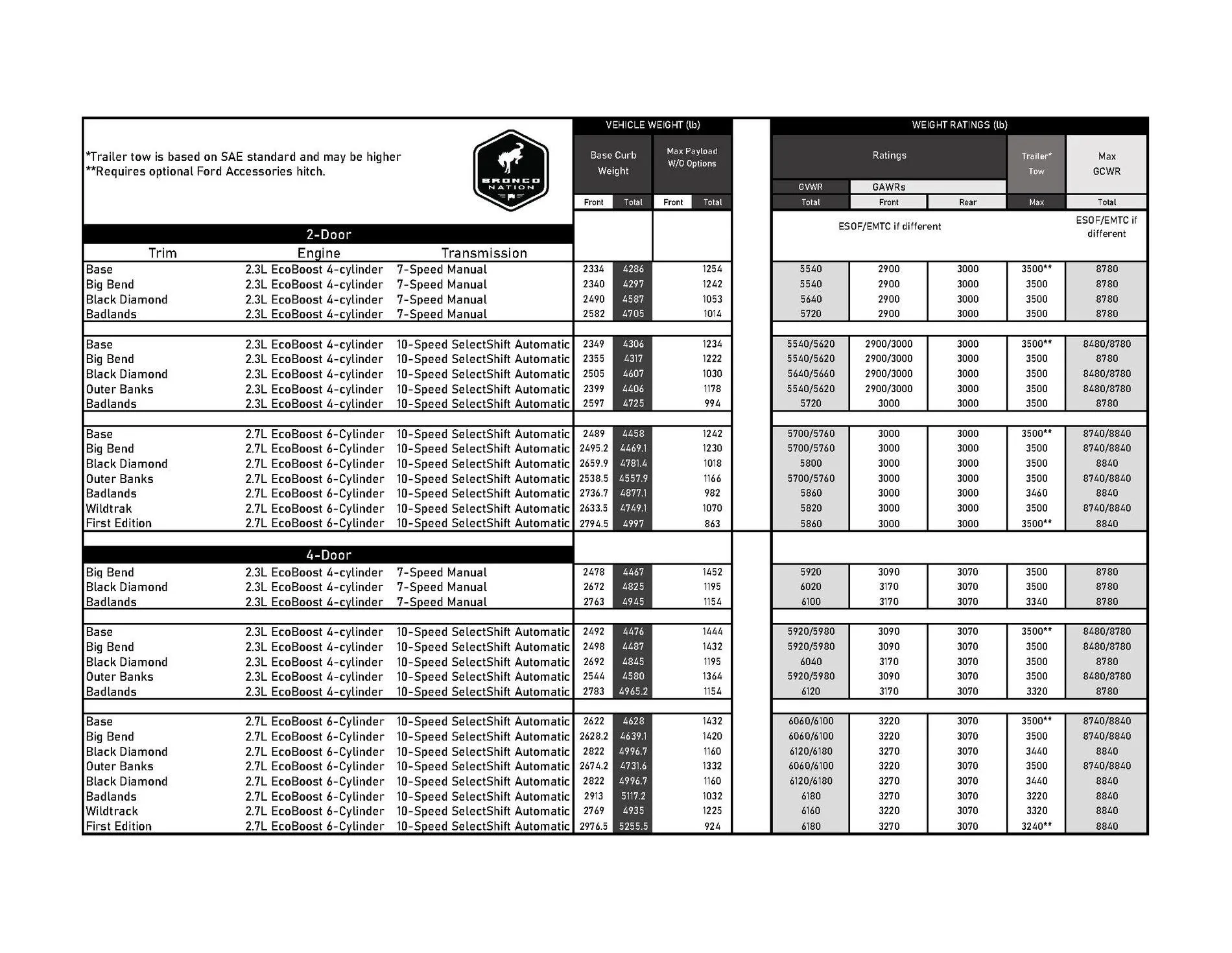

Glad to hear that you're only planning on having one person and some luggage in if you're towing at the max. You only have ~550lbs of weight that you can put in the Bronco until you're hitting GCWR.
Ford Bronco Towing 3500lb with the 2.3L Engine? GVWR Details (with Wildtrack)

Thanks - I had seen that before and forgotten about it. It looks like the BL 2D actually has a 40lb. lower tow rating with the 6 cylinder than the 4, but the 6 cylinder has a 60lbs higher GCWR than the 4. So I guess that is better if I pack more weight in the cab, which I probably would with generators, etc. Probably better if I have to come to a complete traffic stop, start again when hauling something up a pass, etc. I went ahead and ordered the 2.7L just because it actually shows better highway fuel economy than the 2.3L on the BL non-sas. Not sure if those numbers are correct, but it essentially shows that they have almost the same fuel economy so hard to pass on the 2.7L

Keep in mind though that the 2.7L has a 150lb higher curb weight than the 2.3L, so the 2.7L allows 90lb less of total trailer and cargo weight than the 2.3L does!
