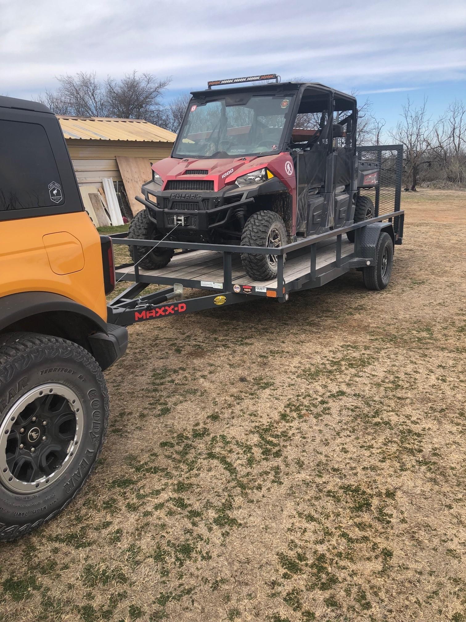

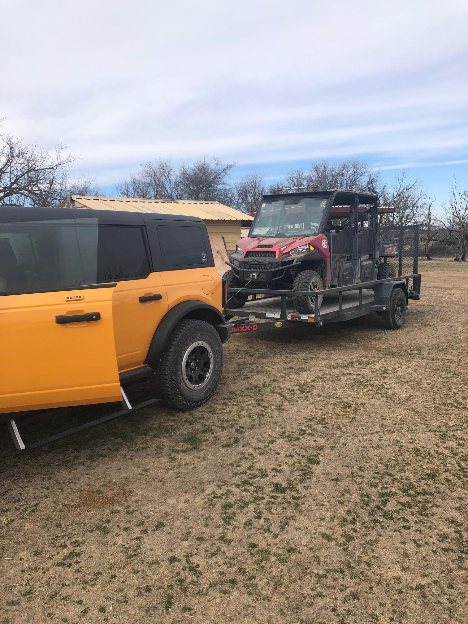

I have towed my Ranger around on this single axle trailer for several hundred miles with no issues at all. The weight of the trailer with the Ranger is right around 3,500-3,600#s. Badlands, 4-door, 2.7, sqatch.
Ford Bronco Towed 6x12 cargo trailer with ease! Bronco a
Ford Bronco Towed 6x12 cargo trailer with ease! bronco B

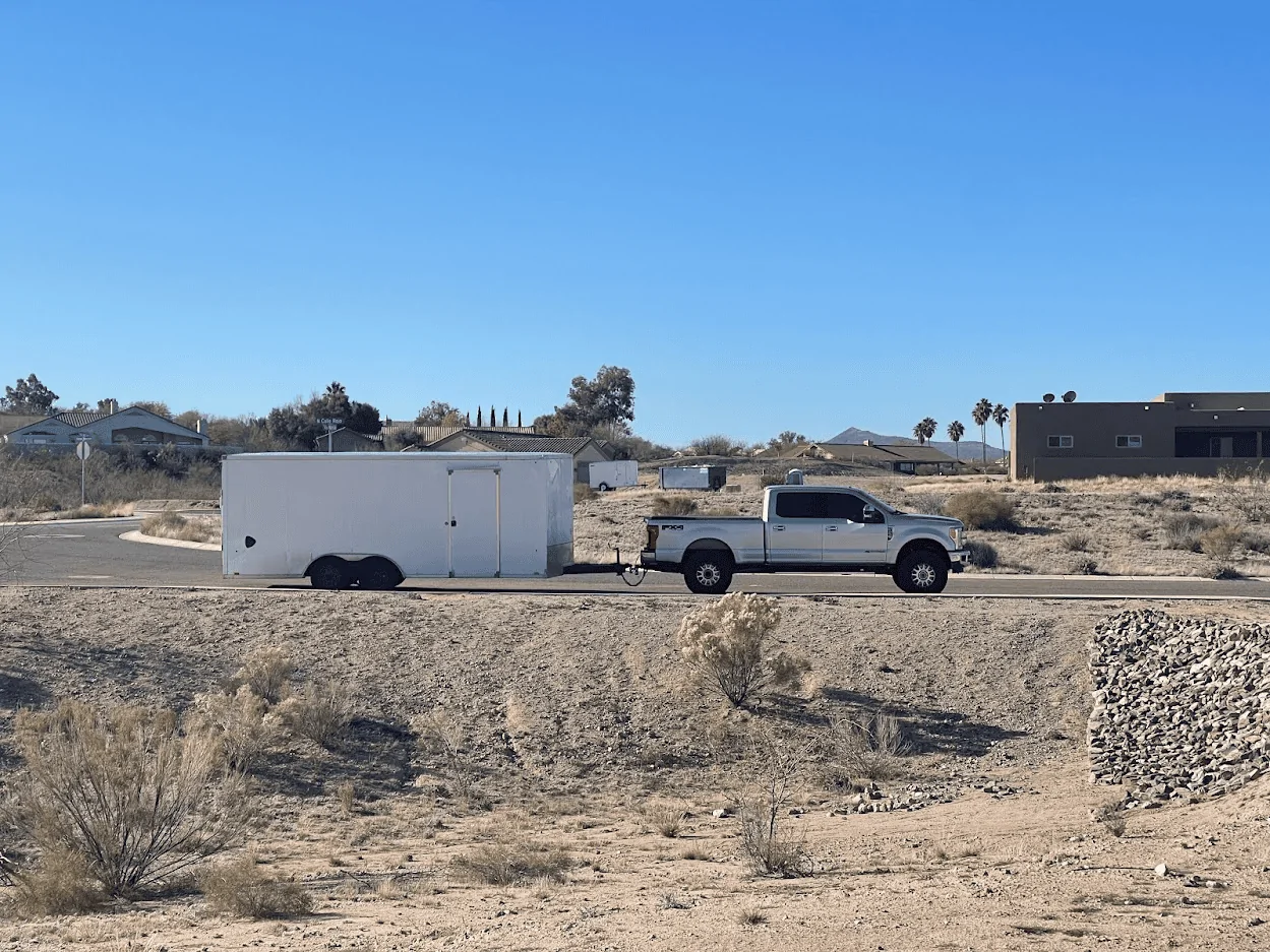

I/We have a toy hauler and it's not heavy. 5200 dry. 9k loaded with water and our RZR. I towed it for about 6mo's with our old Tundra. It was within capacity and towed fine but got tossed around in wind. This was properly setup with a WDH and sway control.
We bought an F250 6.7L and it's night and day. Stopping/wind/hills does not matter.
I did 700mi towing over the weekend moving the MIL from SoCal to AZ. Rented a 20ft enclosed. We had insanely bad wind on the way back (unloaded). I would not even think of towing a small enclosed with our Bronco in that same situation.
I live in the land of seeing overloaded 3/4 ton trucks towing monster 5th wheels. I just shake my head.

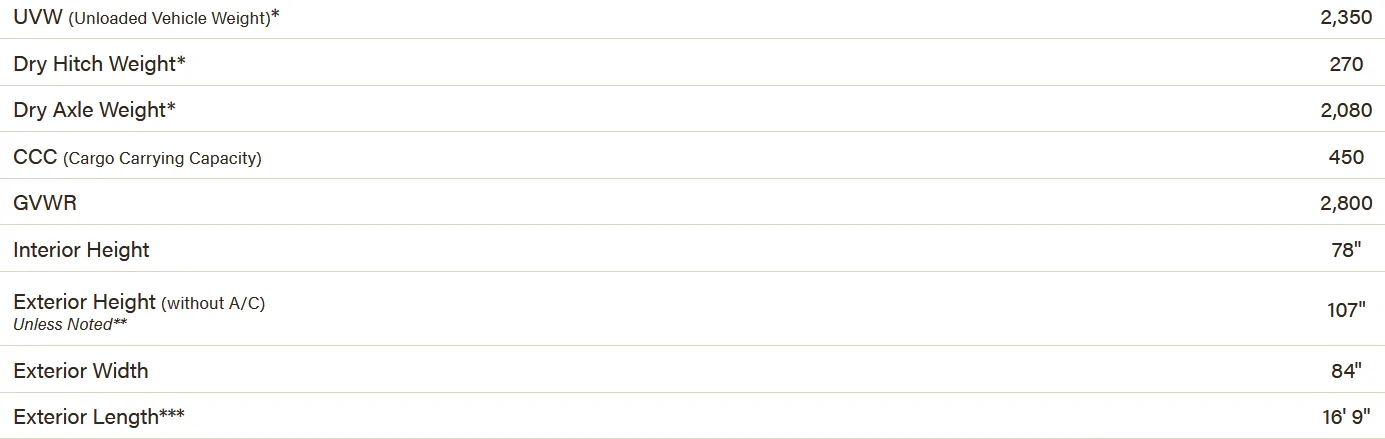

I'm reading this post and have some basic questions...hoping to get some good advice. I haven't towed much.
We are thinking about getting a small camper to tow behind my 2D manual base. I would need to add a tow package and see some of the options and the comments.
Beside that we are looking at the following trailer...KZ Sportsmen Classic 130RB with electric brakes.
