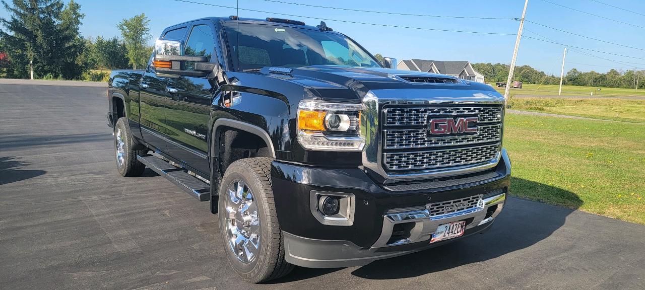

What we tow our gooseneck 4 place horse trailer with...lol
