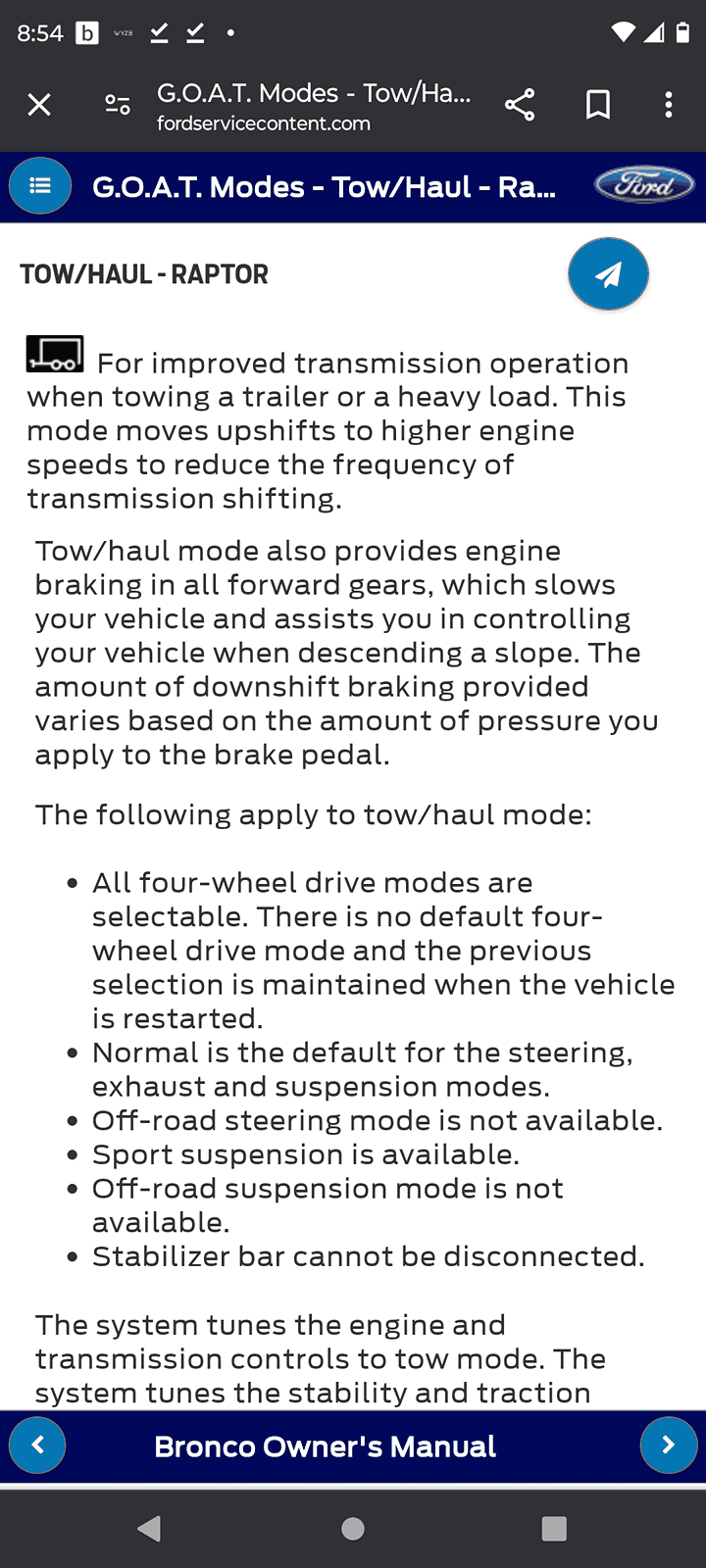

Raptor only, assuming you're taking about the GOAT Mode
