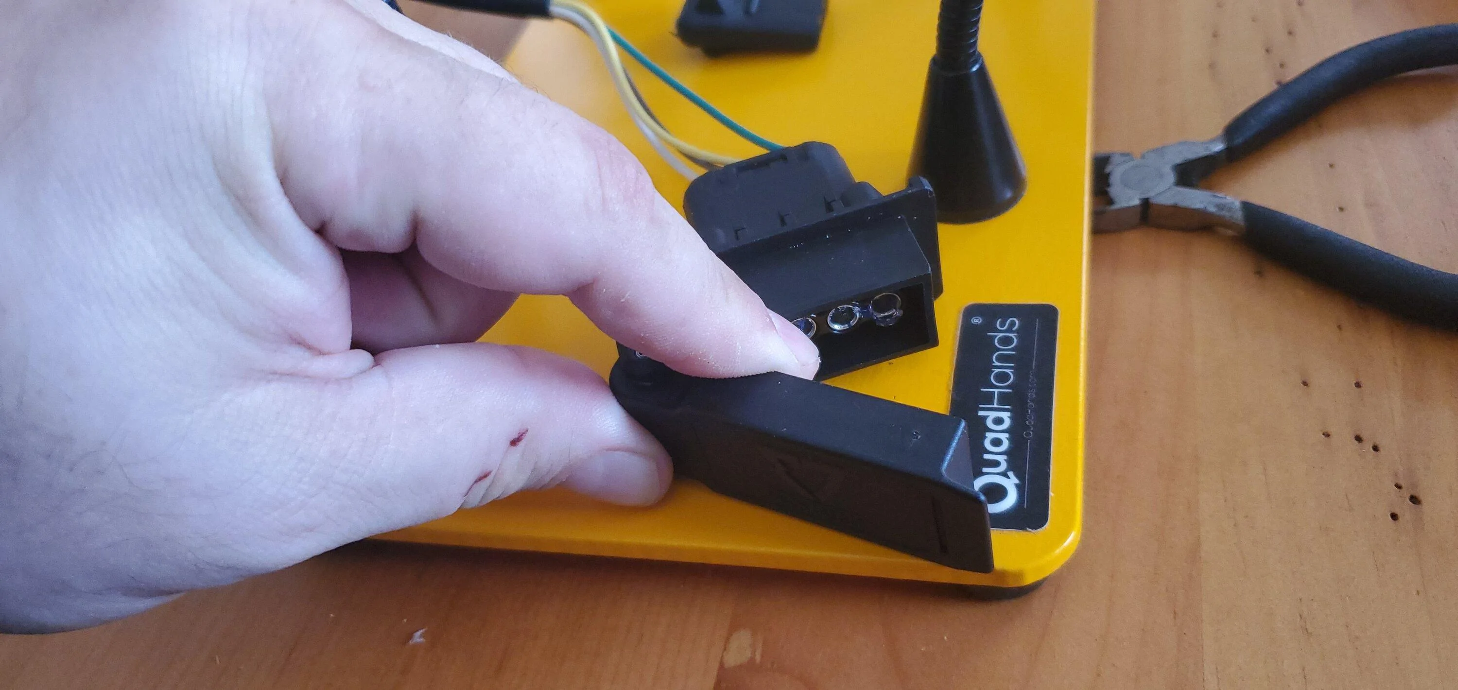

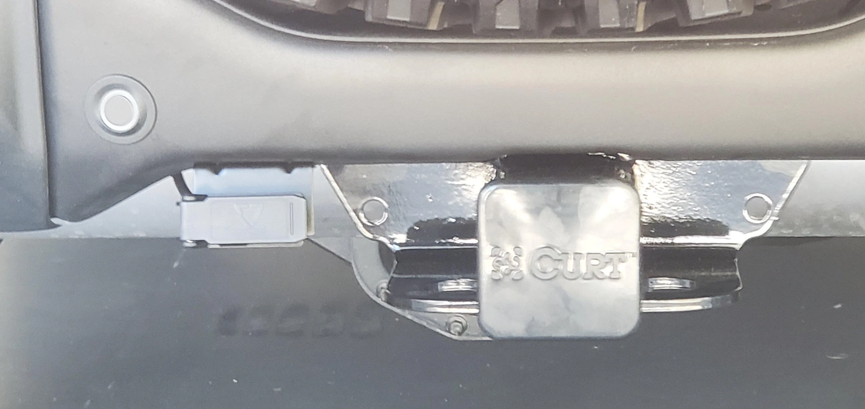

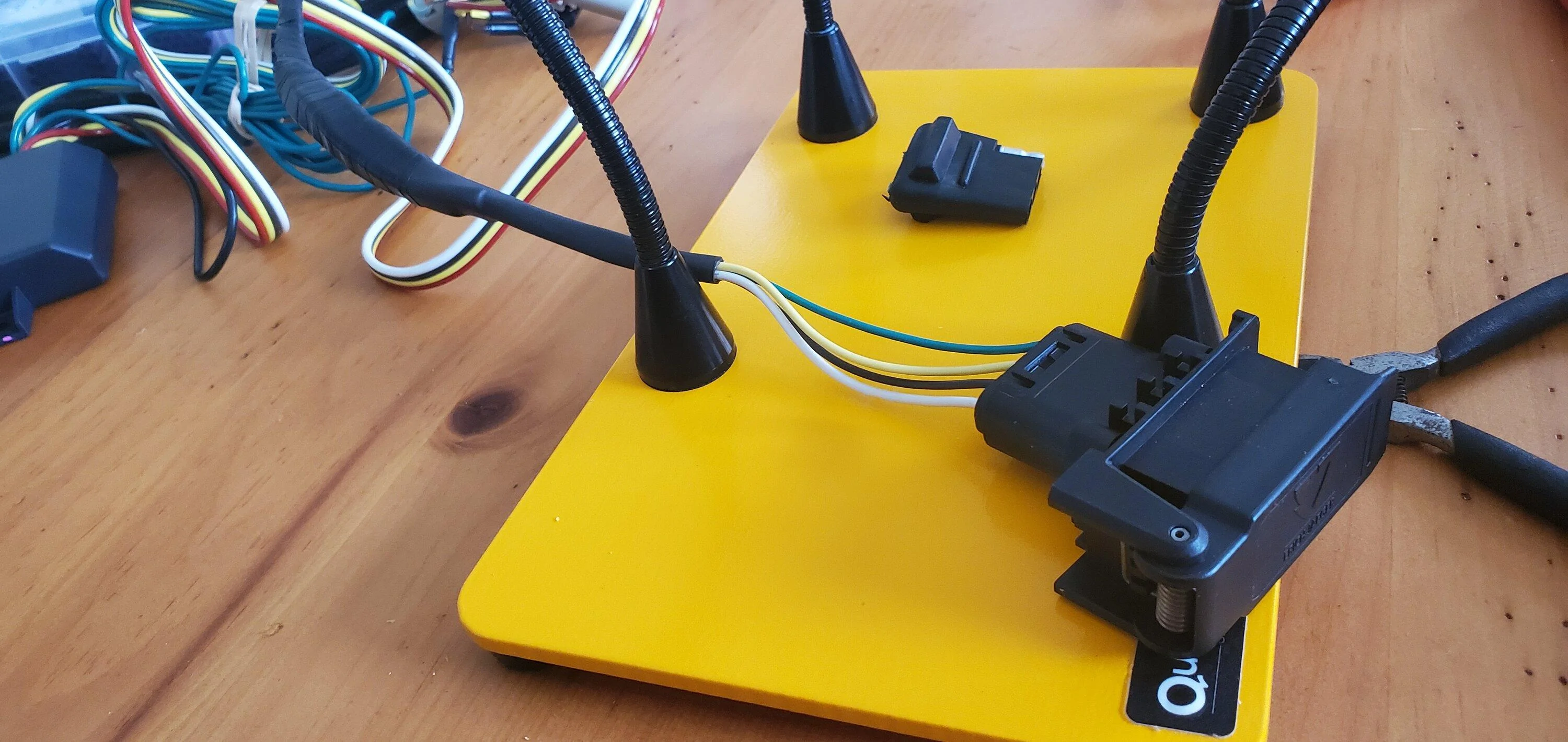

I used the Curt hitch and Curt harness, the plug into taillight connections made wiring neat and simple and the extra power wire terminals at the battery make hooking up the power wire simple. The most time consuming part was putting the nylon protective sleeve over the long power wire lol.
I see people not using Curt hitch due to no 4 pin slot but I wanted something better than just a slot the 4 pin sits in so I used this setup which is a metal 4 pin mount with spring loaded closing cover. It comes with a bracket that I was able to screw into the metal lip on the bottom of the bumper using the supplied self-tapping screws. I cut the 4 pin connector off the Curt harness and soldered on the weatherproof 4 pin connector that came with the 4 pin mount. It plugs into the back of the metal mount with a weatherproof connection and the spring loaded cover keeps things out of the front where the trailer plugs in.

🤔 I wonder if can try to work around this somehow. I’ve got the ford hitch, as mentioned before, mainly due to being able to use my pass points. I have the 4 point mount obviously, but I really like that dust cover idea, that makes it look a lot cleaner and is functional. I wonder if there is some way I can make that work on the Ford harness. I have to keep the ford end, due to it being molded to match the mounting bracket. Do you think that cover would fit the ford 4 pin end? Or could I buy it separate to fit ?
OR maybe I can use the ply and play harness with the Ford 4 pin end and dust cover.
You pretty much have to use the 4 pin connector end that comes with the cover. The cover has a 4 pin setup molded into it and the connector that comes with it plugs into the back of that using a weatherproof style connection, so the trailer side plugs into the pins molded in the cover and the vehicle side 4 pin connector that comes with the kit plugs into the back, if that makes sense.

I believe I answered some of my question. Turns out they make universal dust caps, so that is simple. My main question is, can I attach the ford 4 in end to the plug and play harness, to make things easier. So all I would have to do is purchase the ford harness and the plug and play harness. Cut the ford 4 pin head off and attach it to the other, get the benefits of having the mount for the 4 pin, and the plug and play for the rest of the wiring.
$125 is a lot to spend just to cut the end of from the ford wiring harness though.
If you aren't using the cover I used, I don't see why you couldn't use the Ford 4 pin on the Curt plug n play harness, just use the appropriate sized solder sleeves and some shrink tubing. Afterall I cut the 4 pin off the Curt harness and installed a different 4 pin and it works fine.
