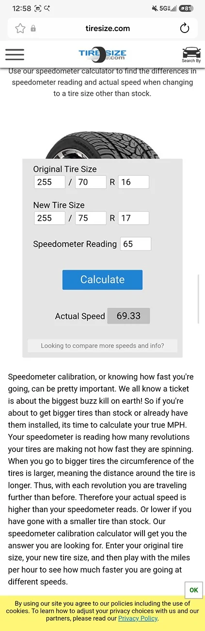

Showing 65mph, you'd actually be doing 69.55
Ford Bronco Tire Size help Screenshot_20260726_005821_Samsung Browser
