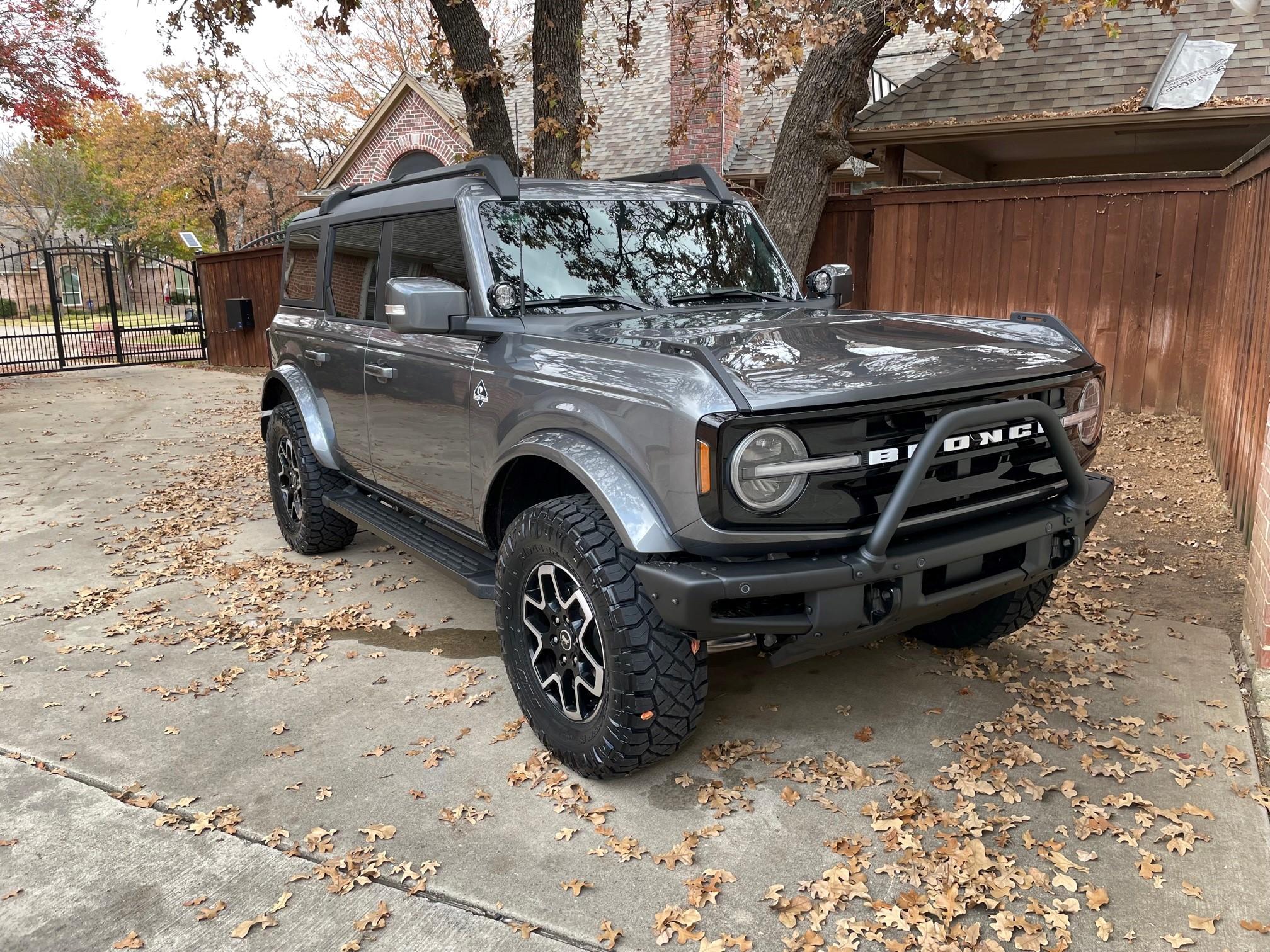

Hoping someone can tell me if this combination will work without rubbing. I am looking at Vision Ojos 350 18x9 +12 wheels and Nitto Ridge Grappler 285/75r18 tires for my Outer Banks Bronco and I will be installing the Zone 4" adventure series lift. Thanks in advance.
I have a 1" leveling kit on my Outer Banks, with 305/65/R18 Nitto Ridge Grapplers on factory wheels. No issues whatsoever. I would imagine a huge 4" lift like you are doing would be fine as well if you remove the crash bars for that extra inch of tire height.
Looks amazing! You didn't have to remove crash bars? Just the level?

Correct. Crash bars are in place - only added the 1” leveling kit.

I was originally going to do the 285's but this has me sold. Thank you sir.
