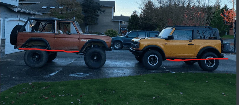

Excellent comparison. The tires, hood, roof are all about the same height, but the 6G has an extra foot of stuff hanging down low. This makes it fantastic onroad and offroad at high speed, but is a huge handicap going over boulders.
It is an excellent comparison but you're looking at it wrong. Who cares where the hood is, you're not getting hung up on the hood.....
At the center of the belly, there really isn't anything that hangs below the bottom of the frame on both. So lets look at where that is (approximately where the red lines are). The frame rail on the B6G is a lot lower which means it doesn't have as much suspension lift.
That EB probably has 6" of suspension lift. Put 3" of suspension lift on that SAS Bronco and I bet they look a lot closer.
Edit: Now that's gonna mess with you center of gravity. Personally I like the fact that the B6G has a lower CG, helps with stability off camber. The drawback is lower belly clearance.

My EB has a 3.5" suspension and 2" body lift on 36's with some healthy fender cutting. Pretty run of the mill build required to clear 35-37" inch tires on a Bronco.
The comparison TrickyDick is making is about wheeling with other vehicles on similar size tires. The 6G faces significant clearance issues.

My point is a suspension lift fixes what he's complaining about. The fact that you can put 35s on a B6G without putting as much lift is a BENEFIT, not a negative. It keeps the CG down.
If you wanna go over boulders and not get hung up on your belly: LIFT THE SUSPENSION so the bottom of the frame rail is higher. It's simple, that's it, that's the answer.

Right. If you enter a competition they class you by tire size. A Bronco on 35s is going to be at a disadvantage to everything else on 35s that had to be lifted to put them on.

Lifting it by relocating the front diff and control arms lower could help but you also run into the IFS not flexing as much and adding a high CG when it already is tippy going down ledges is not a smart way to do it.

The B6G has a lower center of gravity by design, this is a feature, it helps with stability at speed.
Lift the suspension and you get your greater belly height for boulders. Zero of those Jeeps were stock, the EB's certainly weren't. I don't understand why this is so difficult a conclusion to come up with.

There are drawback and there are benefits. The main compliant here is the belly clearance, which is very easily fixed. I would also pair that with some wheel spacers to get a little more width to offset some of that loss in CG.

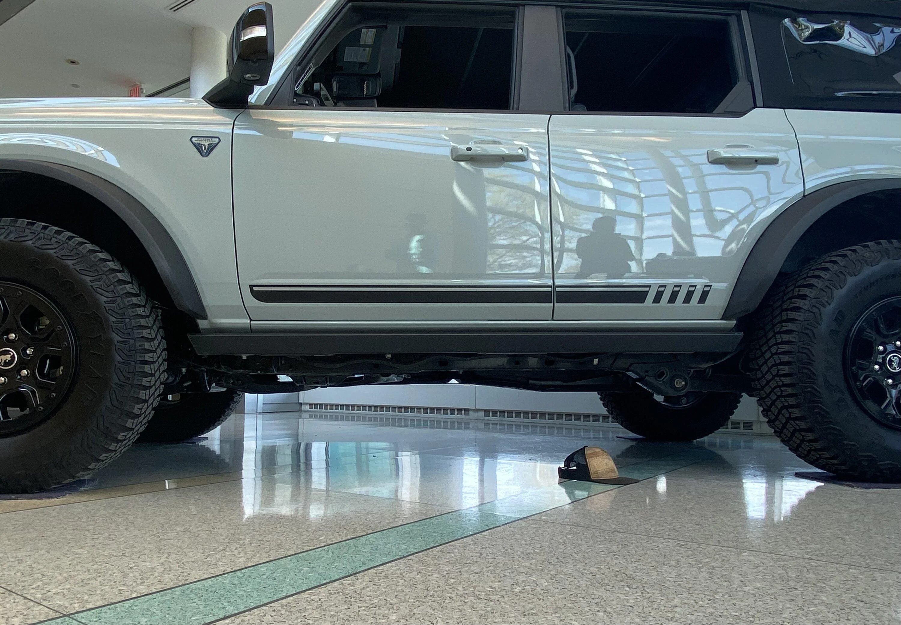

Huh this doesn't look like it'd be much a problem at all. I'm a total novice when it comes to rock crawling, but we went over much bigger obstacles then this at the Bronco Off-Roadeo in Nevada
I’m not disregarding your experience because I know they change routes from time to time, so take this for what it’s worth. My experience at the Nevada off-roadeo course was primarily down hill through the “rough” stuff. They strategically avoided going up anything challenging. To be clear, I'm in no way dogging the event as I thought is was well worth going to and really enjoyed it. However, they had to carefully plan a route that was conducive to many newcomers to off-roading and I feel like they did a great job accomplishing that…the end result just so happened to be a course tailor made to show the strengths of our broncos and kind of avoided the weaknesses.

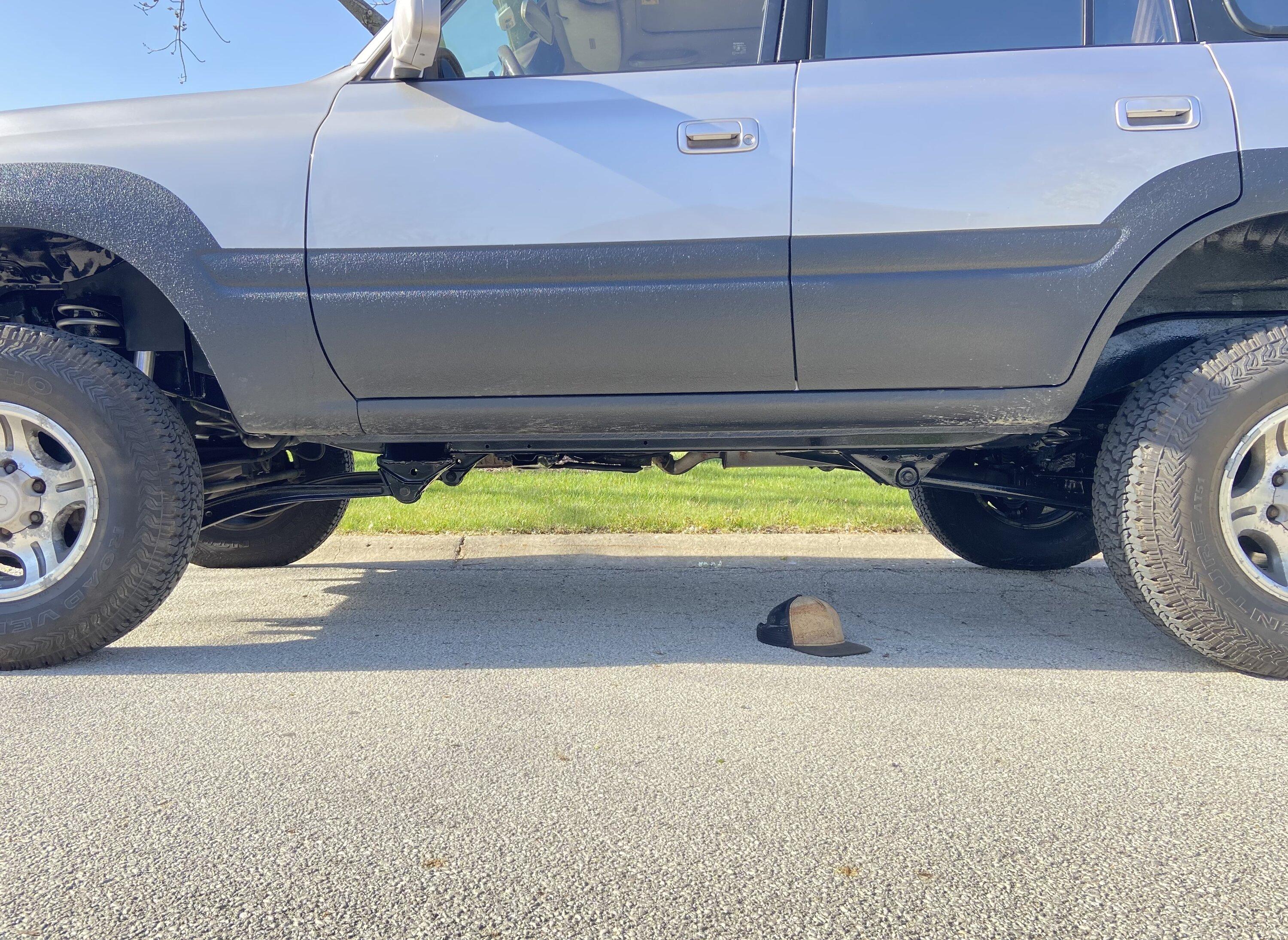

Agree with trickydick. That’s an fj80 with 3” lift on 31s before it got 35s. Not even close.

It's not a difficult conclusion, you're just stuck on your point of view.
The fact is 6Gs have less ground clearance than anything else on 35s you're likely to encounter on the trail and increasing that ground clearance will worsen it's other positive attributes.
A stock TJ on 33s blew through that area.
