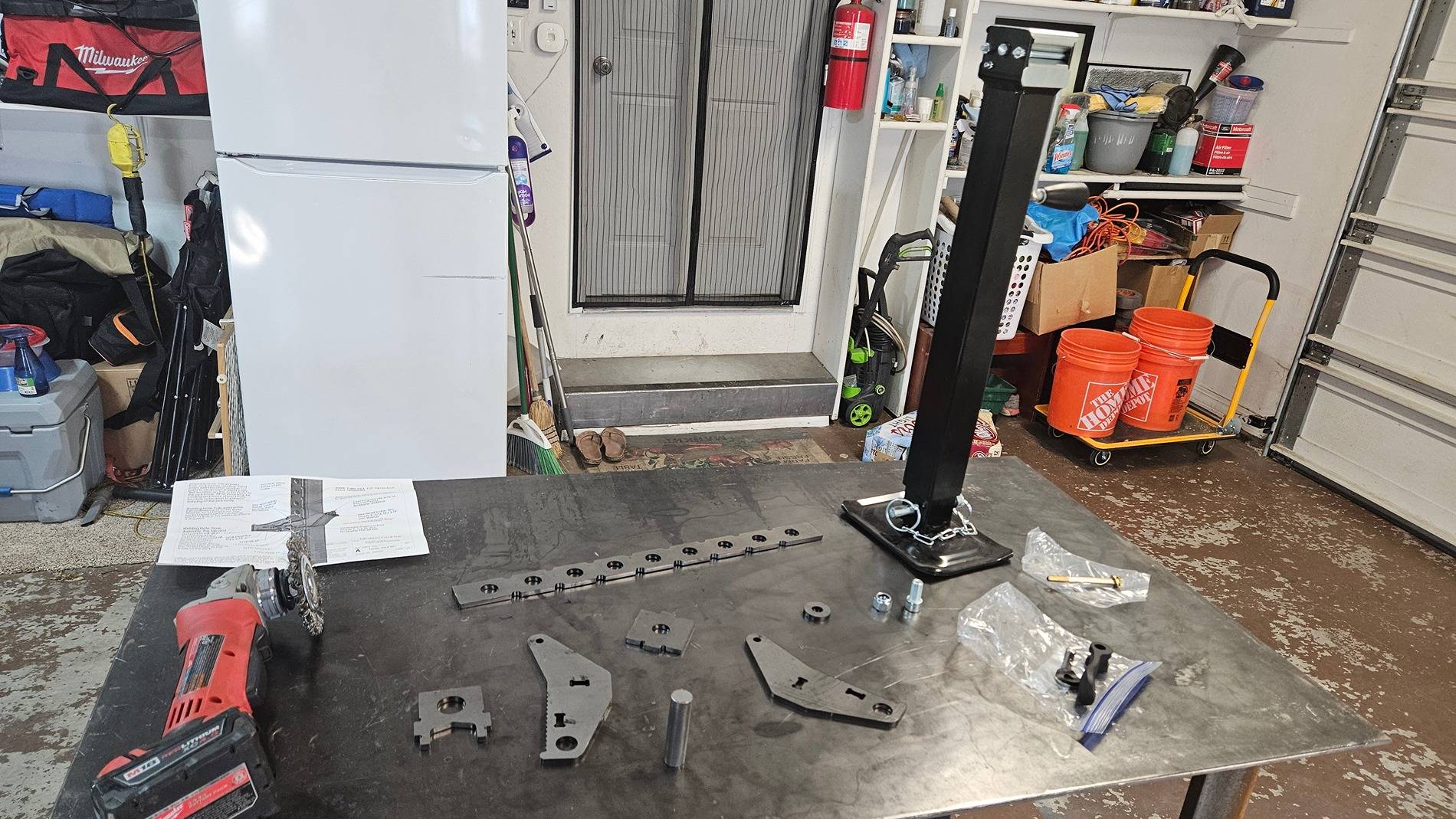

A while ago I was watching YouTube and came across a video about the Tauler Jack.
After watching that video I ordered the jack from Amazon and the kit from Brennan's Garage.
Ford Bronco Tauler Jack 20241026_124254

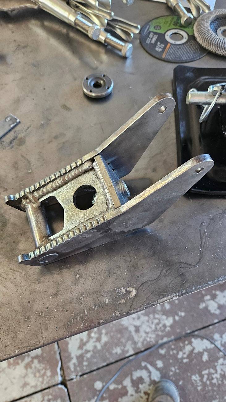

Nose Assembly

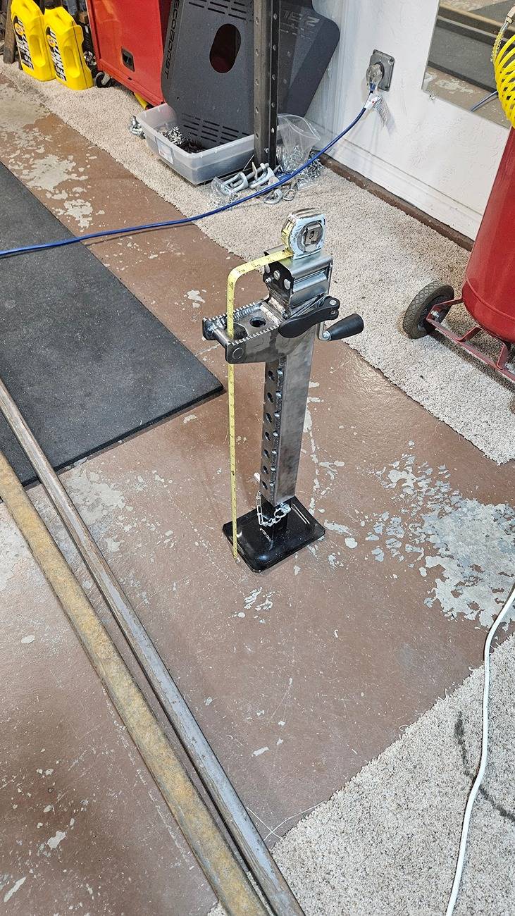

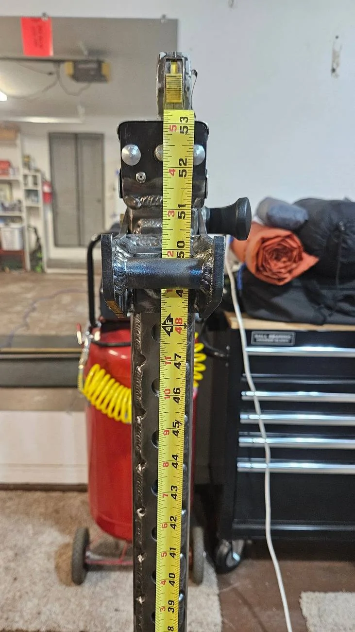

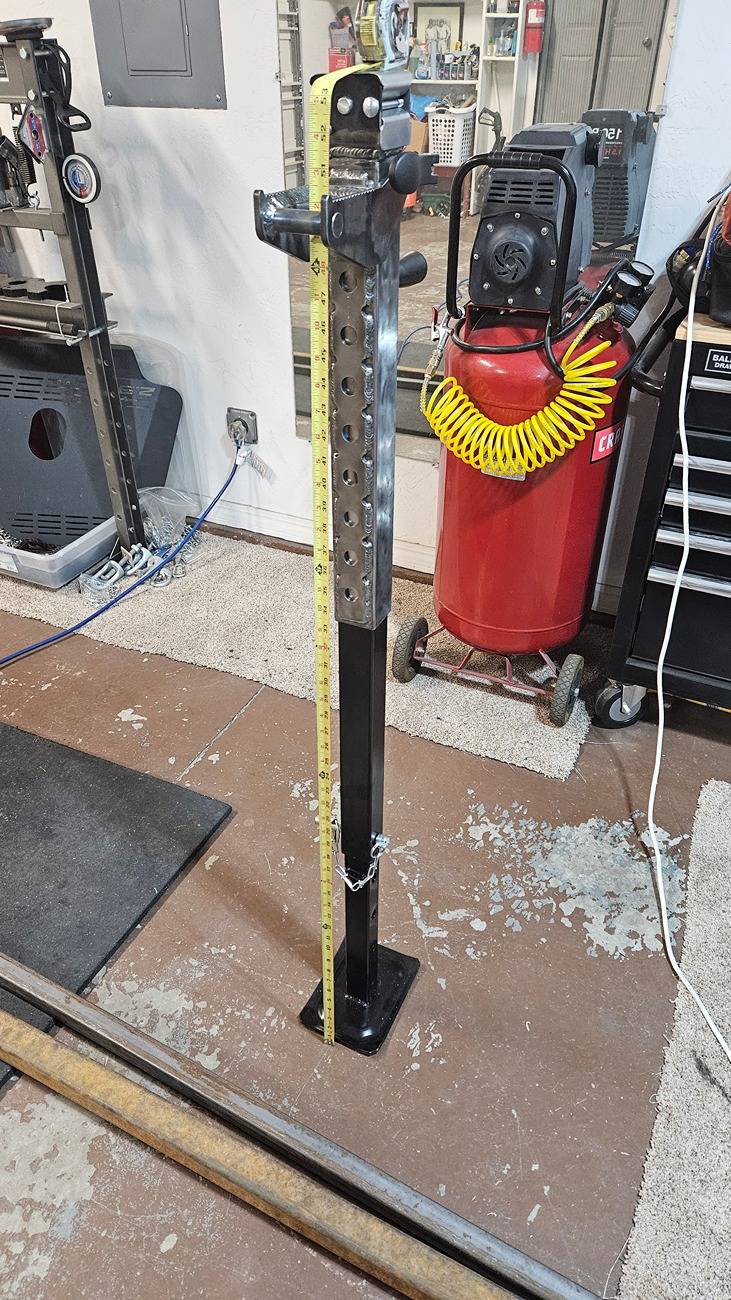

Highest lift height is right at 50 1/4". This is with the leg fully retracted.

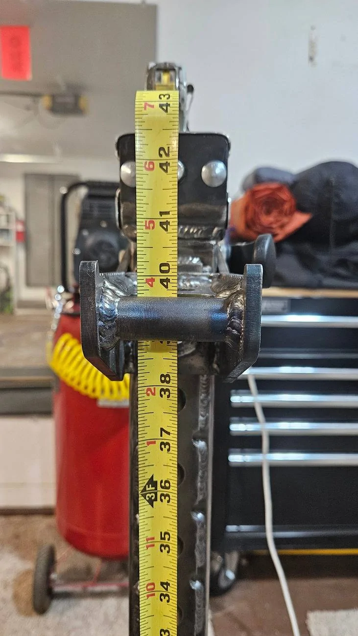

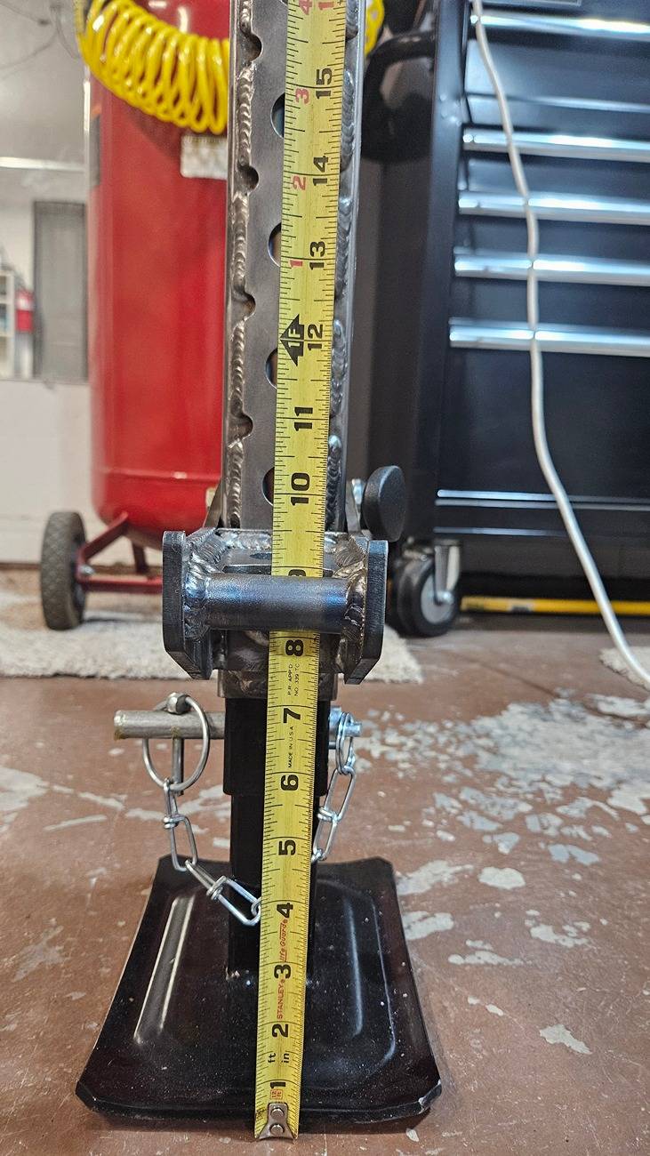

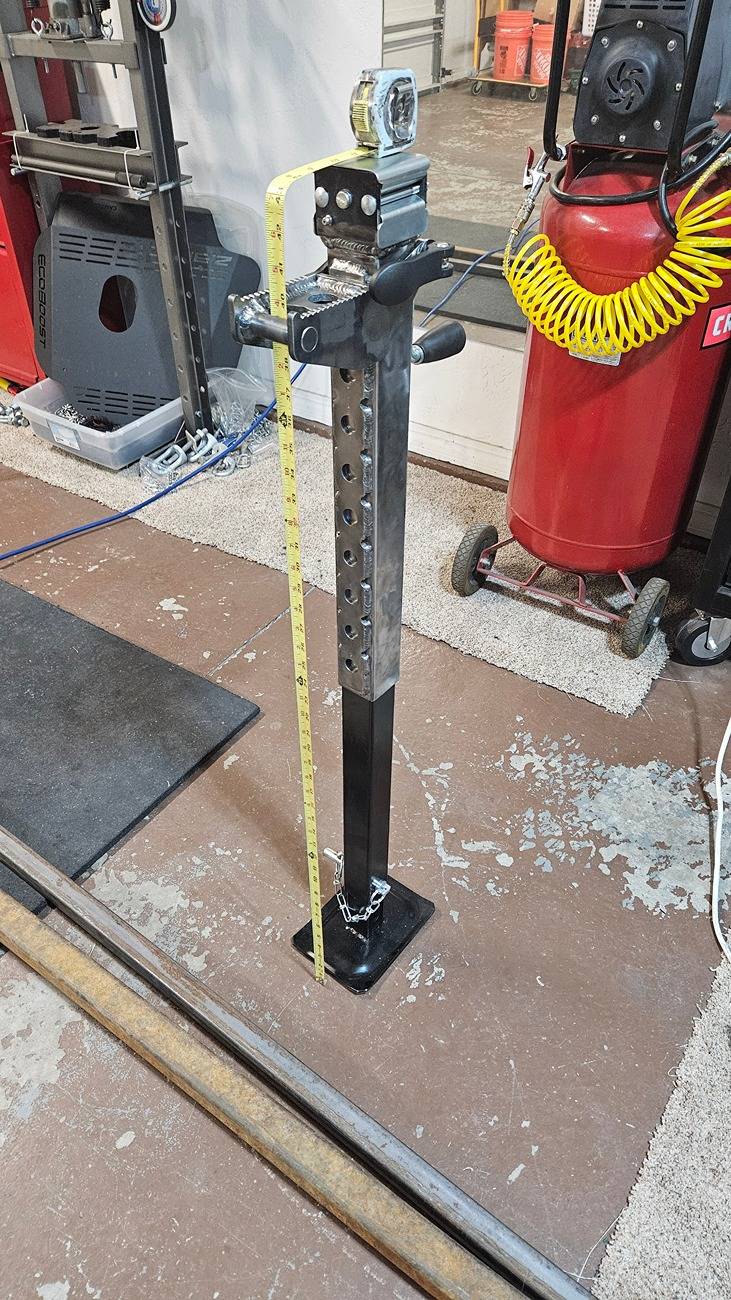

With the leg fully collapsed but jack at its highest it is at 40"

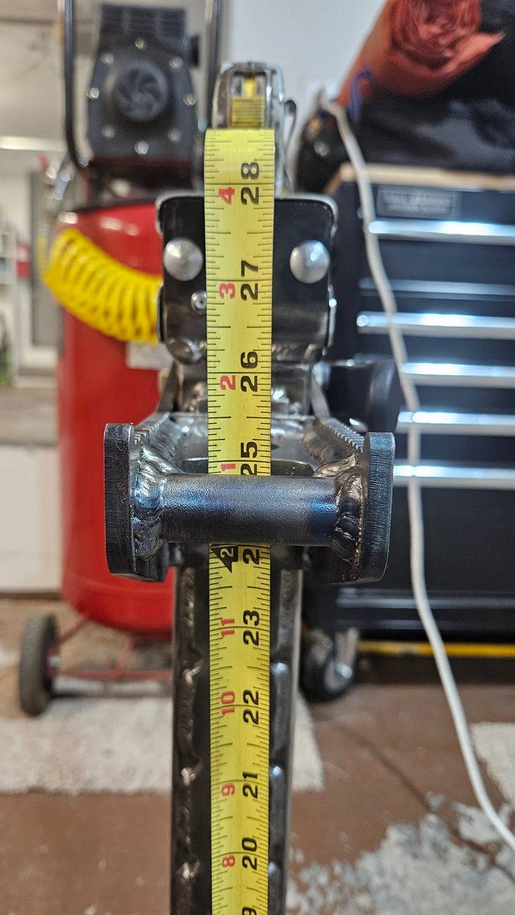

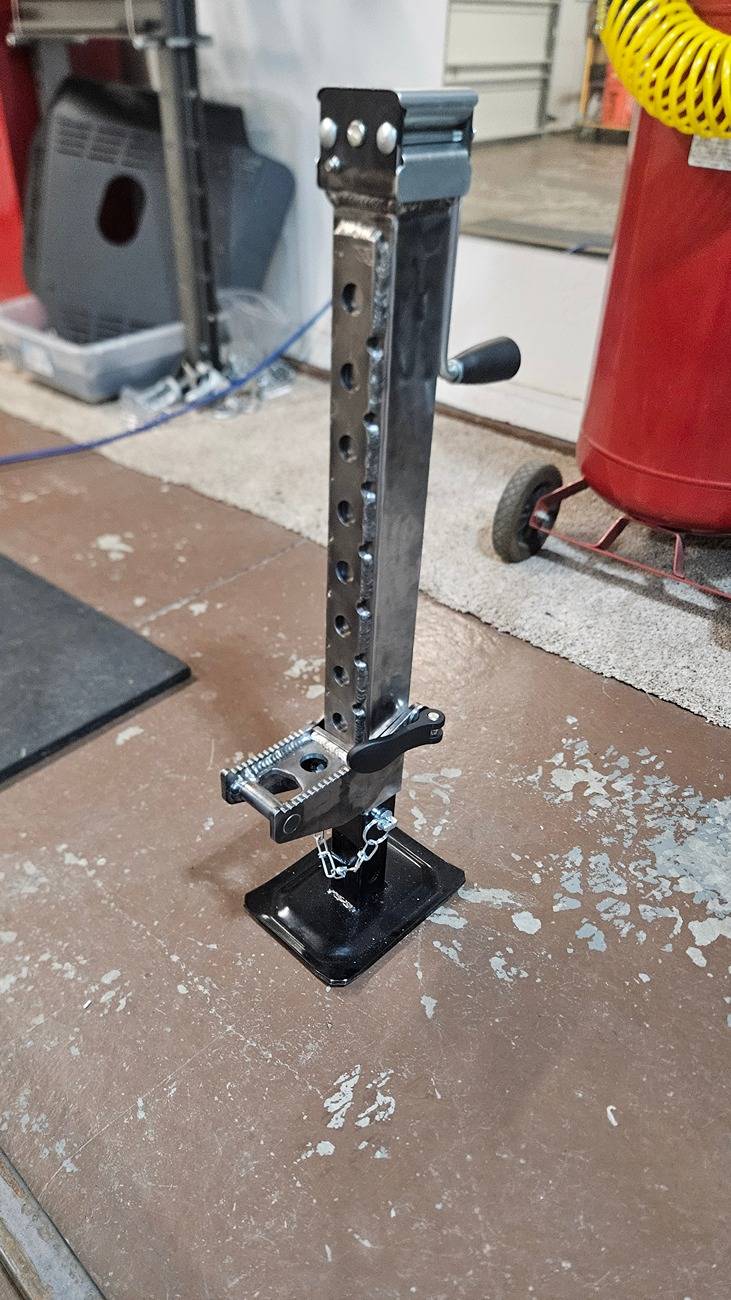

With jack all the way down and jack nose at top it is at 25 1/2"
Ford Bronco Tauler Jack 20241026_194130
Ford Bronco Tauler Jack 20241026_194119
And with the nose at it's lowest point the jack nose is at 9 1/2"

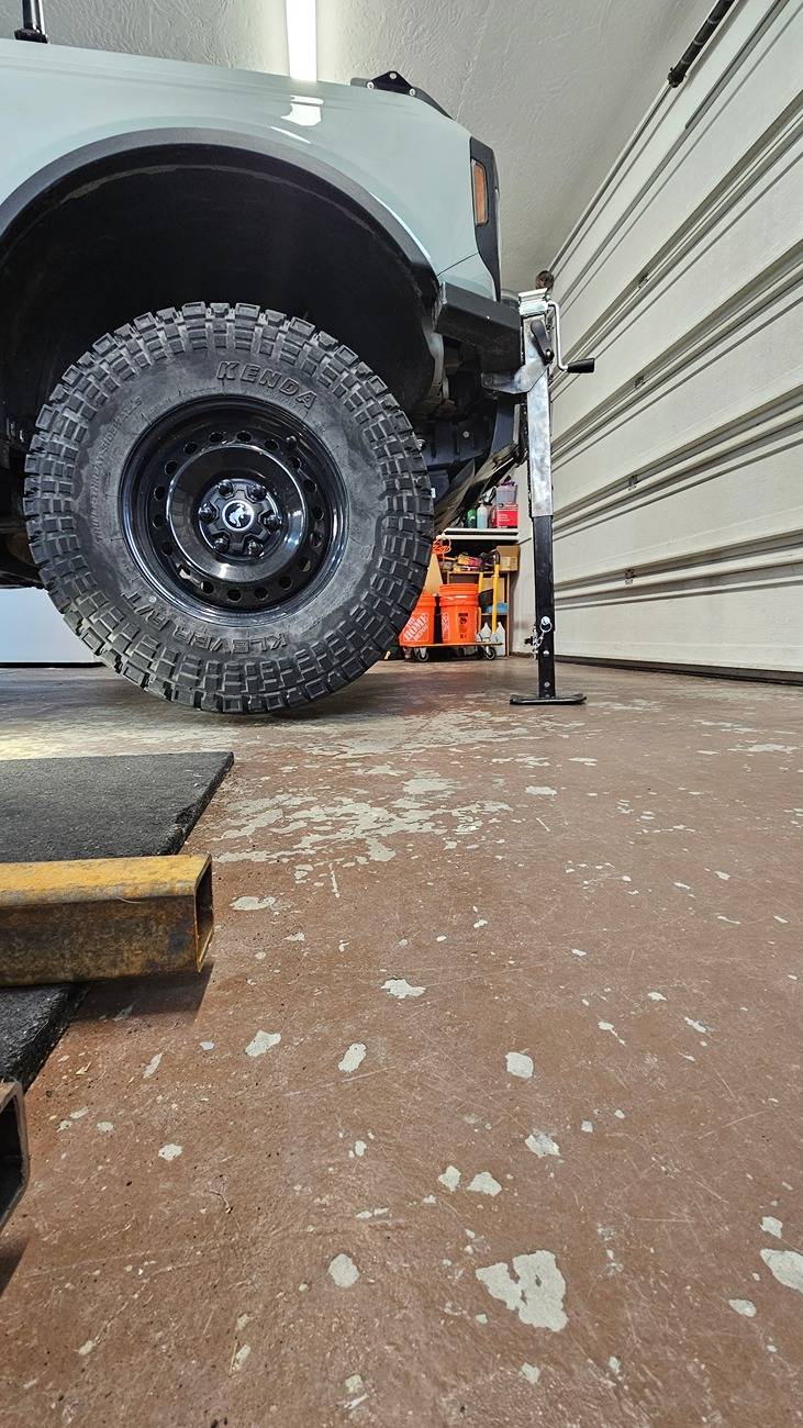

If anyone has questions I would first check out the video. Otherwise, ask away.
I'm going to test it tomorrow and will update with pictures of the Bronco lifted with the Tauler Jack.
