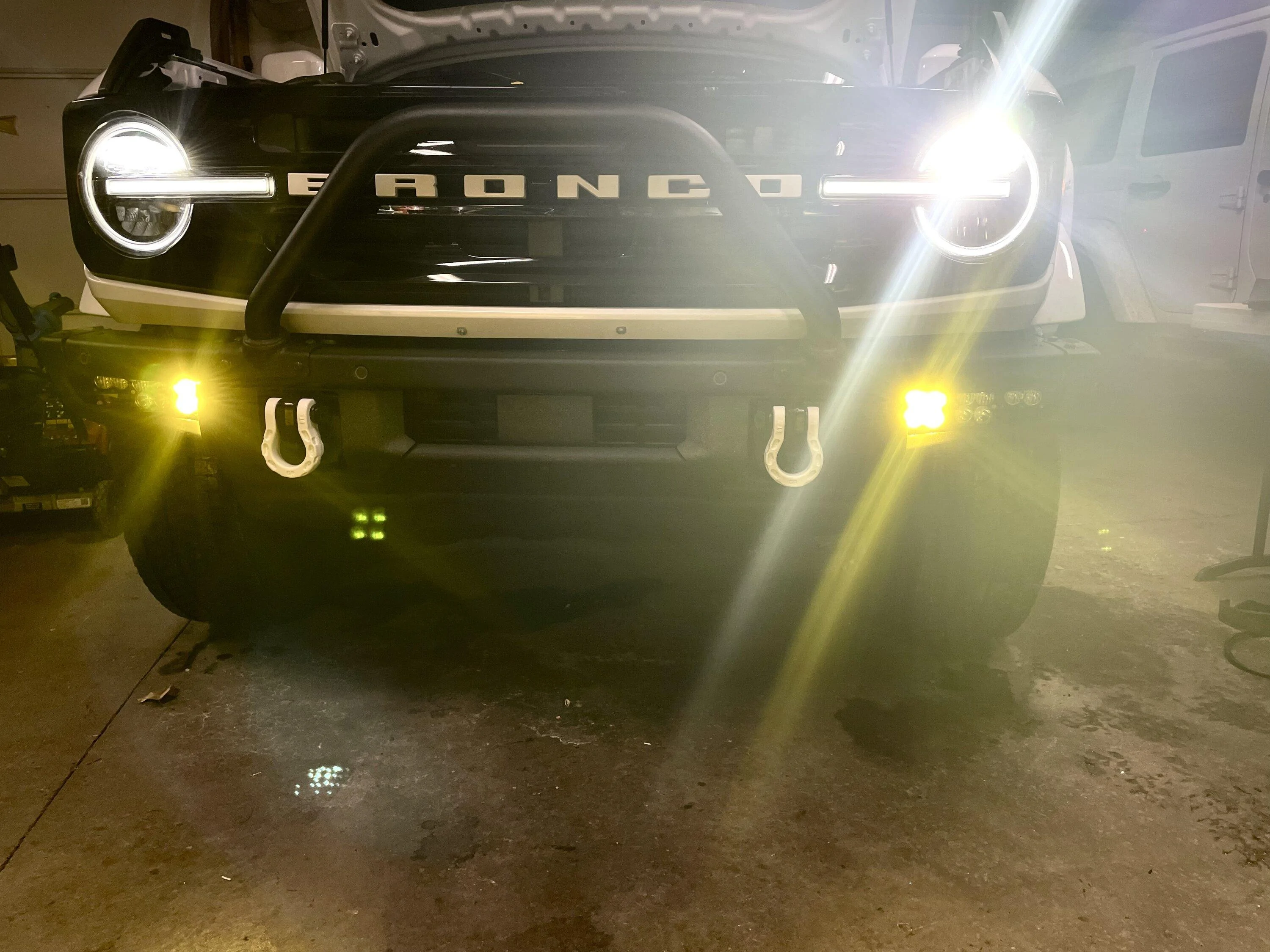

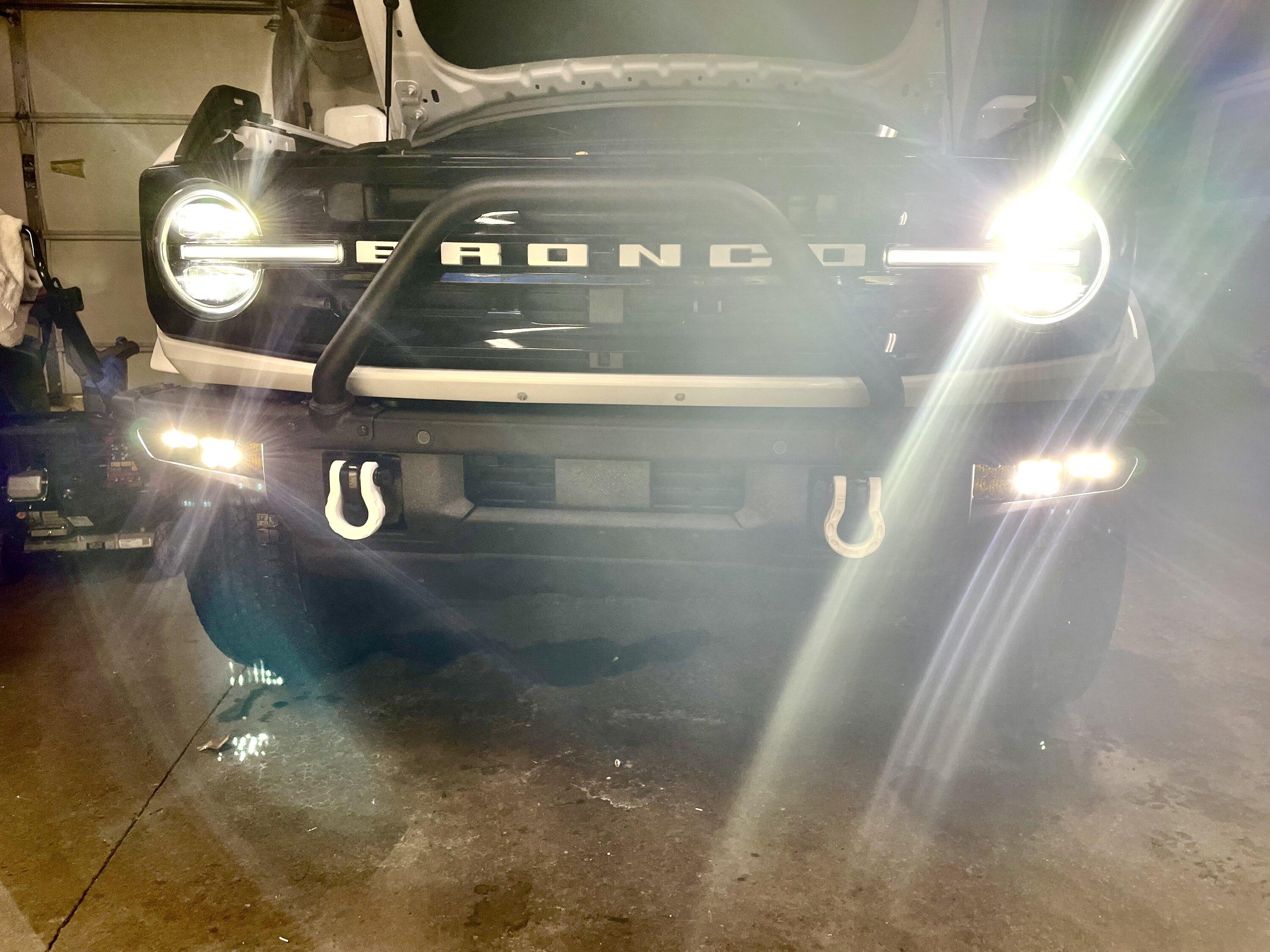

It is possible to run the lights through an aux switch and turn them on automatically when the high beams are on. When the aux switch is on.
I have this setup on my Bronco. It works great. I use it on remote county roads. On coming drivers never see them on. They auto turn off with the high beams.
I have the MOD bumper with factory fog light wiring. But no factory fog lights or switch. I replaced my headlight switch with a front fog light headlight switch. Made the appropriate Forscan changes to activate the switch and factory fog light wires.
I have the Baja Design driving lights and corner lights. Connected them to aux 1 & aux 2. Using a relay and the normally closed connection. Connect the fog light wire to the relay signal. When the fog lights are on (low beams), the lights are off. When the fog lights are off (high beams), the lights are on.
You can not use the high beam line bus wire to trigger the relay.
High beams on with Aux 1, Aux 2, & Aux 3 on
Ford Bronco tapping into high beam wire tempImagevv0dpf
High beams off with Aux 1, Aux 2, and Aux 3 on. I have Aux 3 wired to Baja Design fog lights. Aux 3 is wired to a normally open relay.
Ford Bronco tapping into high beam wire tempImageo44eL3

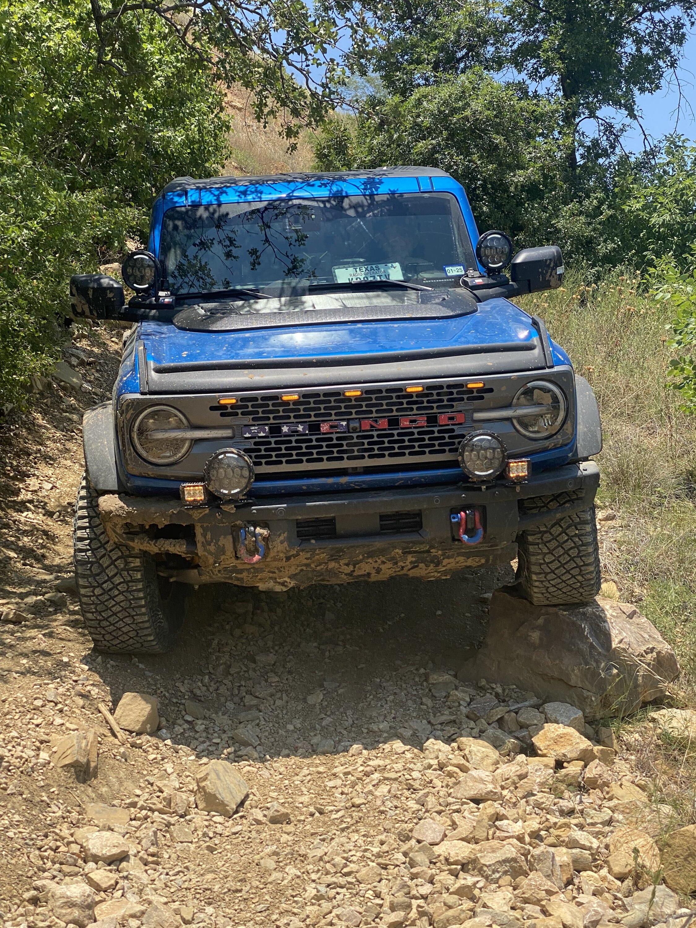

the lights on my front bumper the big rounds ones as well as the ones on my A piller. have a high and low beam function. I would like those high beam lights to go on and off when my high beams go on and off AND my aux 1 switch is on. (That way they don’t come on under normal situations like highway driving)

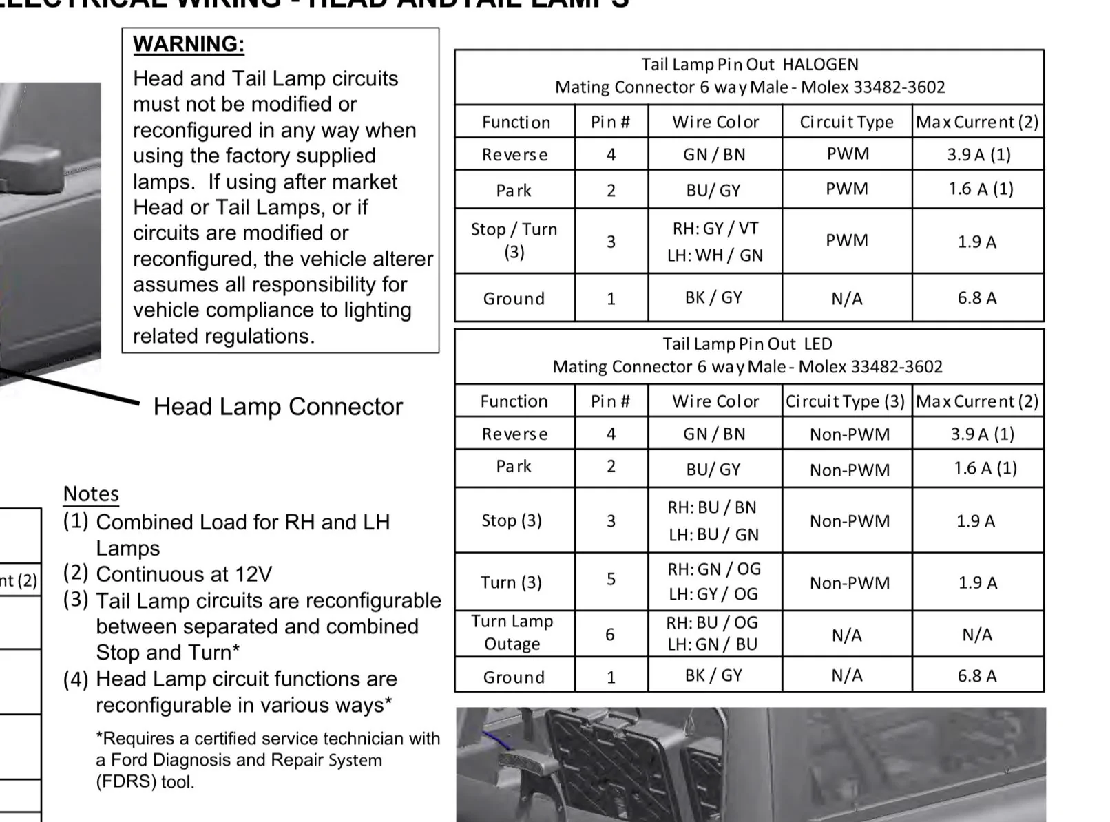

My thoughts and questions

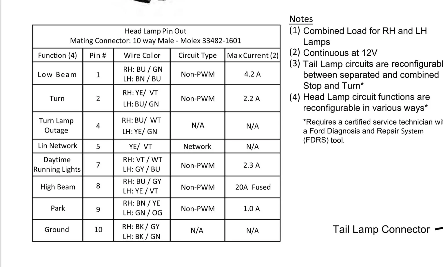

on page 24 of that manual. Listed by someone above…
it shows tail lights and head lights….
on the rear tail lights I got a dongle tap from sticker fab to isolate the reverse lights and to allow me to use some floods on my rear bumper to operate a relay to turn those floods on an off. The dongle taps into those reverse lights.
the dongle allows me to turn on those floods with either me putting vehicle in reverse or using an aux switch. I also use another aux switch so that they won’t come on when I go into reverse as well. I have the led Rear tail lights.
i also have tapped into the turn and parking signal lights with a dongle connection and it runs additional turn, brake and parking lights I have on the rear as well.
so now we move to the HEADLIGHt circuit up front….
i purchased Both the trail guide replacement with the built in DRL/Turn leds, as well as the fog light turn signals that go where fog lights go on the modular bumper that have the drl and sequential turn signal in them.i have NOT installed eithee. I bought them for the dongles.
the dongles for both are exactly the same and connect to the same connector.
the dongle taps into the headlight dongle and lets me use those wires to run additional DRL’s and turn signals…
the amber lights you see on the front of my bronco will blink, the white DRL’s stay on all the time.
all of those I have connected to. A mechanical relay except for the turn signals and I connected those to a solid state super fast relay.
i have not tryed it yet… but I don’t understand why we can’t tap into the low or high beam light line to operate other lights with a relay.
as noted with pin 1 (low) and pin 8 (High) Since pin 2 (turn) and pin 7 (drl) are currently being tapped?
I checked these with a meter. And they are getting constant 12v signal when on and no signal when off?
Those big round lights you see on my bumper and A piller have low and high beam function and currently are using 3 aux switch’s. aux 1 turns high beams on both, aux. 2 low beam bumper. Aux 3 low beam pillar.
what I want Is when I turn aux 1 on, for the high beams to turn on the high beam bumper/piller lights only when my hig beams are on AND the aux 1 switch is on.
Thoughts?

As noted above…. according the sheet. The high beam is on a 20amp fused circuit. But which one where.? It doesn’t say.

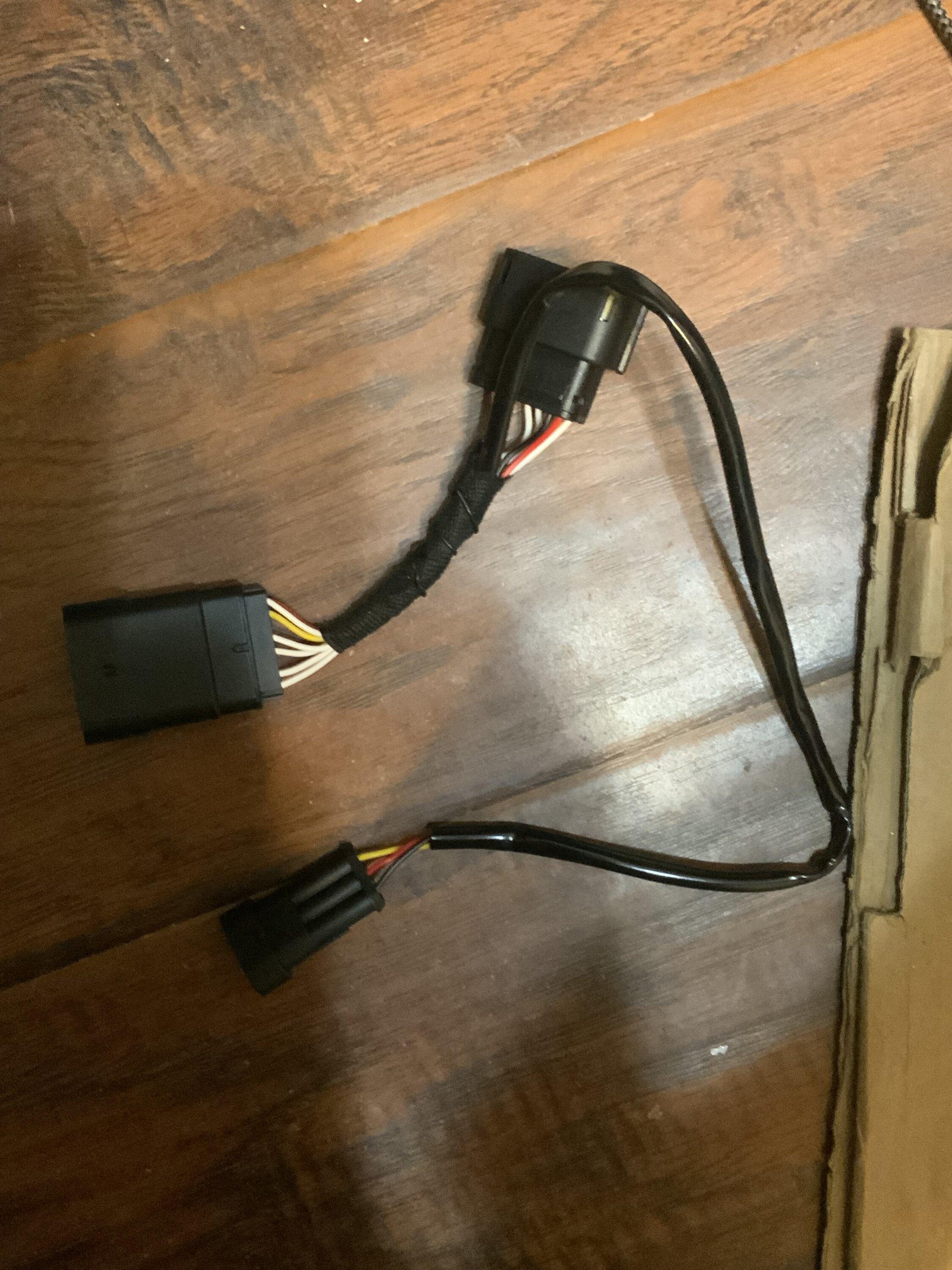

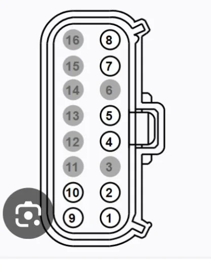

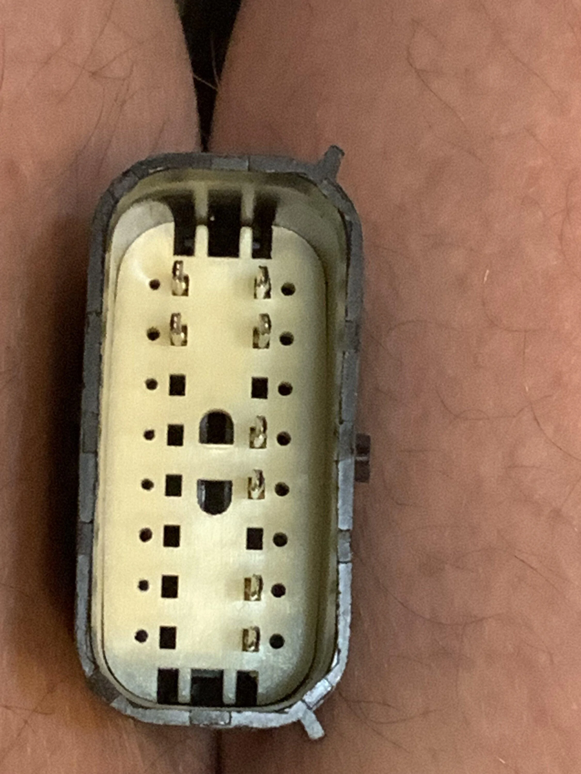

This is the dongle… any ideas which pins are what? As per diagram listed.?
At one point I saw @Mabett proposing a plug that would let you tap into the various light circuits without cutting. Not sure what happened to that.
https://customautoworksstore.com/product/bronco-headlight-adapter-for-2020-2023-with-led-headlights/
pic 1 I consider the male side
pic three of the pin out numbers are the female side
the tap is the red black and yellow wire.
black is ground
red is turn signal
and yellow is parking light.
you need two dongles, one for left one for right
on my other dongle I taped in to the DRL line and it works perfectly
i pug the pigtail of this dongle into a relay circuit
