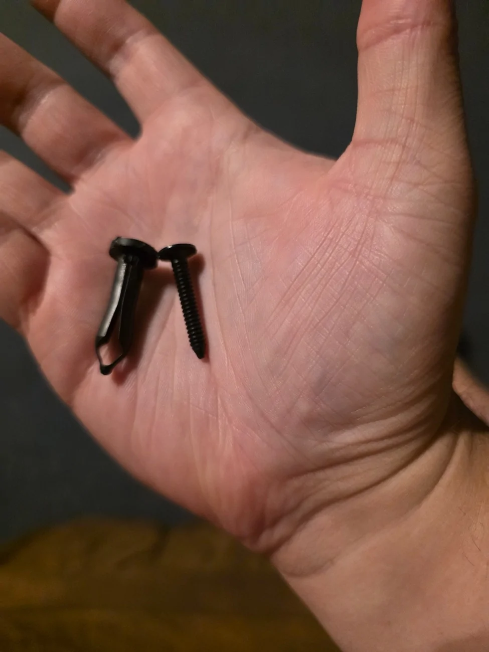

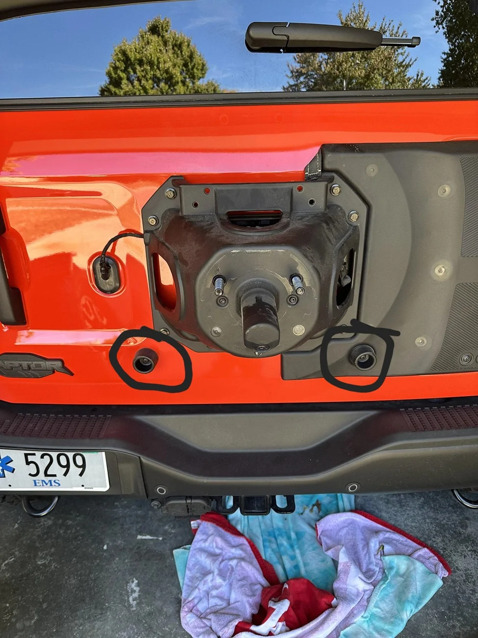

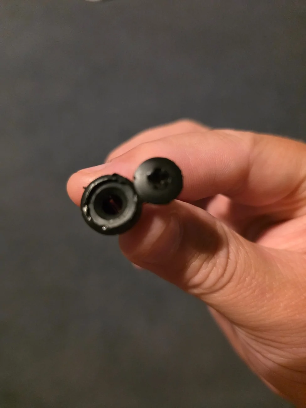

Does anyone know the part number for replacement screw style pushpins? I had to pry the screws out because they wouldn't engage to thread out. I cant seem to find them with online searching

Extra gold star if you know the part number for the rubber bumpers themselves as well one of mine is very deformed

As far a the bumpers, again, not official ford but cut to fit so fits most any tire/offset:
https://barnes4wd.com/products/bronco-spare-tire-extended-bumper
I used to have the Ford P/N for that, but if i recall it's different between SAS and non-SAS.
Those might be a bit less than OEM

Upon closer inspection these look like the fender pushpins which are much shorter then the bumper push pins by about a centimeter
I am looking for oem bumpers unfortunately.
I appreciate the help though
Ford doesn’t sell the push pins separately, you have to buy the whole rubber stopper.
M2DZ-1A401-B

I can stomach that
Thanks for the part this is exactly what I was looking for
Much appreciated Ducati
