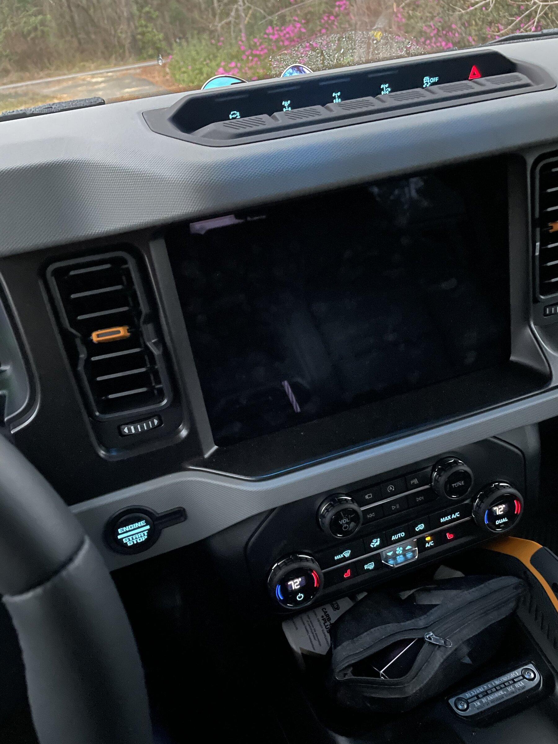

Getting a "audio off" message and Sync 4 screen is black on new FE. I tried to reset it by holding the power button and forward for 10 seconds or whatever but it will not reboot. Any ideas?

Turn off battery and it will reset the system.

Turn off, meaning disconnect battery?

Disconnected the negative side of the battery. Still not working. Any other ideas?

Someone else from Ford reached out about a week ago, created a case, but then stopped responding. The dealer can't get me an appointment, even though I've purchased two Broncos from that dealer. The vehicle is not safe to drive without cameras, etc. It's super frustrating that Ford stopped replying and that a new bronco with less than 300 miles is having these issues. I'm not sure what to do at this point.

No joke. Being told the APIM is on backorder and no one knows when it will arrive. Unreal.

My 12” screen is not working because my SYNC 4 APIM (Accessory Protocol Interface Module) is dead. Unfortunately, the part is backordered nationally, so a bunch of other owners besides me are awaiting this module. (Mine has been out for a month and a half.)
The reason I ask is because my vehicle history report listed a bunch of attempted OTA updates that were all unsuccessful right about the time that my 12” screen went out. I suspect one of the failed OTA updates bricked the APIM, but I don’t know for sure.
