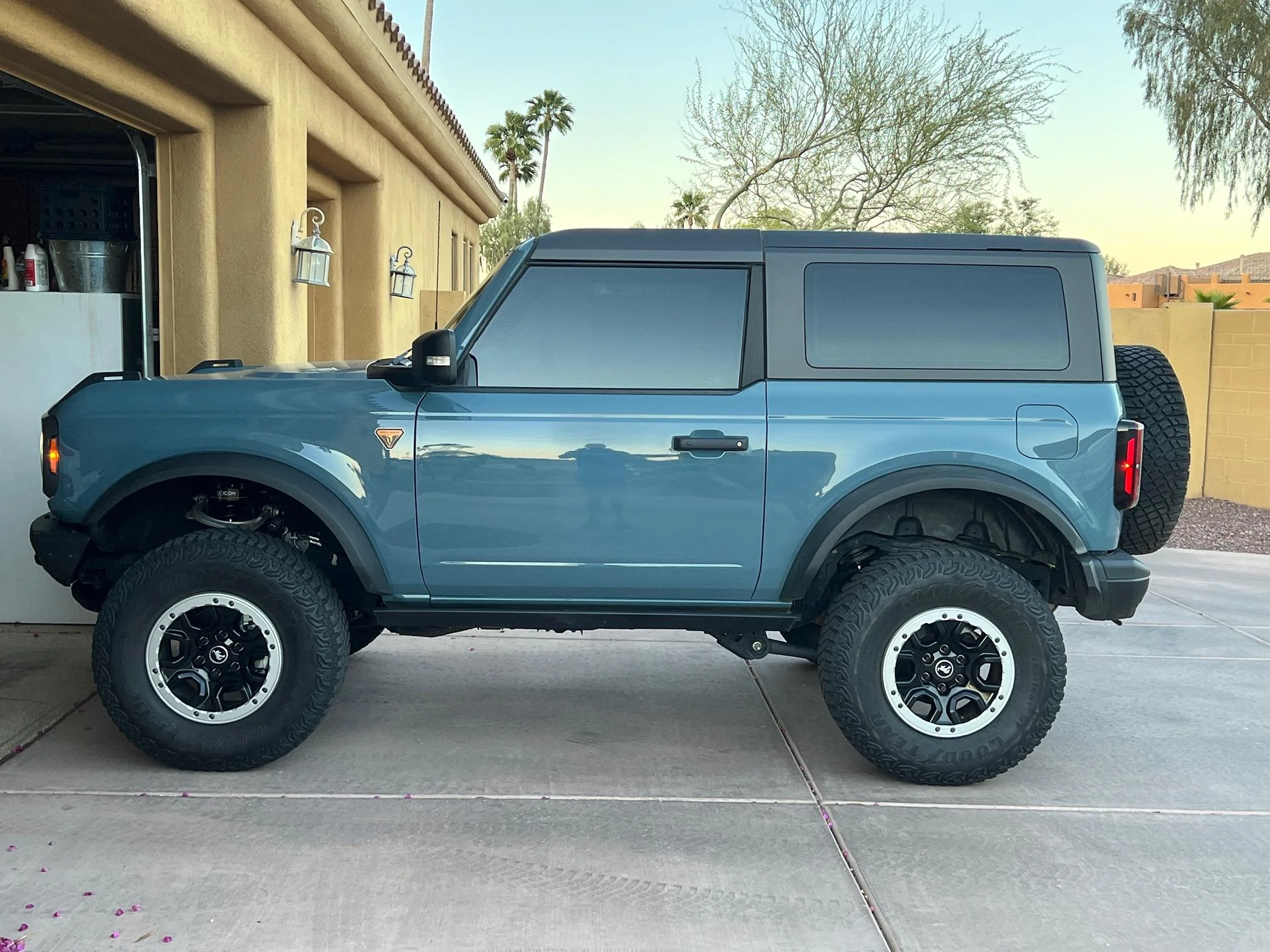

I'm wondering if they managed to rotate the sway bar disconnect motor mount, I think it's possible if you force it. Need to see some pics of the sway bar setup. Also, what Hoss (1 vs 2) and groove are you on? I have Icon CDEVs and installed the drop brackets for the sway bar, even without the drop I wouldn't expect that to impact my ride height very much.
I’m on groove 5…so without sway bar connected it is spot on. I was also thinking about sway bar motor being rotated. The brackets are removed to allow lower arm removal.

So did you figure it out?

Ford Bronco Sway Bar holding up front end IMG_1845
Yes it ended up being alignment was way out. Front end lifted up going forward and lowered in reverse. Once I finished rears and got alignment it looked sharp.
