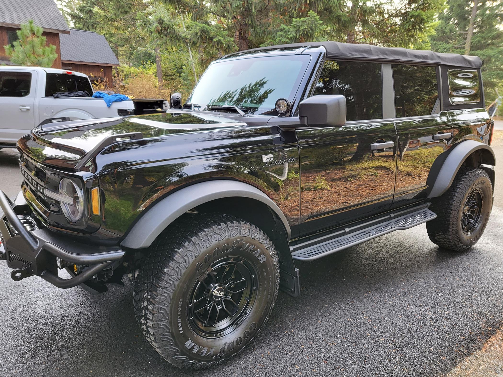

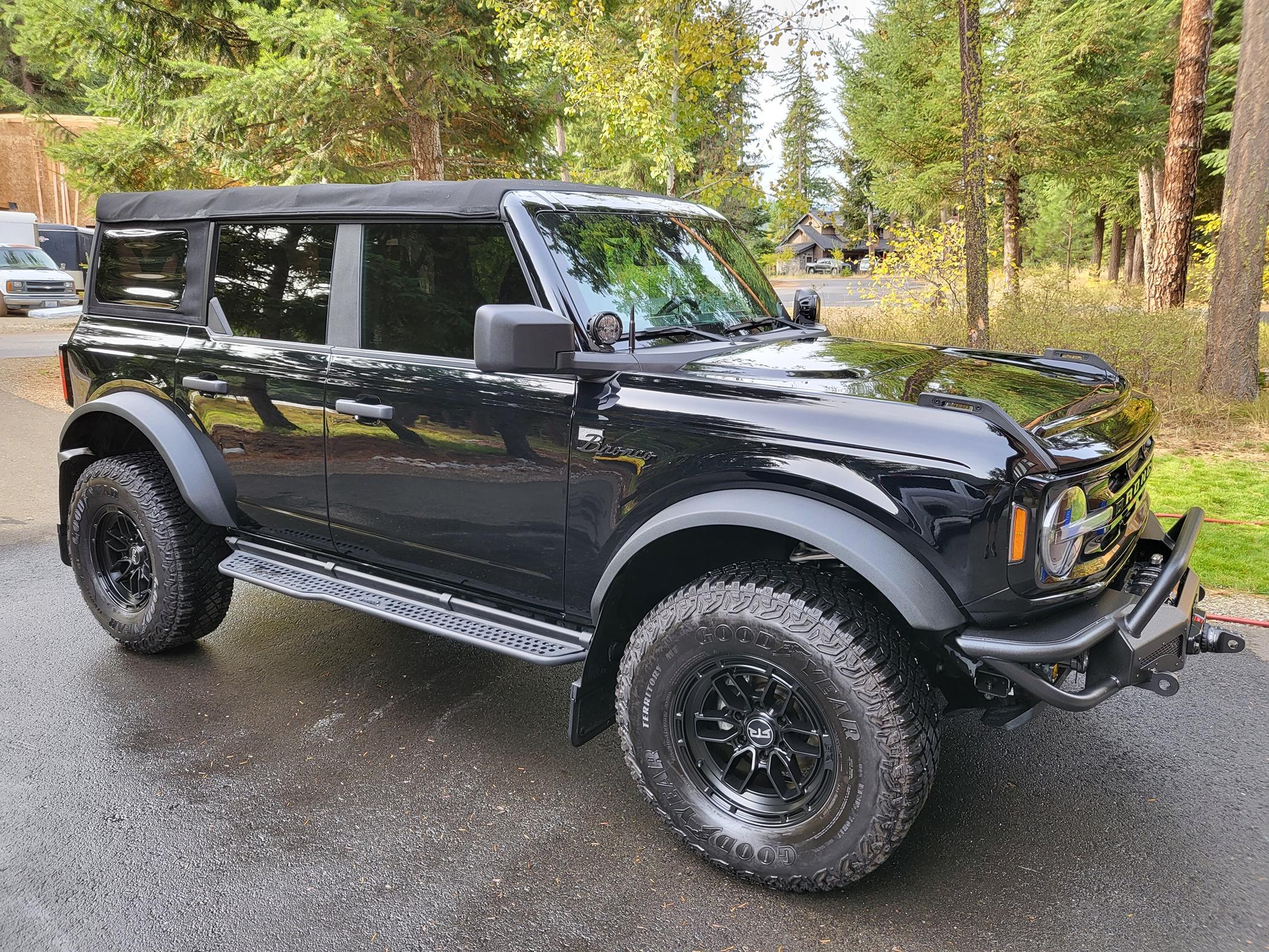

Can you post pics of your 6100 setup? How do you like it btw? :)
I really like the 6100s. I think they are quite a bit better than stock SAS. Pretty tough to beat for the price and they are built to last. Might upgrade in future to 8100s if they ever come out. But only spent $800 on all 4 6100s so low cost for lifted, leveled improved ride. Sorry need to take some better pics.
Ford Bronco Suspension Thoughts for a Basesquatch 20231014_110248
Ford Bronco Suspension Thoughts for a Basesquatch 20231014_110229
