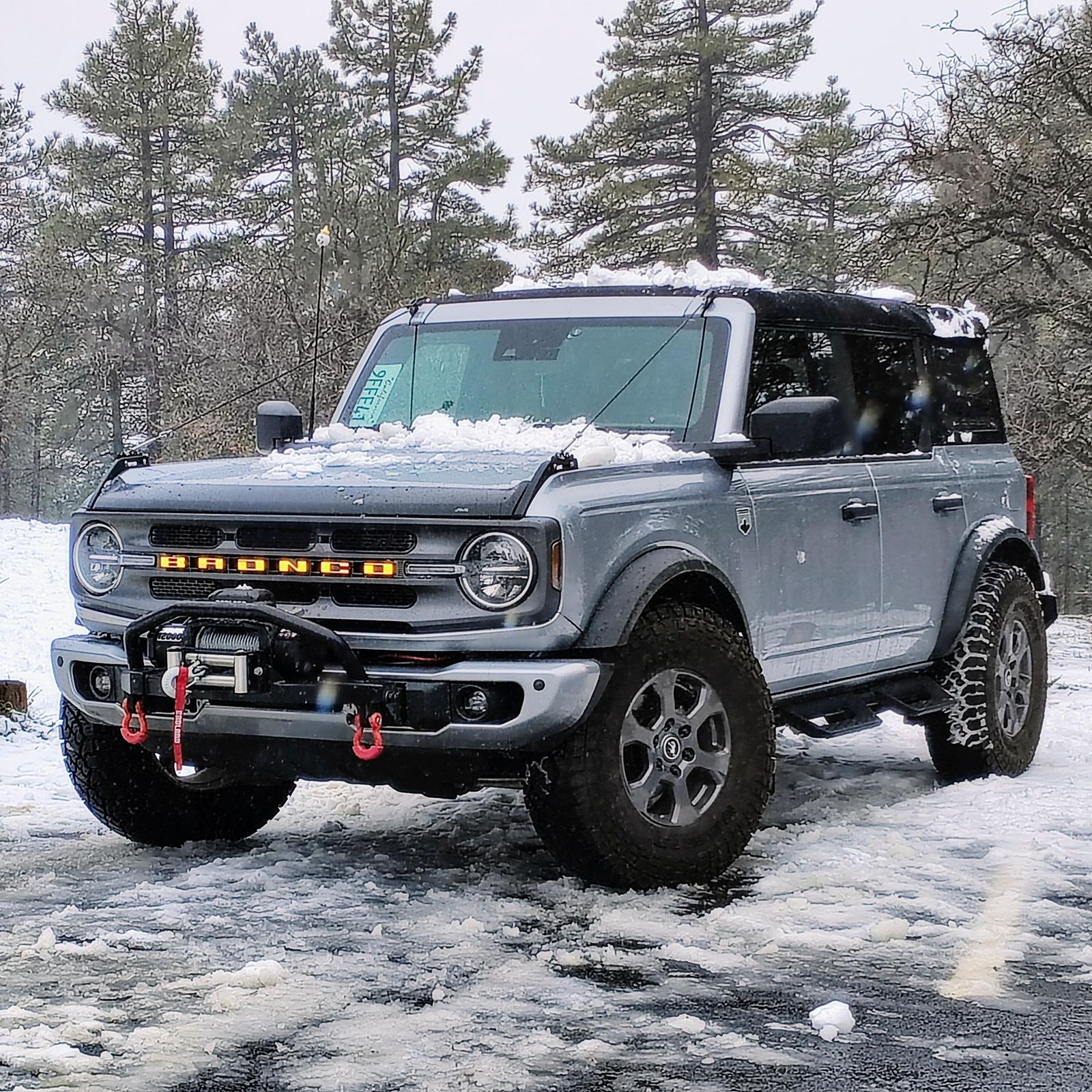

I purchased the superlift's 3.5" lift kit. Part #K1023. After some talk with the mechanic about my planned sedona trip (broken arrow). He advised to just go 2" lift with Bilstein 5100's and over the 3.5"spacer i agreed.
Im about to return the superlift's but figured i would ask here first. Would there be any benefit in combining the kits? Since im only going 2" high. The UCA,drivetrain and track bar brackets are tempting to install. I am aiming for max articulation over height If that helps.
RIg is a Big bend. On 35x10.5's The only option it came with was the 2.7.
