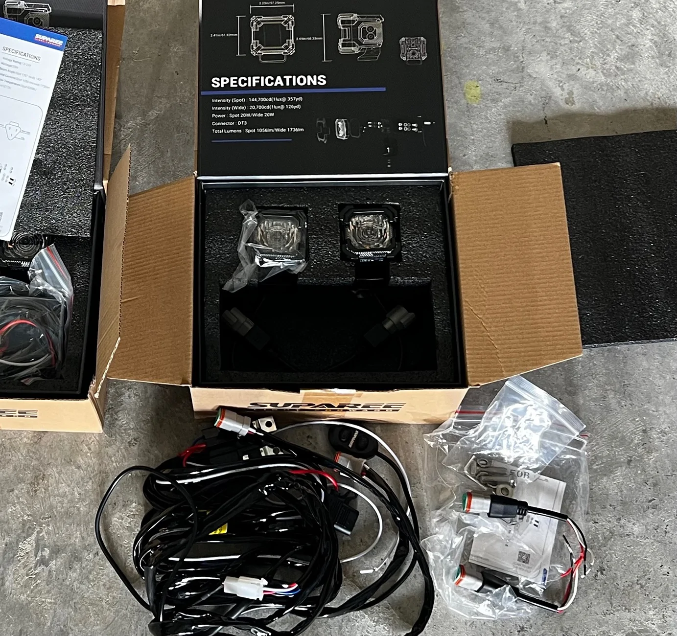

I received the 2 sets of Recon 1 lights by Suparee from a promo giveaway here on 6G.
Ford Bronco Suparee pod lights review. IMG_2408
They are small pods rated at 20 watts. They measure at 2” square with 1.5” lens size.
I did not realize I was getting 2 sets, a spot and a flood. Nice surprise when I opened the box. Thanks Suparee.
They come with covers also for those states that need them.
Nice looking housings, the powder-coat looks great.
All Stainless hardware throughout.
Mounting bolts are round head which I like as they don’t require 2 wrench’s to tighten.
Two extra pigtail plugs if you want to wire yourself.
Package is very nice with magnetic closure if you’re into that sort of thing. I just toss it in the trash so not big on fancy packaging myself.

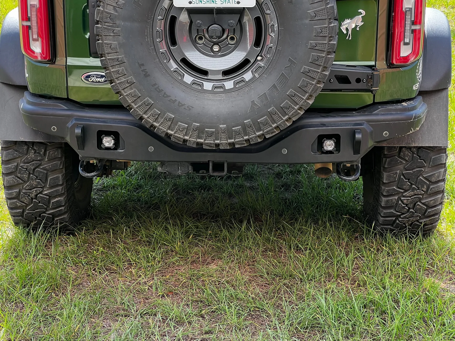

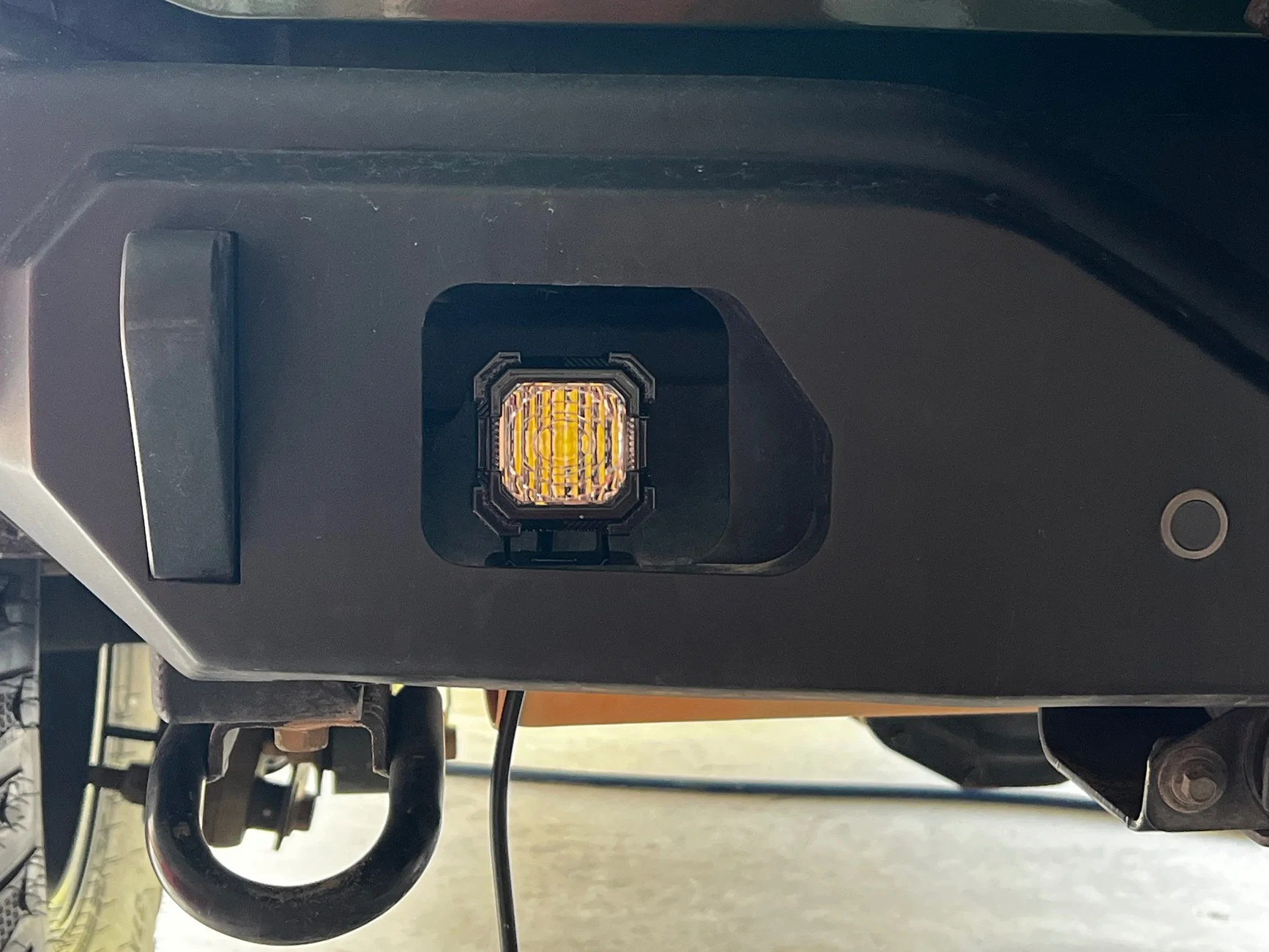

I setup the 2 spots on my driver side cowl for ditch use. The fogs went in my rear bumper. These should be perfect for backup lights as they are not super bright, that sucks for everyone else in the parking lot when you kick on 4000+ lumen backup lights.

I made my own harness with the provided plug ends so I could eliminate the relays and wires for a cleaner install, with the Broncos aux switch’s it’s silly not to since the relays and fuse are built in.
The prewired plug ends are great and another plus is you can save the unused harness for other projects.
Everything works as they should, I bypassed the DRL since I do not use them but I tested them and they worked fine and were amber in color.

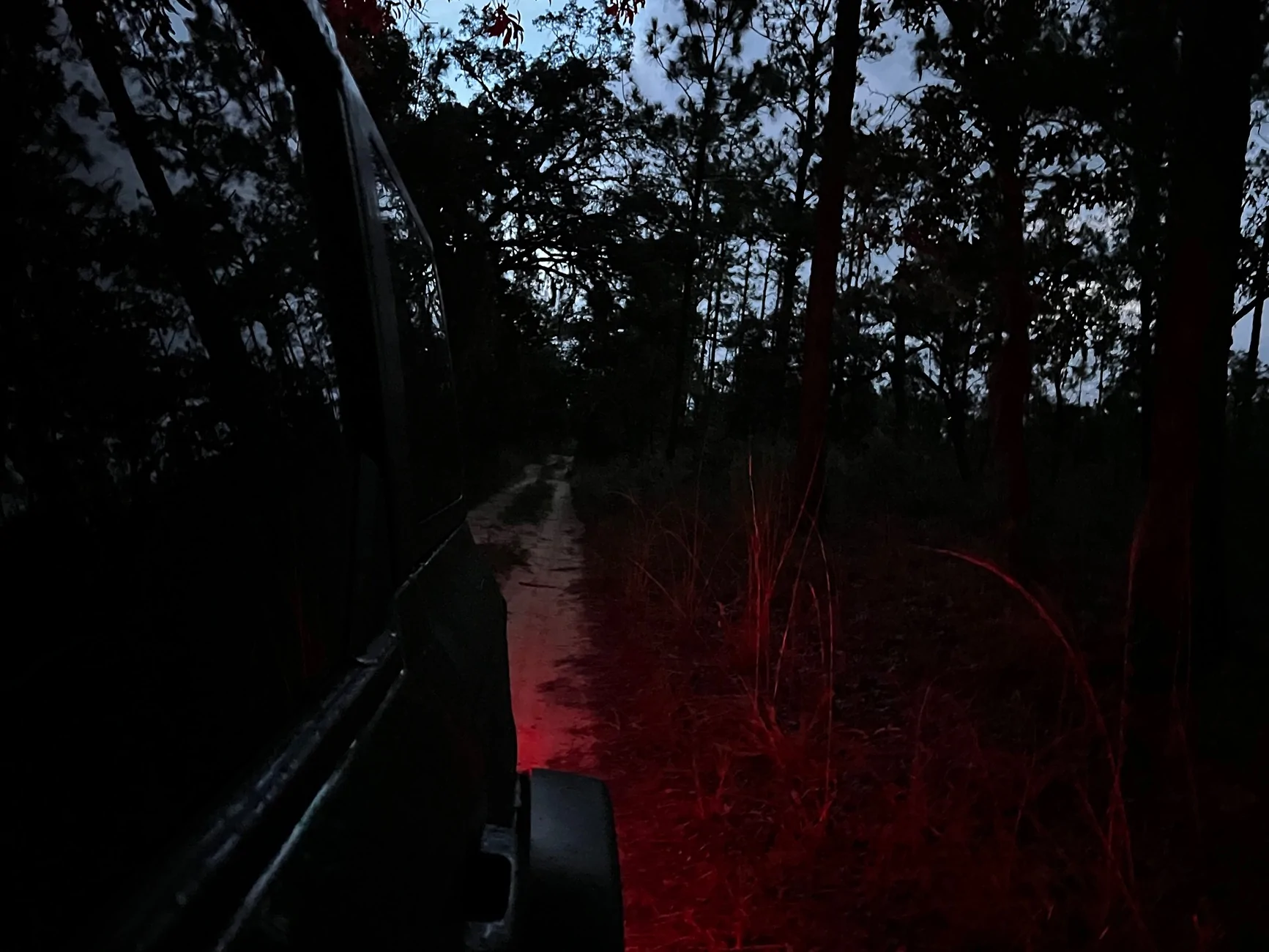

Got out tonight for a quick ride, few first pics after dark.
The fog pods on the rear bumper are great.
With and without the rear pods on.
Ford Bronco Suparee pod lights review. IMG_2456
Ford Bronco Suparee pod lights review. IMG_2457

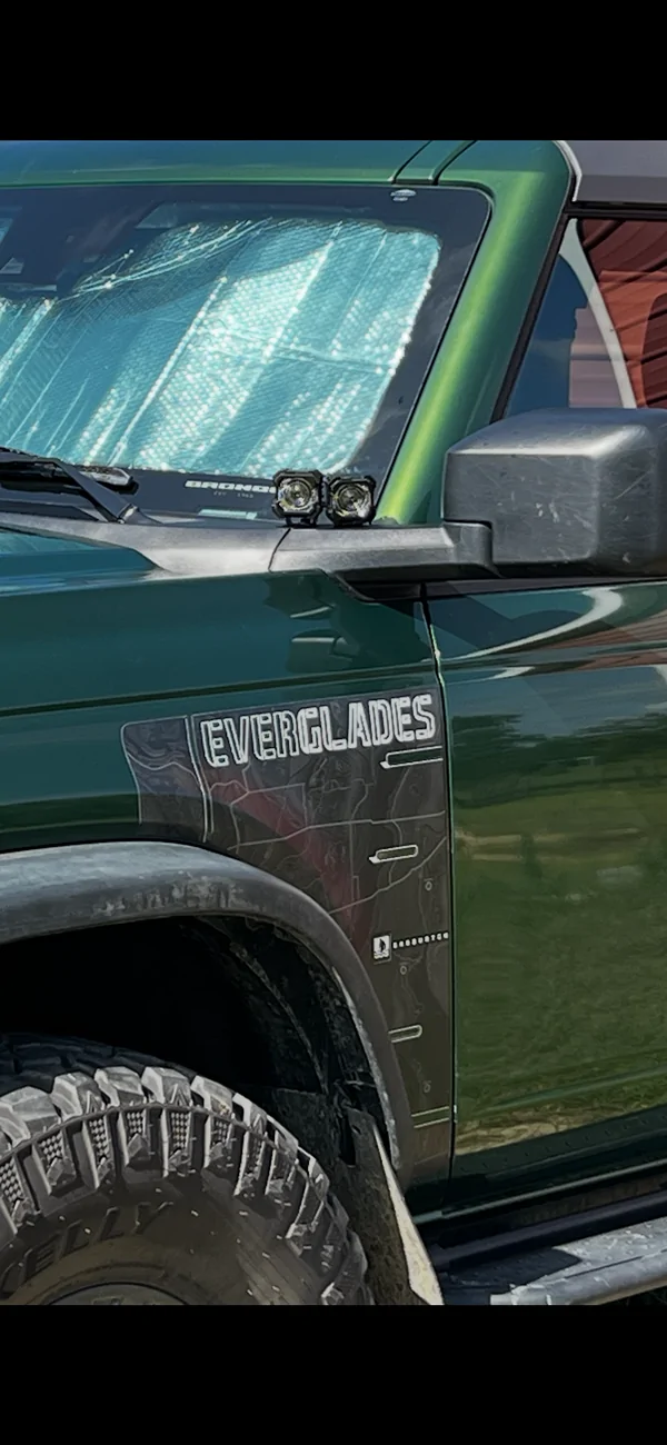

Next the 2 spot pods on my drivers vowel, they can be adjusted better but do the job.
Hit a bunch of mud holes so tomorrow I’ll hose it all down, I expect no water in the lights but we shall see.
Ford Bronco Suparee pod lights review. IMG_2461
Ford Bronco Suparee pod lights review. IMG_2462

The front are the spots and I’ll say they are too weak for cowl spot use. They might do better in the front bumper so I’ll be moving them to that area and see how they do.
