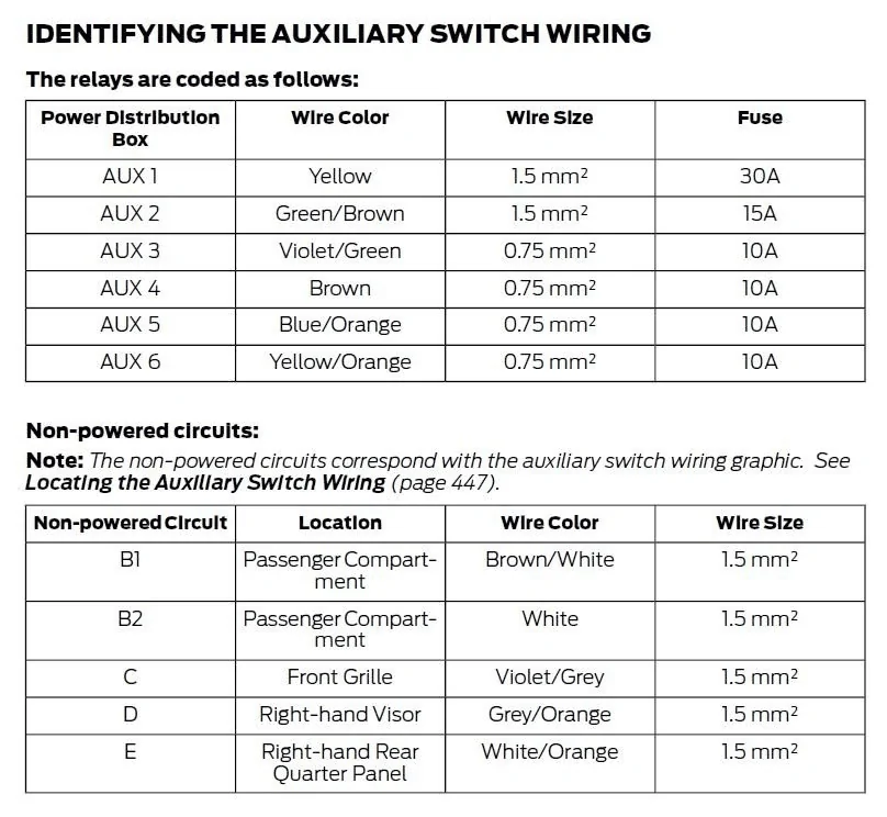

Aux 1 is 30A, Aux 2 is 15A (could be upgraded to 30A). AUX 3-6 are 10A. The switch needs to be rated at least as large as the fuse on the amp.

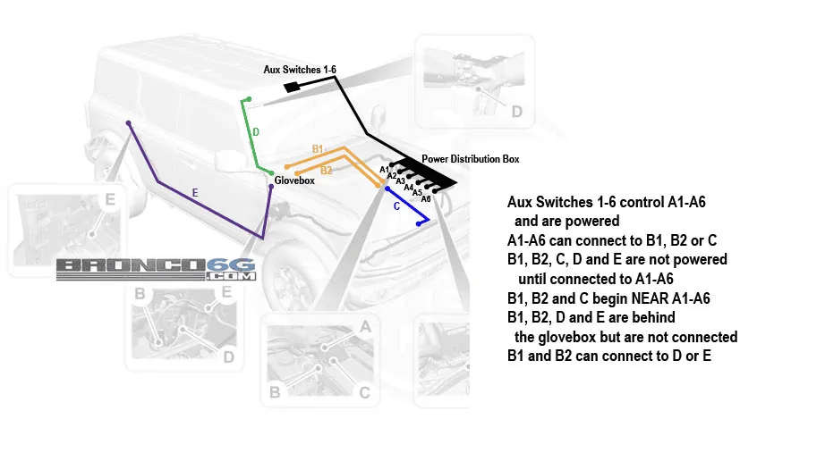

That said, the upfitter switch distribution box is up ahead of the firewall, and if you are going through the firewall, you may as well just go straight to the battery with a fuse like a typical amp would anyway.
There are a few pre-installed wires that you could use, but you are going to have to re-route to your amp under the seat anyway, and they have amp restrictions as well - they are only really meant to carry 10A.

Most fuses have some way to change them if they blow, and Aux1 and Aux2 both use the same wire size per the chart I linked.
